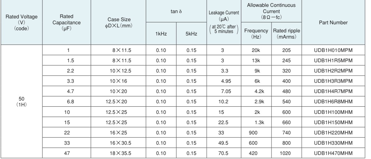

I’m using Nichicon UDB series at the moment for crossover networks. They have excellent ripple current capability compared to other types of electrolytic.
Luckily, this is not one of the series being dropped by Nichicon in their recent end of life announcement.
Are there any other current production capacitors specifically for speaker networks? I’m not sure what I would use if they stopped making this.

I don’t want to buy some random capacitor from a re-seller, I want a proper well tested product with a data sheet, from a known manufacture.
I’ve checked other manufactures and could not find anything specifically designed for speaker networks, low ESR at low frequency, high ripple, reasonable voltage ~50V at least.
So thought I’d see what others are doing.

Thanks for the great effort. I always see outliers in these searches too. I’ve been using the same tools and Octopart is also quite good. So it really does seem Nichicon UDB is the only one specifically targeted at speaker networks from the major manufacturers.
What’s the sensible ripple current in a cross over capacitor? I measured the ESR of a 22uF at 100Hz is was approx. 1.5 Ohms.I would certainly expect a non-polarized audio cap to have a DC rating. As was mentioned before, crossovers don't get very warm.
Well a 22uf cap has an reactance of 72.3 ohms at 100 Hz. It would take 72V AC across it to cause a current of 1A to flow.
That would be a very high powered speaker indeed as this is just one component in the crossover.
I have never considered ripple current an issue in crossover designs however some professional sound reinforcement applications might require a second look.
If there is a cap that must pass high current you could improve the situation by paralleling smaller caps so that current is shared.

Actually its often relevant for large electrolytics in audio due to the high currents and the I-squared dependency, lower ESR/higher ripple means less self-heating or loss and longer life or higher power handling. For 2 way speakers the electrolytic only carries tweeter current though, not so bad, but 3-way crossovers may be more demanding.I have never considered ripple current an issue in crossover designs however some professional sound reinforcement applications might require a second look.
I do understand that but unless your are crossing a mid woof or woofer to a sub pretty low I’d have not considered it critical. There are always corner cases though.
For the low pass section the caps are in shunt and likely after a series coil so that case would not have significant LF current.
This can all be sorted in LTSPICE though.
