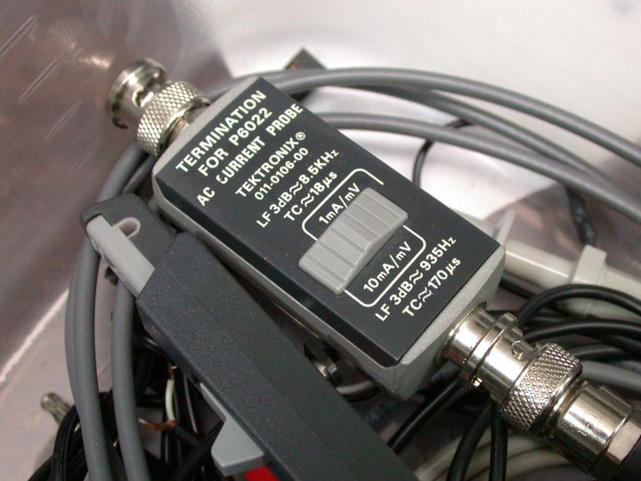

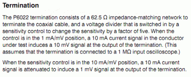

The terminator is more than a 50 ohm resistor. I honestly don't know how well it'll work with only a 50 ohm. Took me a while to find a good one on eBay. I paid about $300+, probe + terminator.
An alternative is to use the Tektronix 134 Current Probe Amplifier instead of the Passive Terminator. I think they are more common on eBay and cheaper too.

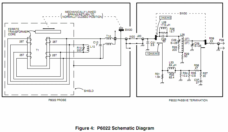

That Tek terminator just appears to be an equalizer for high frequencies. The pickup should work without all that. Years ago a friend used to take the convergence yokes off of the older color tv set sets (the ones with RGB dot trio phosphor) and use the three U-shaped ferrite assemblies with coils on that as current transformers. I'm not sure what kind of bar he used to close the top with once the conductor was inside. I think it was scribed snapped and sanded off pieces of old AM radio ferrite bars, and ferrite from tv/monitor flyback transformers. Scraps out of older PC switching supplies may work too. Besides ferrite in other transformers, some also have a small current transformer for over-current detection. What he was doing was all low frequency though. The frequency range needed is a big factor in cost and size. There has been some talk in one of the curve tracer threads about current sensing of plate and grid currents (to points generally at high voltage with respect to ground). Not much bandwidth is needed, but it should work to D.C. and it is best to be fully isolated and not to load the circuit with much capacitance.

I was just reading the Tektronix P6022 manual -- and the "duhhhh?" moment occurred -- you can increase the "implied" current into the probe by increasing the number of turns -- if you loop the wire twice instead of 10mA/V the scale is now 5mA/V.
P6022 is flat from 10kHz to 100MHz, but the chart in the manual indicates that the sensitivity decreases linearly from 10kHz to 100Hz in the 10mA range (and 1kHz in the 1mA range), so you could create a calibration curve to compensate for the falloff.
