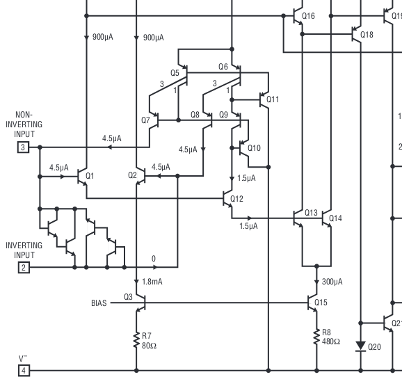

In the image in #1 explaining the way how to achieve IBC, I used two independent PNP transistors, however I found that Scott mentioned in an earlier tread that this is likely to be a multi collector PNP.
To be honest, I have no idea how this translates into noise, but my assumptions are only to be seen as an attempt to understand things better.

By the way, as there are annotated currents in the schematic diagram in the LT1028 datasheet, you can simply calculate the shot noise densities sqrt(2 q I):
Base current shot noise of Q1 plus collector shot noise of Q7:
sqrt(2*2*q*4.5 uA) ~= 1.6982 pA/sqrt(Hz) with q ~= 1.6022E-19 C
This is the uncorrelated shot noise current. The differential current is sqrt(2) times less, so 1.2008 pA/sqrt(Hz) - already a bit higher than the specified 1 pA/sqrt(Hz), while second-order effects are not included at all.
Base current shot noise of Q13+Q14 plus collector shot noise of Q9:
sqrt(2*2*q*1.5 uA) ~= 0.98047 pA/sqrt(Hz)
This current gets amplified three times by the PNP mirror and is then injected into each input. Hence, this leads to a fully correlated noise current component with spectral density:
3*sqrt(2*2*q*1.5 uA) ~= 2.9414 pA/sqrt(Hz)
Total noise current per input:
sqrt((1.6982 pA/sqrt(Hz))^2 + (2.9414 pA/sqrt(Hz))) ~= 3.3964 pA/sqrt(Hz)
which is slightly higher than the 3.25 pA/sqrt(Hz) I got from a datasheet plot, even though second-order effects are not included.
Even though the dot is missing, I assume the emitters of Q1 and Q2 are connected.

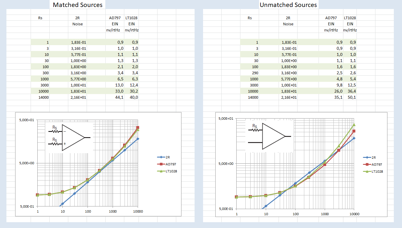

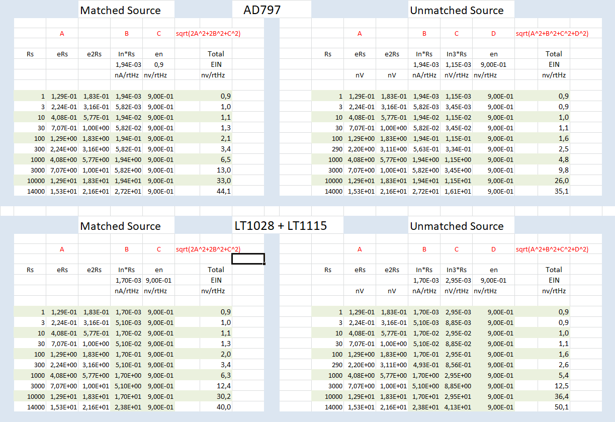

I finished doing the measurements as planned.
I had five pcs of LT1028, three LT1115 and four AD797.
Since all measurement where very close per type, I took their average and came to the following figures:
Voltage noise @1kHz
AD797 0.9nV/rtHz (0.9nV/rtHz spec)
LT1028 0.9nV/rtHz (0.9nV/rtHz spec)
LT1115 0.9nV/rtHz (0.9nV/rtHz spec)
Current noise Matched Resistors @1kHz
AD797 1.9pA/rt/Hz (2.0pA/rtHz spec)
LT1028 1.7pA/rtHz (1.0pA/rtHz spec)
LT1115 1.7pA/rtHz (1.2pA/rtHz spec)
Current noise Unmatched Resistors @1kHz
AD797 2.2pA/rtHz
LT1028 3.4pA/rtHz
LT1115 3.4pA/rtHz
As can be seen, I could not measure any difference in the voltage noise of the three contenders and they all performed exactly as their typical spec value.
There was also absolutely no measurable noise difference between the LT1028 and the LT1115 although the current noise of the LT1115 is 20% higher in the specs.
Quite unexpectedly, the current noise for the AD797 in the unmatched situation is only 1.3dB higher but for both LT's 6dB higher.
That can only mean that the correlation of the current noise in the IBC is much higher for the LT1028 and the LT1115 than it is for the AD797, no idea why.
This looks worse as it really is, because that will only become visible with higher values of Rs that are unlikely to be used with these amps.
To show the relation between Rs matched / unmatched versus total Equivalent Input Noise, see the left image below.
The details of the calculations are in the right image.
In my search for the effect of IBC on matched/unmatched current noise, I had expected to find little difference between the AD797 and the LT1028, however the difference is much larger as I expected.
Especially Analog is very close with its specs to the real value, whereas LT is much more specific, but also much farther away from the real values.
Hans

I assume you are using your own definition for the current noise with matched resistors again, rather than LT's definition, so corrected for that:
Current noise Matched Resistors @ 1 kHz
LT1028 1.2 pA/rtHz (1.0 pA/rtHz spec)
Current noise Unmatched Resistors @ 1 kHz
LT1028 3.4 pA/rtHz
Both quite close to the calculated shot noise, see post #28.

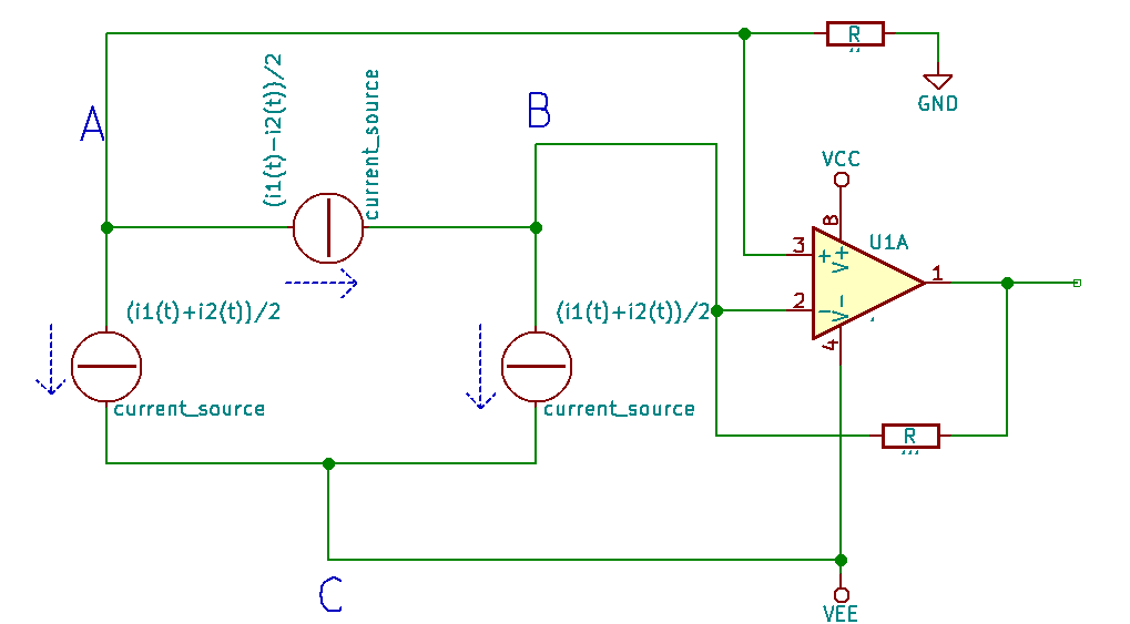

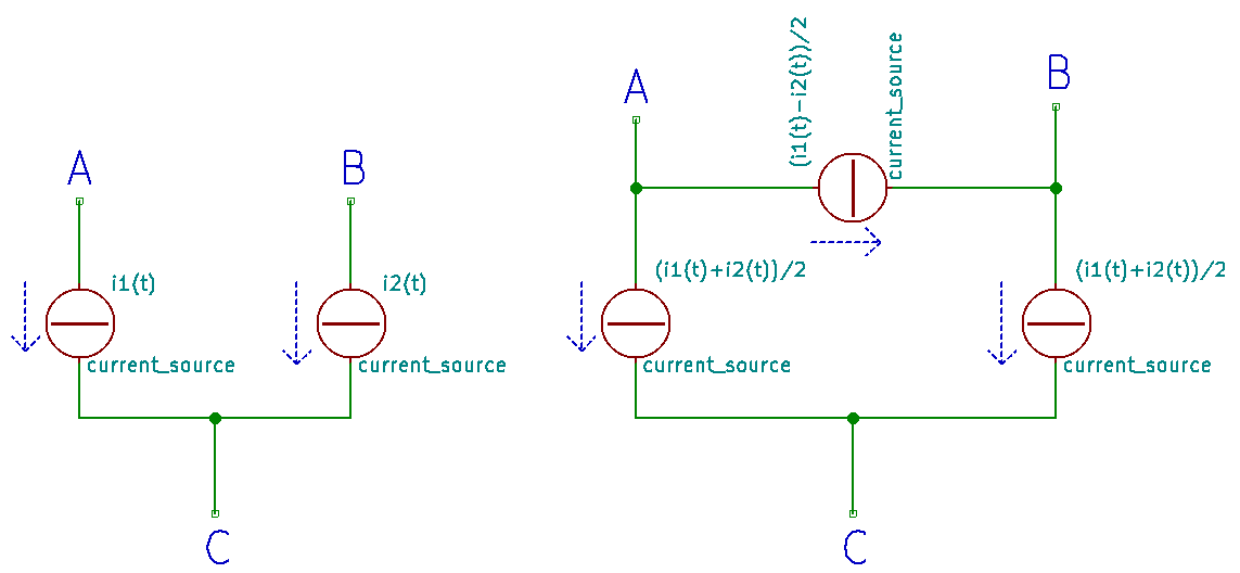

Regarding the definition matter, I would like to make one final attempt to figure out precisely where and why we disagree. I'll explain my point of view in the smallest steps I can come up with, so you can point out precisely where you start to disagree.
I've drawn a sketch with two time-dependent current sources, i1(t) and i2(t). I'm not making any assumptions about whether these are correlated, uncorrelated, correlated with a negative correlation coefficient or anything. They don't even have to have anything to do with noise, one might just as well be representing a Bach cantata and the other a Britney Spears song.
Do you agree that the circuit with three current sources drawn right next to it is an exact terminal equivalent? I think it is hard to deny this, because the current flowing through A, B and C is exactly the same for both circuits, but maybe you have a different point of view.
Assuming we can agree on this, do you agree that the two sources with value (i1(t)+i2(t))/2 have the same momentary value and are therefore fully correlated?
In the second picture, I've connected the three-source circuit to a simple op-amp circuit with equal resistances in the + and - branches.
Do you agree that the two sources with value (i1(t)+i2(t))/2 together have (to a good approximation) no influence on the output voltage of the op-amp?
Do you agree that therefore the source with value (i1(t)-i2(t))/2 is the only one that matters in this circuit with equal resistances in the + and - branches?
If so, then why do you consider it immoral to specify the spectral density of the only source that matters?
If you should have an issue with the fact that none of my three sources correspond 1:1 to a physical source (they all play a mix of Bach and Spears), then why do you accept equivalent input noise voltages? Physically, most of the LT1028's equivalent voltage noise comes from collector shot noise of the input transistors, so it is not physically generated at the input.
