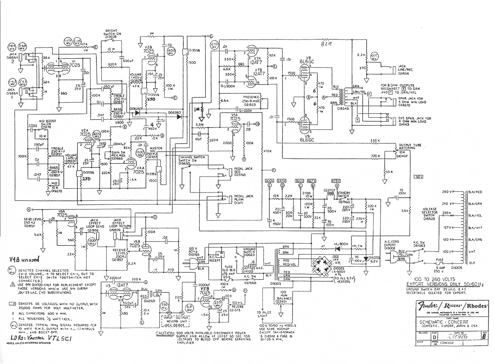

It's a Fender, here is a schematic...

So this leads me to wonder if this will work without trying it and doing damage:
I would wrap a wire around the cathode pin, carefully without touching anything else, insert it in the socket, and attach that to a 1 ohm resistor and connect the other end to ground. Then, measure the voltage on the tube side of the resistor.
Would I be inviting something unwanted doing this?

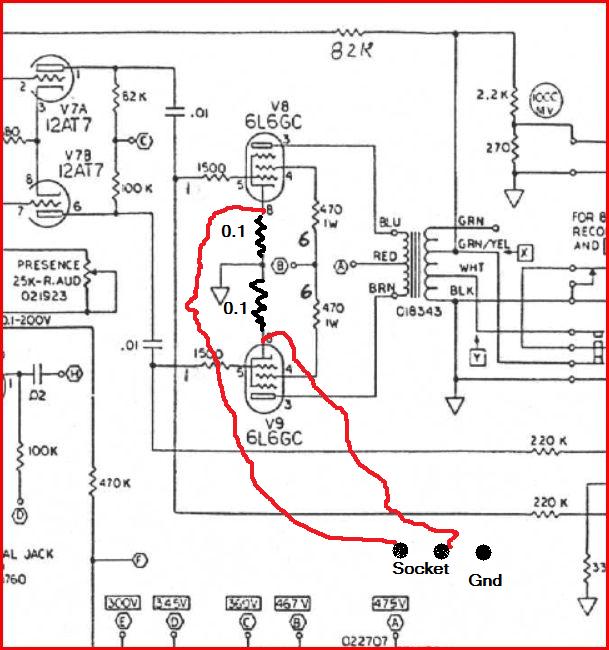

As you describe it, it wouldn't work because the resistor is just going across a wire (the cathode to ground link). For it to work correctly you would need to break the original cathode to ground lead and substitute with a resistor.
Now doing that would give a combined value as both valves run into the same point. So ideally you need two resistors, one in each cathode to be able to balance each value. With DVM's being able to measure accurately at low levels you could use really low values here that would have essentially no impact on the circuit or sound. Even values as low as 0.1 ohm would be OK given that most DVM's accurately measure in the low millivolts OK.
It's much safer doing this (resistor in cathodes) than measuring the anode current. You could wire the resistors to a couple of sockets somewhere so that the readings were always easy to get at.

The cathode bias resistor is in series with the two cathodes. Break the connection between the cathodes and the cathode resistor. Insert a 1 ohm resistor in each leg of the cathode of each tube. Run a wire out from the top of each resistor to a terminal. Run a wire to the bottom of the 1 ohm resistors to another terminal so you can measure across the resistors in either fixed or cathode bias mode.
