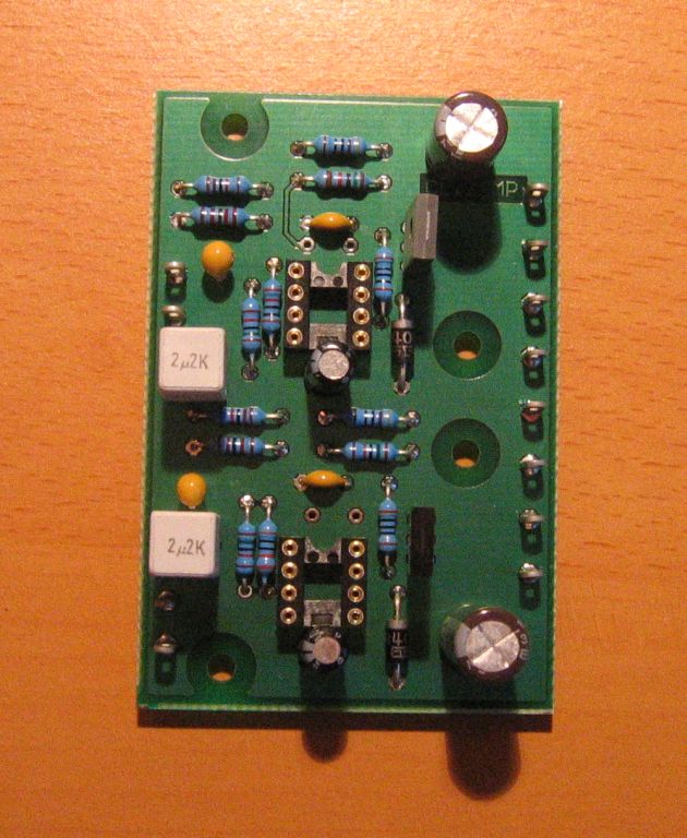

Continuing in my search for high quality link signal transfer, I have developed the current loop transmitter module. It is a voltage controlled current source, operating in pure SE class A. The signal current is 12mA +/-6mA, 2mA/V. Cable terminated by resistor 50 Ohm - 200 Ohm. AC coupled input of following amplifier is needed. The sonic results are more than promising, compared to any previous principles.

Intrigueing, Pavel,
Can you tell us more, such as Zin, Zout, FR, the sort of amp it requires, and how it sounds?
Hugh
Hugh,
I do not think that these parameters are of special importance. OK, Zin = 15 kOhm, Zout = very very high, BW = several Hz - 200kHz. BW has been limited from original MHz range. The step response is purely (1 - exp(-t/T)), as for simple passive RC. Zload = 50 Ohm (at the input of following amplifier).
I have made a listening black-box test with 3 listeners (individually written impressions), they have all prefered current loop with basically same description - more clear midrange and highs, better resolution, more natural, non-artificial sound.
Cheers, Pavel
