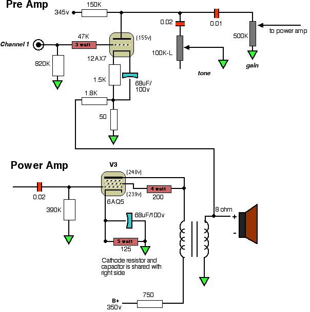

Hello, I am having an issue with an amp I'm rebuilding. It is a 6aq5 single ended stereo amp, RCA I believe. I don't have a schematic.
The problem is one side has little or no volume. They are both wired exactly the same, each has its own 12ax7 preamp feeding a 6aq5. I measure the current on the good side and the sound cuts out completely. But after much searching I noticed that when I measure the current on the bad side the volume does not cut out at all. I believe that's the problem, but I don't know why. Is the transformer bad? It has continuity in the primary and secondary, and the current measures close to the good side, only the sound does not cut out.
Suggestions please, thanks,

Here is a schematic:

I've been repairing amplifiers for 41 years professionally, and before that as an amateur - I doubt I've ever measured current through a valve in all that time, it's really not something you ever have to do. True, you do have to set bias adjustments occasionally, but amplifiers are almost always designed to do so with a simple voltage measurement.
In the circuit you posted both valves have cathode resistors, measuring the voltages across those will tell you the current through the valves.
The other obvious question is which stage is giving you the problem?.
What are the cathode voltages?
The power stage is giving me problems. The cathode voltage is 11.36v and the cathode is shared with the other 6AQ5. That means that 11.36v/128.5 ohms (measured) = 88.4mA. So for both tubes that should be 44.2mA each.

Well I found the problem. But I don't know why it was an issue. I had used a shielded wire coming from the volume pot to the .02 cap that feeds the 6AQ5 tube. For some reason I unhooked it to do something and didn't bother reconnecting it and the damn thing worked. The other side was so short I just used the cap leads. I ended swapping the transformer but not it. Switched speaker jacks, not it. Switched inputs, not it, took of the feedback line, not it. I was about to switch volume pots but forgot about something and then discovered the shielded wire was the problem.
Why???
