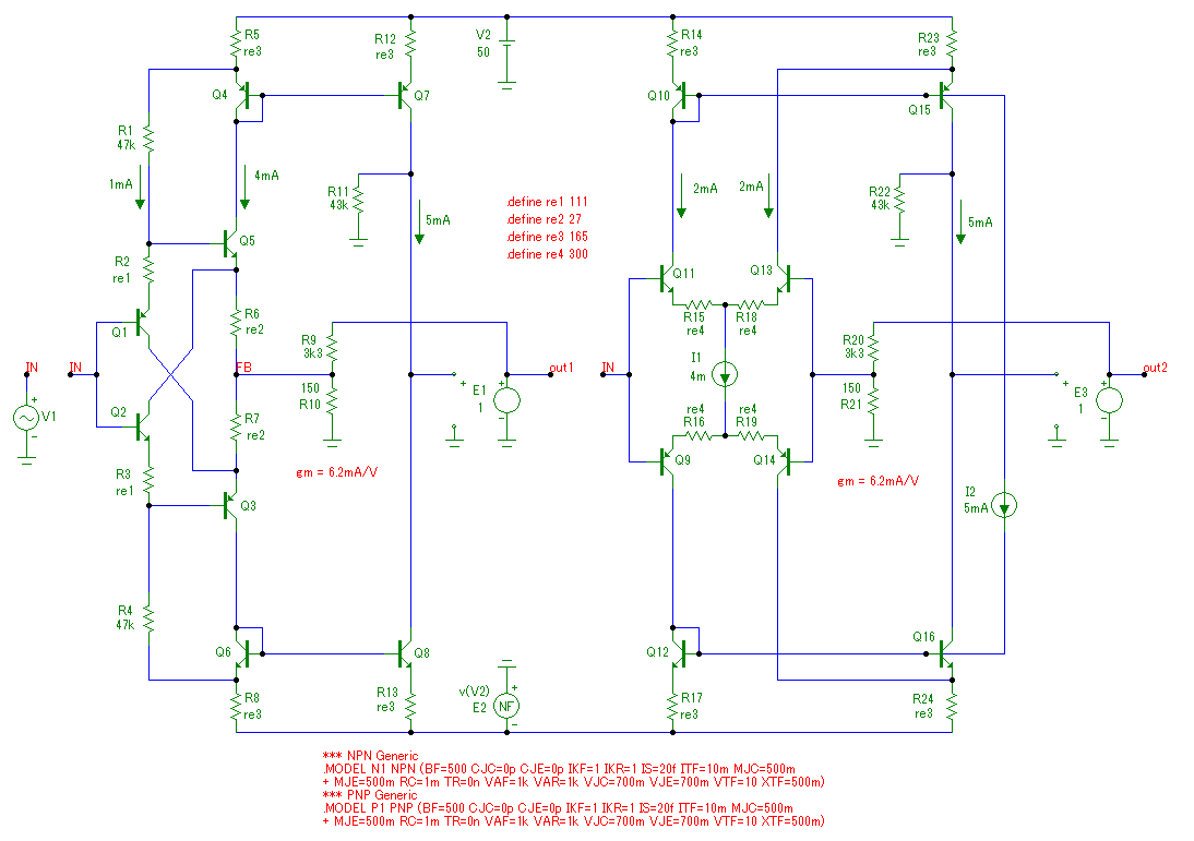

Out of curiosity, I did a comparative simulation of a VFA and a so called 'CFA' input stage. Provided that the CFA stage is correctly configured and provided that the trannies are truly complementary (not possible in real life), the CFA stage produced 2000 times less distortion.

Hi Edmond, could you show simulated amps circuit? In my simulations I've got just opposite, must be that I do something wrong.
BR Damir
Okay
E.
Yes, but with less open loop gain available, significant nonlinearities elsewhere in the path really kills. Really evident making changing an ideal voltage follower have a nonlinear term.
As far as mismatching I typically start with an ideal transistor set of parameters ie IS={IS} BF={BF} CJE={CJE}, common between npn and pnp transistors except that one set has an additional multiplier M so these parameters look like IS={M*IS}, BF={M*BF} etc. Typically will add reality to parameters one or a few at a time, then add mismatching.
I was actually surprised how much mismatch was allowed before reaching the same level of distortion.

This is not fair comparison. As CFA you use current conveyor and ideal output stage(as in VFA), but a current conveyor is very load sensitive and with real output stage VFA will produce lower distortion(at least in all my simulation attempts).
BR Damir
Hi Damir,
Why it is not a fair comparison? I'm only comparing the two input stages. The rest is kept the same. Whether it's a real amplifier or not, doesn't matter. It's just a test circuit where the input trannies operate under the same conditions (i.e. same trans-conductance and same ratio between AC current vs idle DC current).

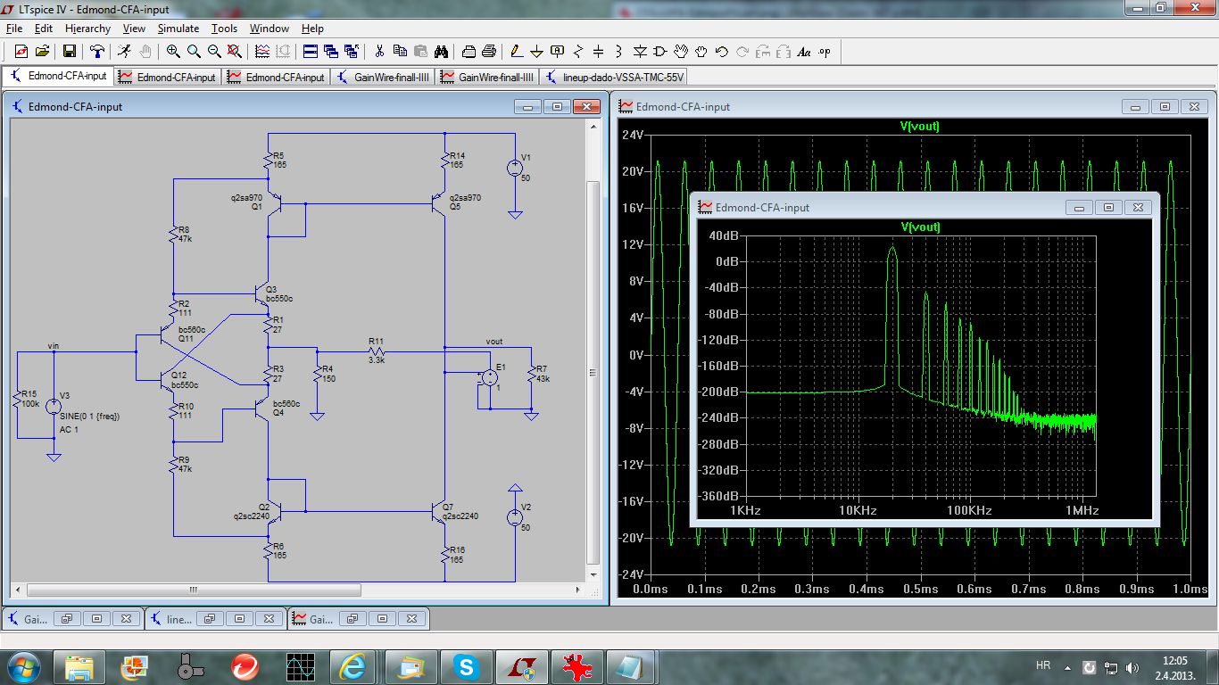

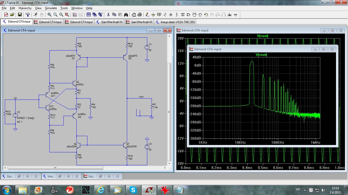

Hi Edmond,
I simulated your input stage in two mode, as CFA and as pure current conveyor with no feedback, and difference in distortion is very small, 0.031589% for the CFA and 0.045572% for the CC.
My point is that a current conveyor has low distortion by itself and feed back will not improve it much.
Here are my simulations.
BR Damir
