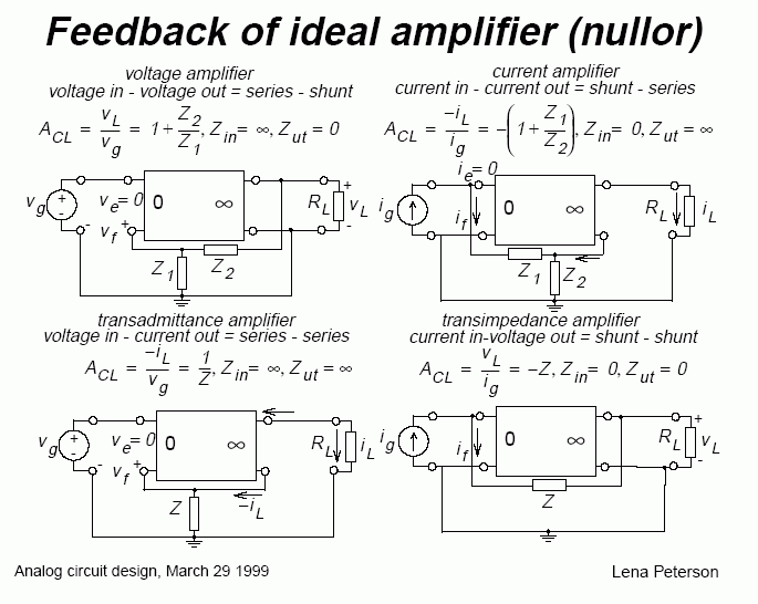

JonMarsh said:Is is just me, or is this guy on a one man crusade to redefine industry standard concepts and definitions?
[snip]~Jon
Jon,
If it is a crusade, it's more than one man's. Nobody disputes that the bandwidth thing is the result of the low impedance at the feedback point. What IS disputed is to call it therefore a CFB amp. There is a fundamental difference in pov. For me, VFB means that the effective input voltage is build from the difference of the system input signal and the feedback signal, via voltage subtraction.
Imagine an amp with a single input transistor with the input signal at the base and the feedback signal at the emitter. The effective input signal is then the Vbe, which is obtained through voltage subtraction: Vb - Ve. Now, of course the emitter being a low impedance point, one can say, hey, there's current going into the emitter, so let's call it CFB! That's rather arbitrary, because there is also going current into the base, after all. By that definition, a standard long-tailed pair with the signal at one base and the feedback signal at the other base could also be called CFB.
It is very unfortunate, because there IS a perfect definition for CFB, which is that you obtain the effective input signal by subtracting a feedback current from an input current. That's what has been in all te textbooks until some marketing guy started using it in a different way.
But, I realise, logic has not much to do with it, if all of you want to stick to this marketing term, maybe I should end at least my part of the crusade....
Jan Didden

It's hard for me to follow Cherry's arguments with only the text and no diagrams. But let's assume for the moment that his argument has technical merit.
And now (assuming that the pinouts are the same), do you think you could take any given circuit and substitute a "current feedback" op-amp for a "voltage feedback" op-amp, or vice-versa?
Of course not.
And that is exactly why the term "current feedback" was coined. It provides a convenient shorthand way to separate two classes of devices. It is an important distinction, and the term itself is quite descriptive (except possibly to the overly pedantic).
And, as I predicted, this "debate" has devolved into a dreary argument about semantics.
Of course not.

- Current feedback - Voltage feedback, how do I see the difference?
