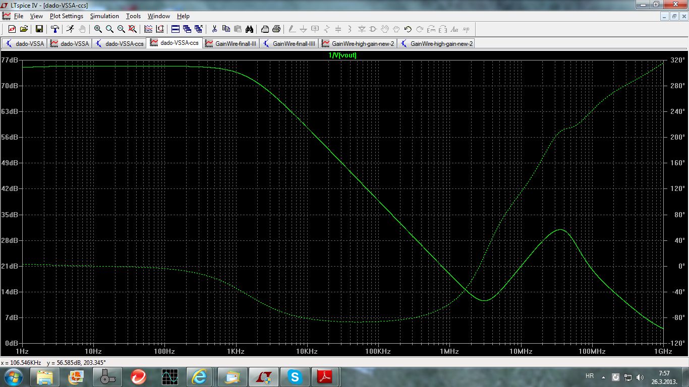

So untrue, VSSA 1 mV DC stable without any servo, PSSR 100 dB. :yes:
You never support your claim with any measurement or at least simulation.
Here is my simulation of the VSSA PSSR.
BR Damir
