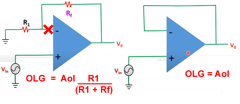

It may not be completely correct to say this in case of the voltage feedback amplifier as what matters is the net loop gain (Aol & network) and not Aol itself. In case you meant to say that the value of Rf doesn't affect slew-rate etc. for a VFB amplifier, that's true, yes.The point is that for a CFA the open-loop gain Aol of the amp is adjustable via the network impedance at the inverting input, whereas for a VFA the network impedance does not affect Aol.

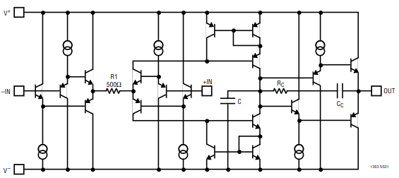

LT1363:
Which is a VFA but based on a buffered CFA with fixed degeneration and fixed Aol to have a universal and (almost) unity gain stable OpAmp.
Obviously, we cannot make a CFA with an LTP input but we can make a VFA with a non-LTP input.

LT1363:

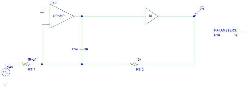

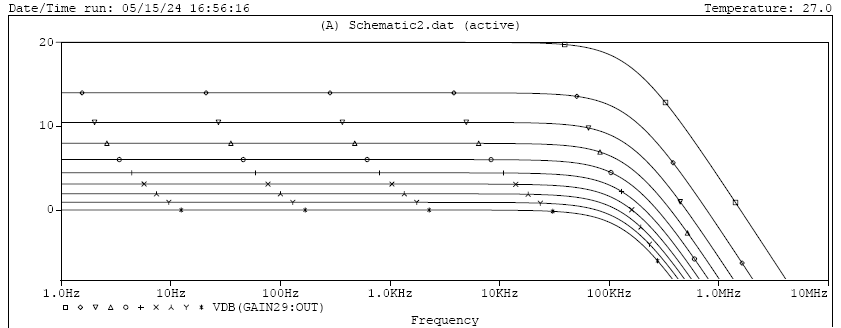

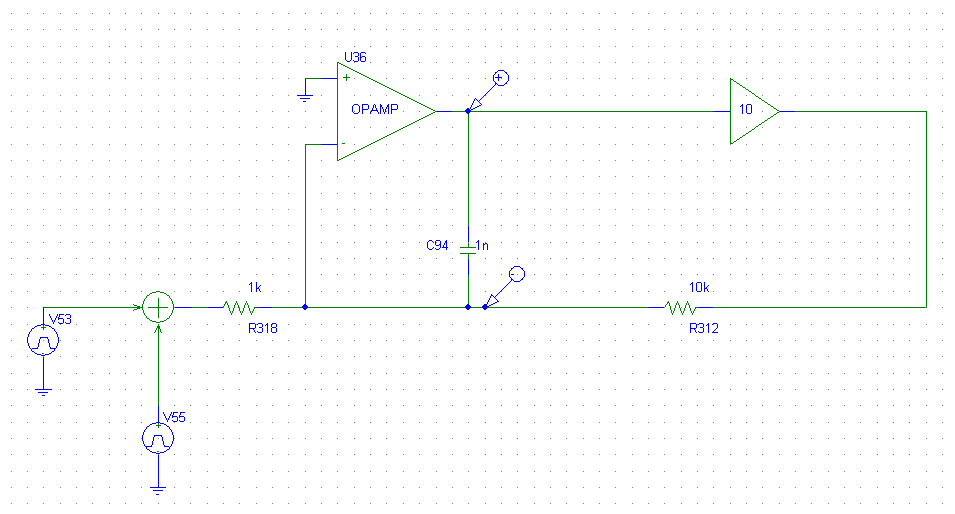

The following uses VFAs to obtain gain - bandwidth properties like those of a CFA. The resistor R311 is parameter swept to vary the overall voltage gain from 0dB to 20dB. It is fairly easy to see that the bandwidth is the same across all gains.
Yep, it retains one property of a CFA which is constant BW vs Rg (Rval).The following uses VFAs to obtain gain - bandwidth properties like those of a CFA.
However, in your design, when you scale the resistors by k and the capacitor by 1/k the response does not change, unlike a "real" CFA.
This property is said to greatly improve the step / pulse response, which is what makes people pick a CFA, despite its drawbacks. If not, correct me.Yep, it retains one property of a CFA which is constant BW...
Come on, how often do these change values, especially in a real amplifier whose design has been finalised ? And, there're also the other differences like DC accuracy, inverting character etc. of which some could actually be improvements over the CFA. One might also want to add a buffer (as initially mentioned by the OP) to obtain the high input impedance of VFAs.....when you scale the resistors by k and the capacitor by 1/k the response does not change, unlike a "real" CFA.
Yes, that is not a 'real' CFA but something that can provide similar performance for people who don't like / want 'real' CFAs. What I've drawn is rudimentary, and the design needs to be worked out in detail, on a case by case basis.
Non-slewing step/pulse follows mag and phase frequency response and vice versa, it the same thing just displayed differently.This property is said to greatly improve the step / pulse response, which is what makes people pick a CFA, despite its drawbacks. If not, correct me.
A constant BW at various gain settings is nice feature for a versatile measurement amplifiers but for audio I see no real advantage and the amps run fixed gain anyway, usually.

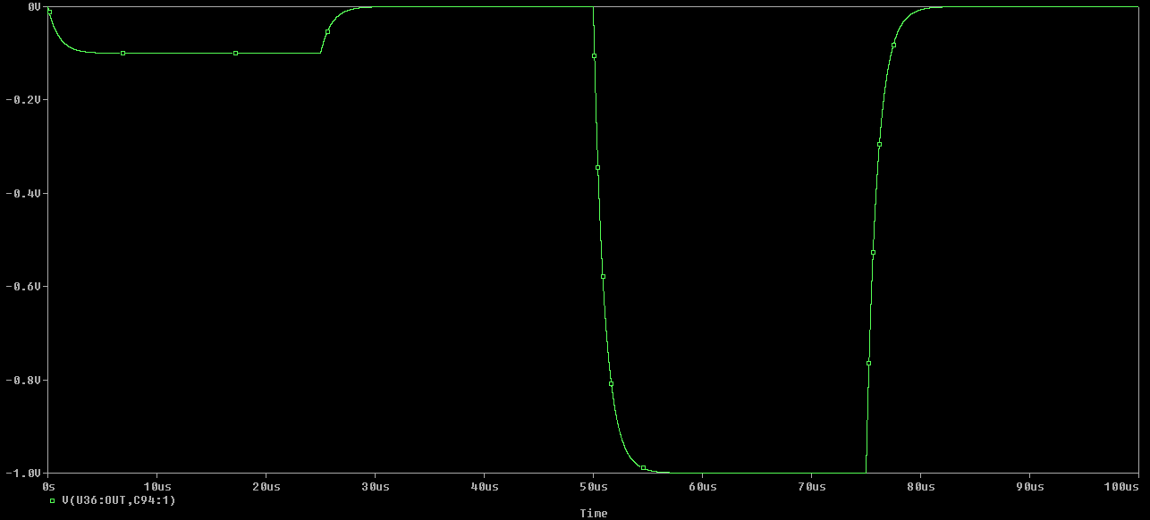

The following is the earlier circuit with a fixed gain of 10V/V, when fed with a 0.1V pulse followed by a 1V pulse. As expected, the voltage across the compensation capacitor shows comparable rise / fall and settling times for both pulses, confirming the slew current scaling action that occurs within.

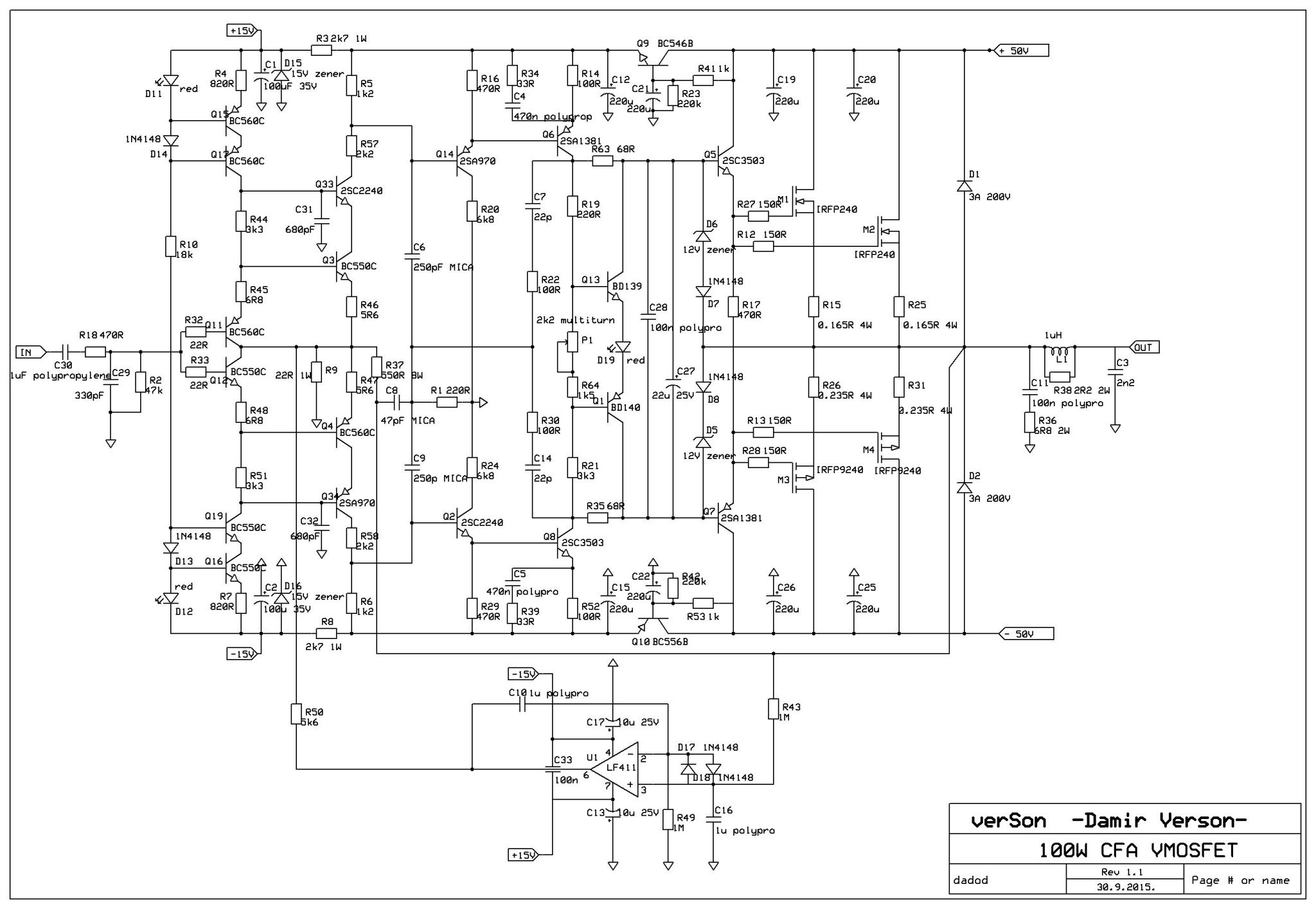

Thanks KSTR for the update. 80dB++ is good figure. But there are discrete designs as well. They are expected to give both, contemporary PSRR and THD figures. For example @dadod has posted here his design. @dadod, it would be great if you could publish PSRR and THD figures for this design? Thanks in advance.

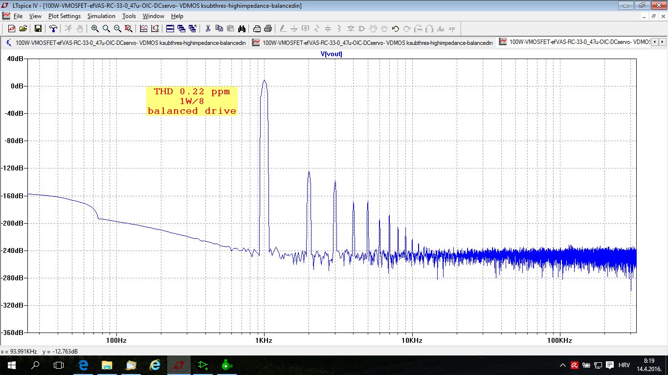

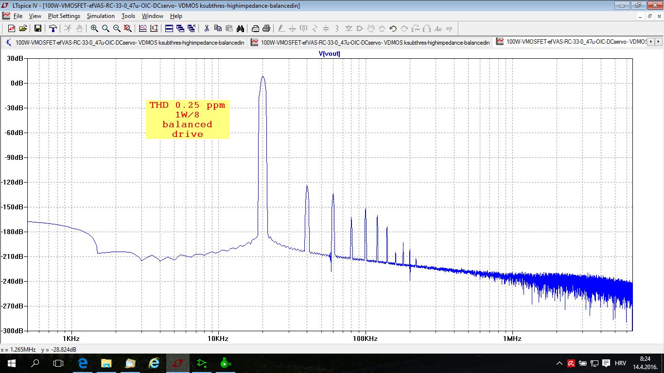

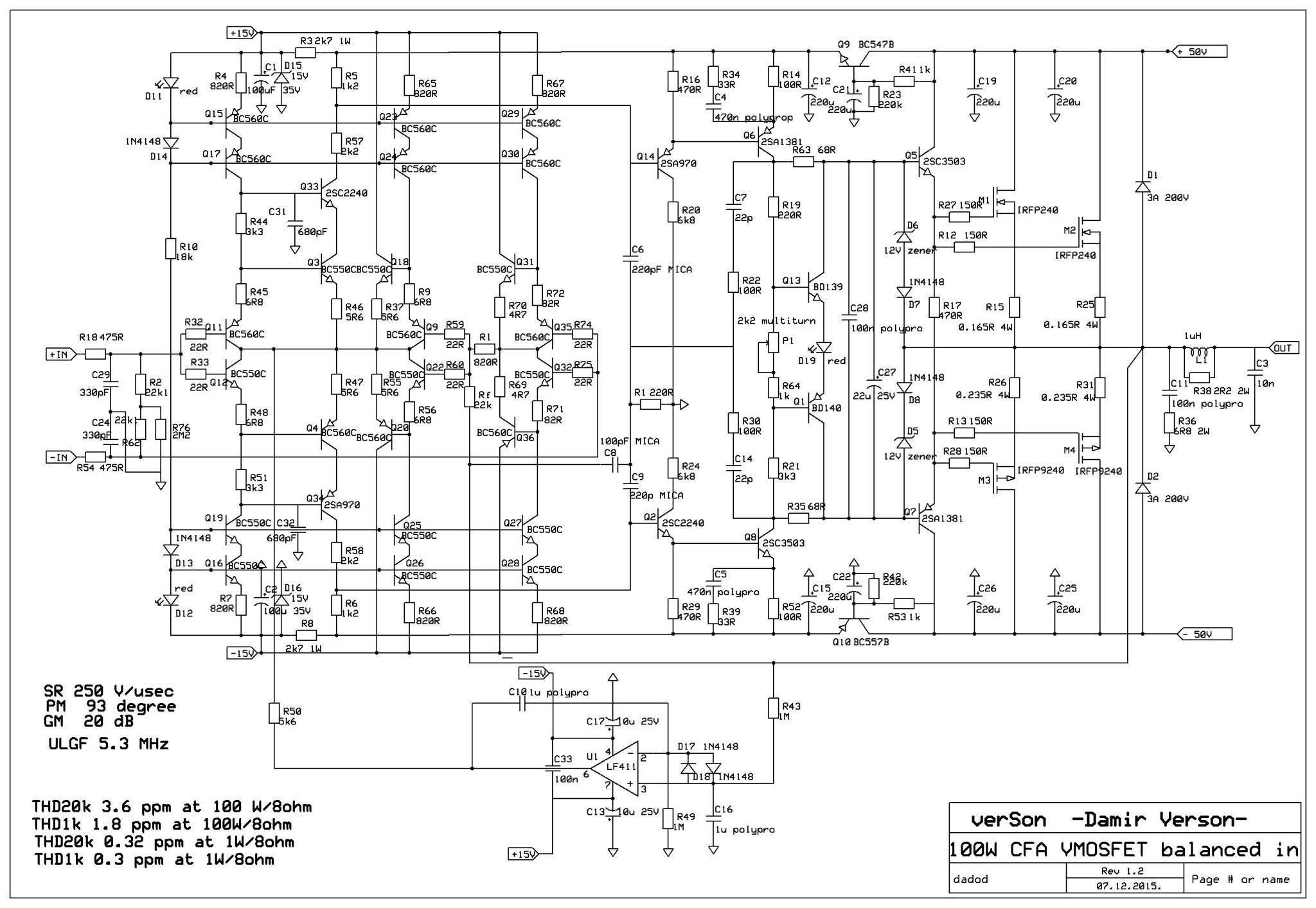

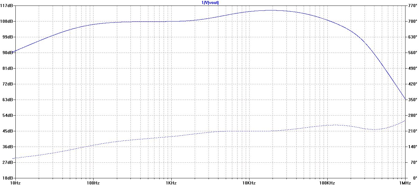

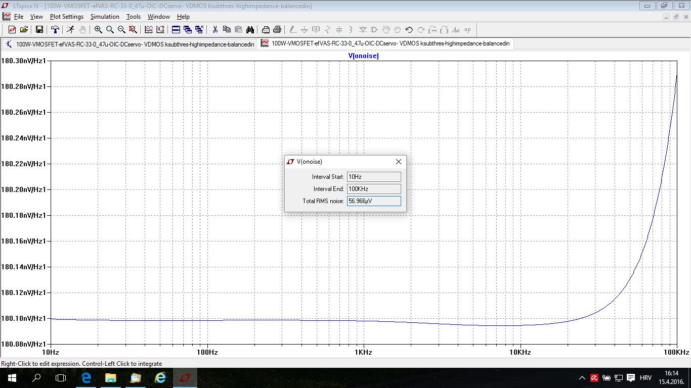

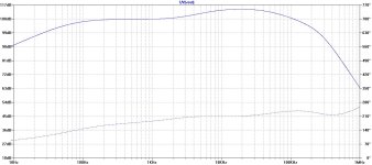

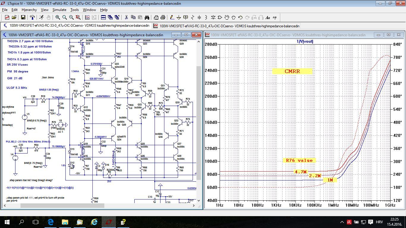

OK, here are some simulated data of the balanced amp from post #23.
I never built 100W balanced version but only 200W, it sounds great.
First one is PSRR, second one is CMRR.
Damir
Damir

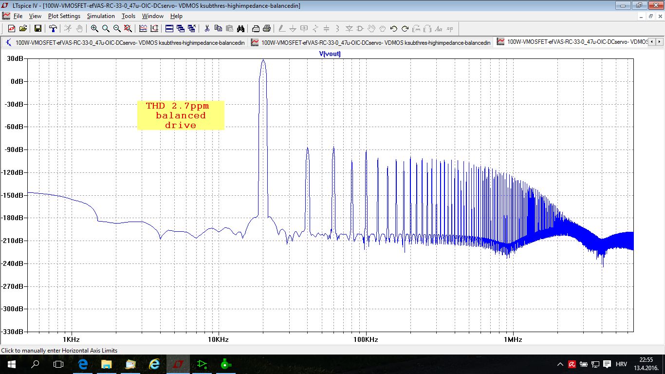

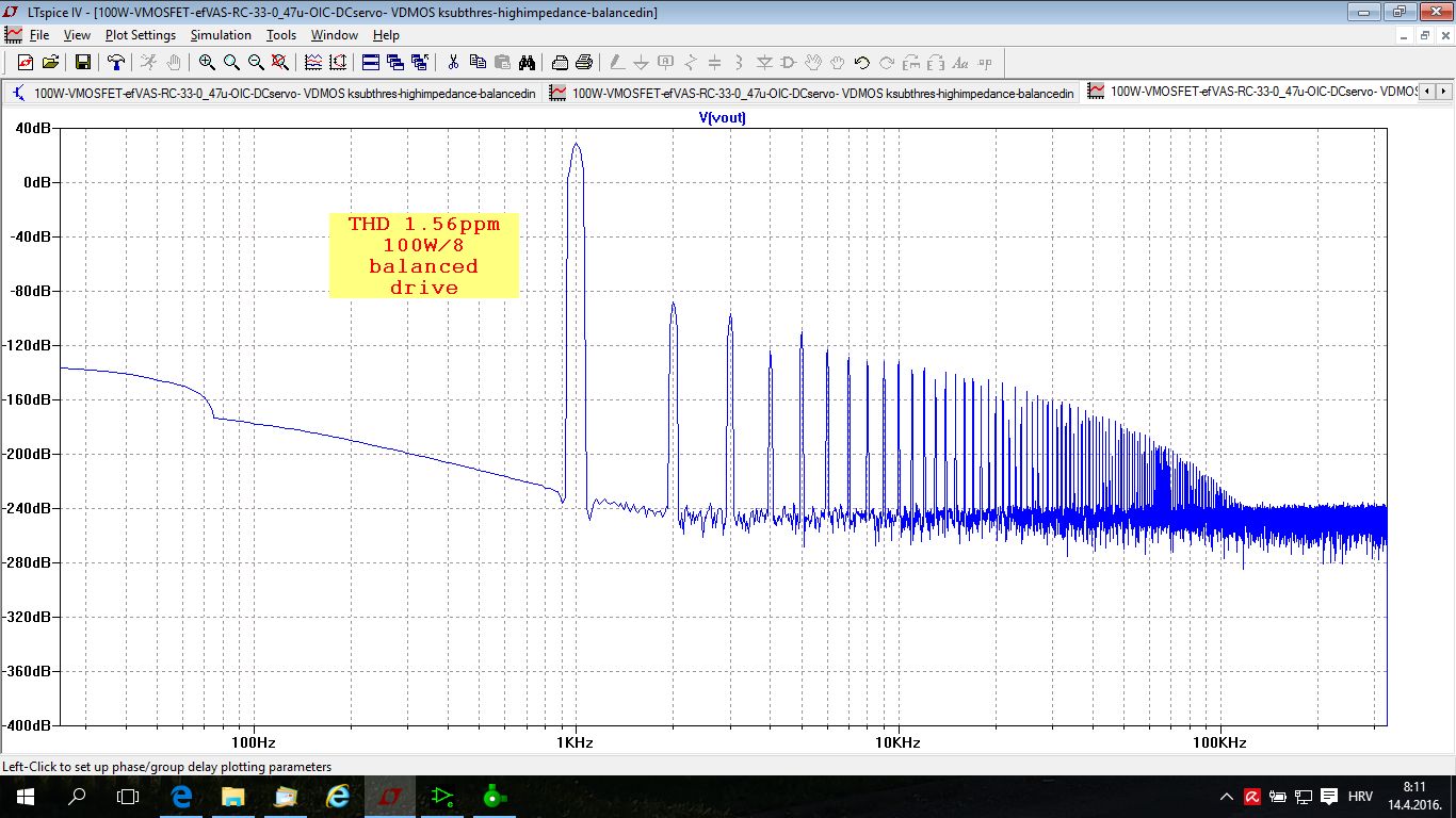

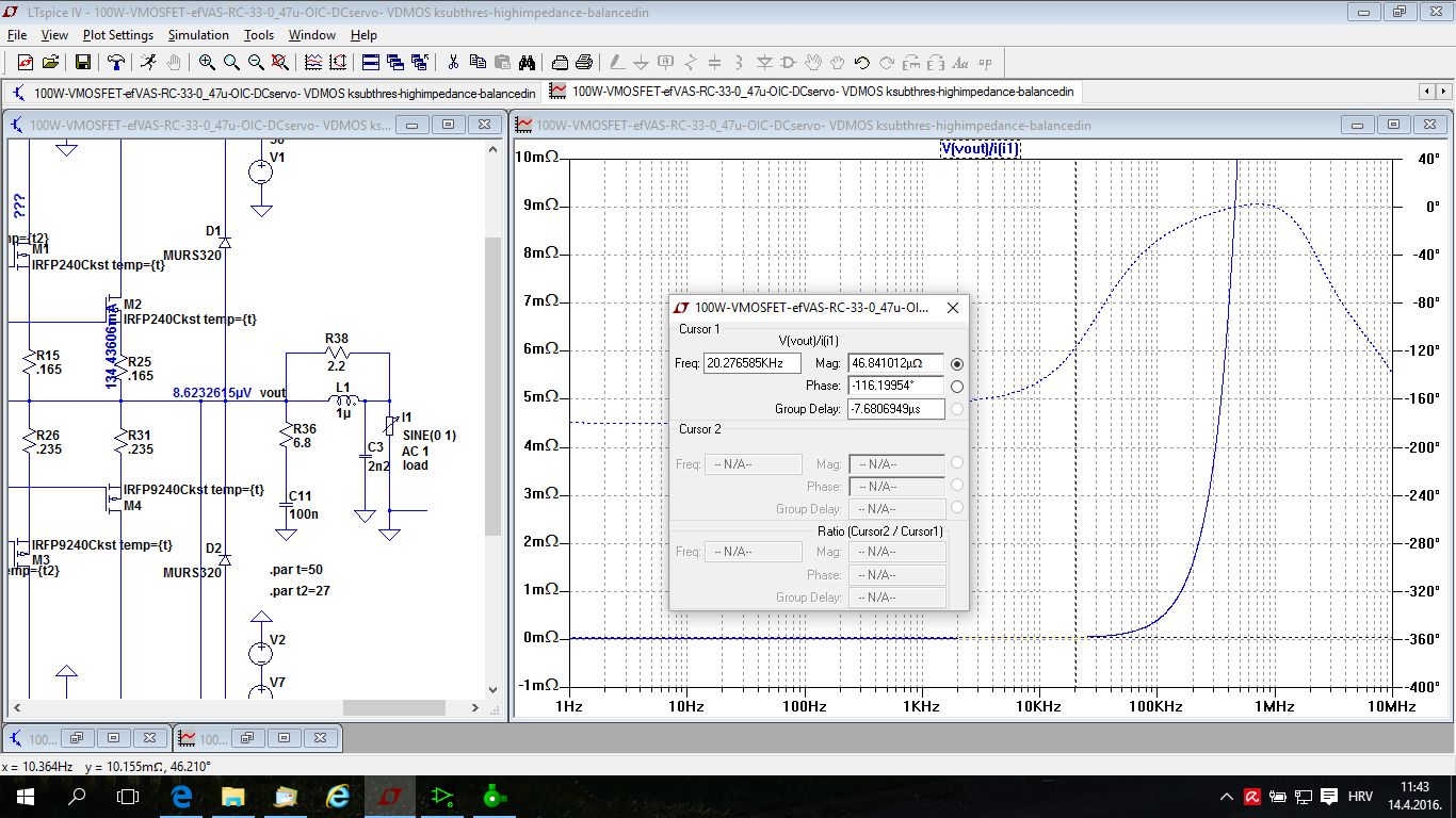

100W CFA MOSFET -1-2-balancedin-FFT1k-1W-balanced-drive.jpg174.7 KB · Views: 56
100W CFA MOSFET -1-2-balancedin-FFT1k-100W-balanced-drive.jpg183.9 KB · Views: 52
100W CFA MOSFET -1-2-balancedin-FFT20k-1W-balanced-drive.jpg174.7 KB · Views: 58
100W CFA MOSFET -1-2-balancedin-FFT20k-100W-balanced-drive.jpg185 KB · Views: 56
