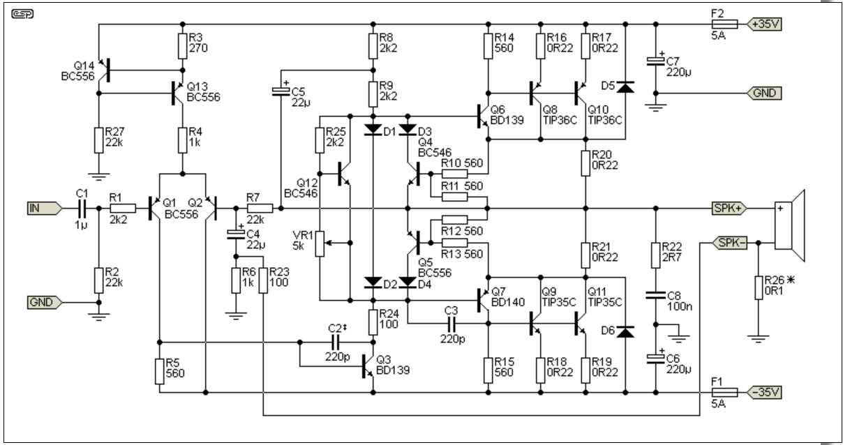

I have a board for a PCB for a Darlington TIP41/TIP147 power amp. I may start a new thread about modifying it to be best used with guitar.

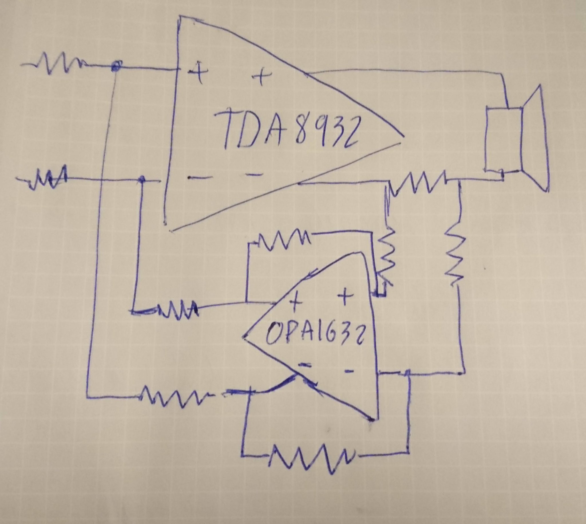

So, out of curiosity I reached out to Rod Elliot and asked him about current feedback/drive in Class D amplifiers. This is what he said:
You can add the required circuitry externally, since very few PWM amps have the necessary input circuitry to allow the addition of current feedback.
An opamp can be used to buffer the input and provide the extra input needed to get current feedback. This isn't a process I've tested or documented, but it has been simulated and I know it will work.
If you look at the circuit for the P27 power amp, that shows the current-sense resistor, and the feedback is simply applied to an input opamp, rather than to the input pair of the amp. You will need to experiment, because there's always the risk of instability due to phase shift through the Class-D amp.
Here is the power amp schematic provided in Project 27:
Here is a thought:
I currently have a couple TPA3118 boards would it be possible to design a pcb to use with each of them to implement cfb?
I'm guessing it would connect from the negative speaker terminal on one end and to the input on the chip?
Based on his comments it would probably contain a few resistors and an opamp? Maybe a capacitor?

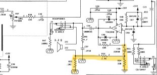

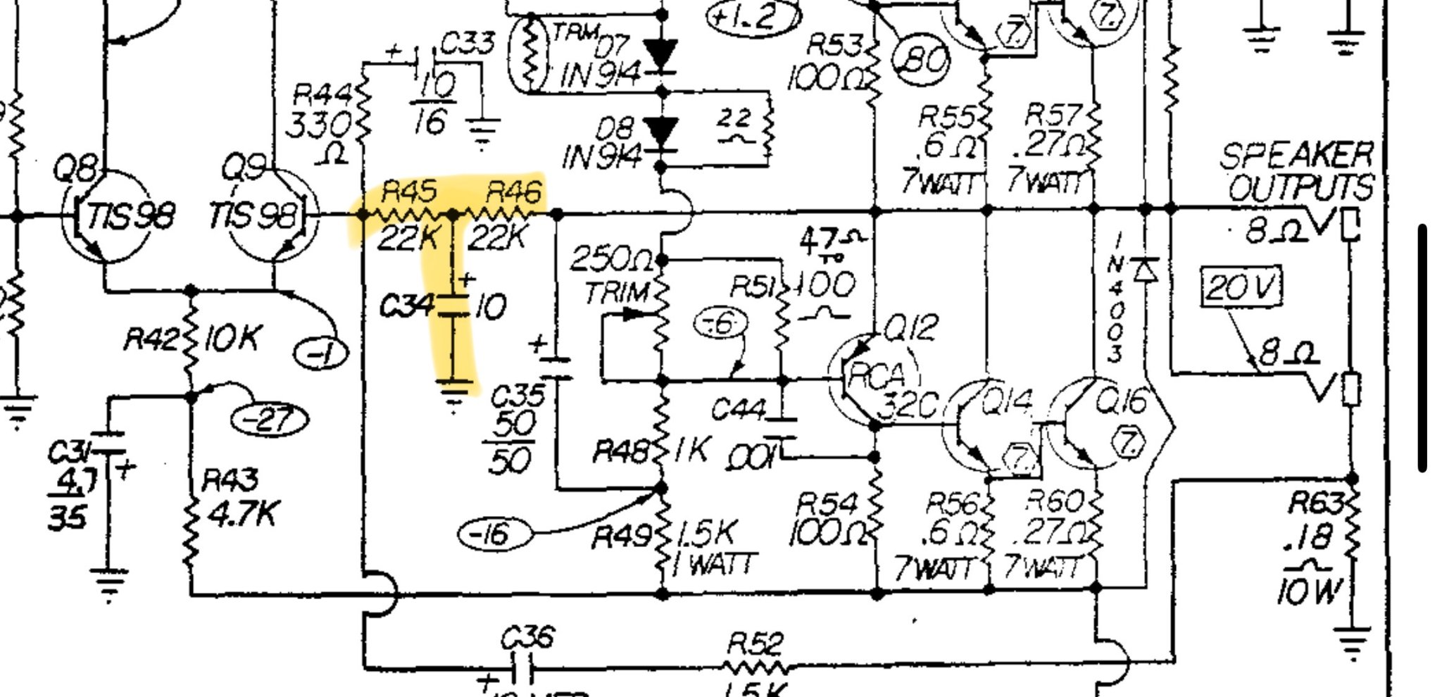

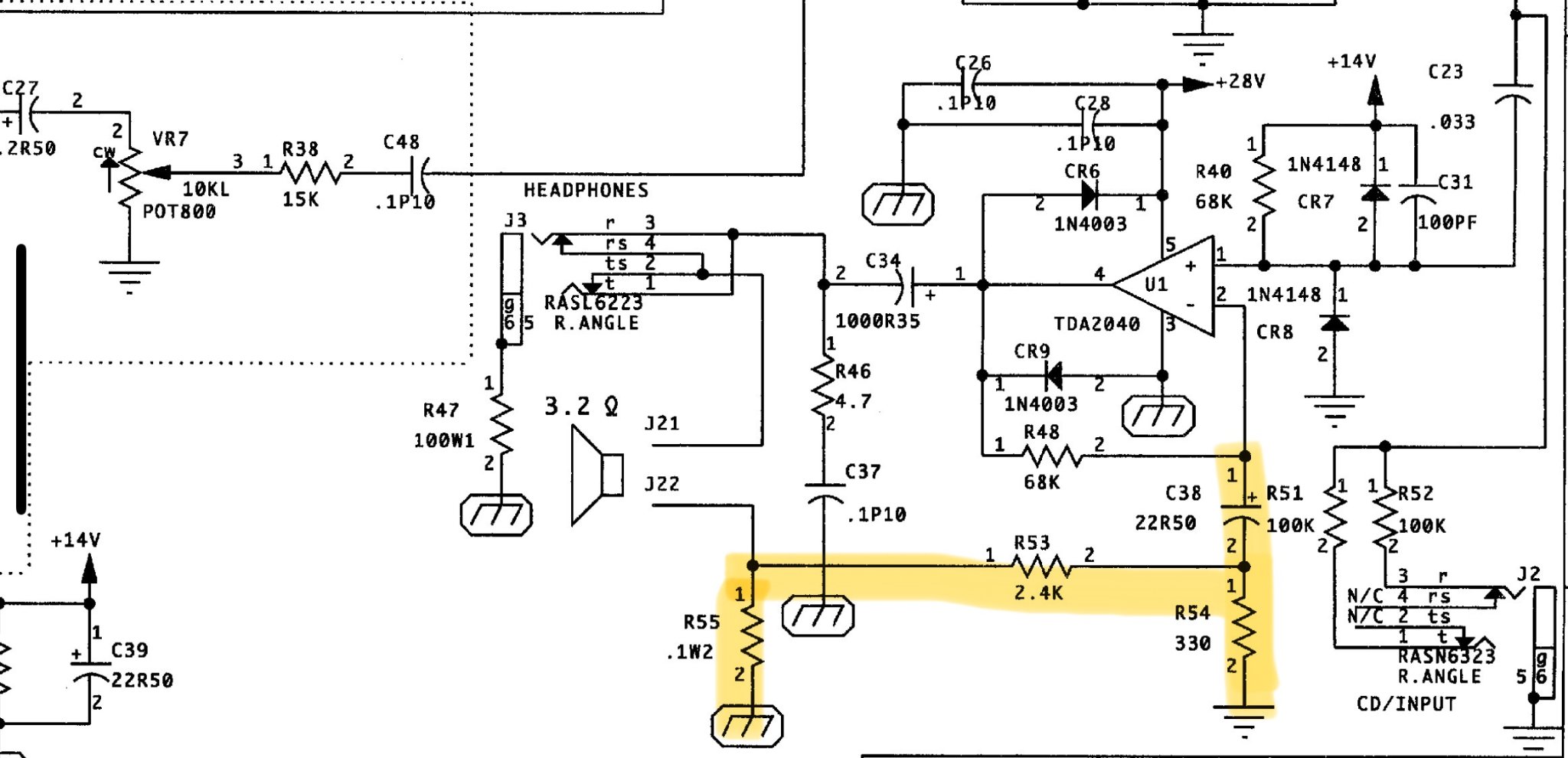

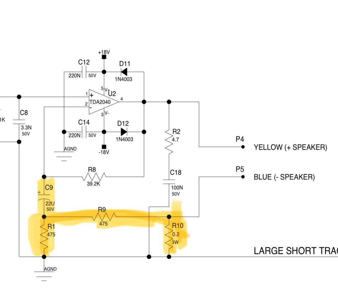

I've been doing some research on this and looking at some amplifiers that have been stated to use current (mode) feedback.
There is also the CFB vs VFB article from Elliott Sounds for reference.
Unless I am missing something, it looks like the majority of this is feedback is done via 2-3 resistors and a capacitor.
But based on Rod Elliot's email to me an opamp could (should?) be used to buffer the input. Could this be a readily available IC or would a discrete opamp like Rod Elliott's DIY CFB Opamp ?
The other question is, does this hypothetical board need to connect to the input of the amplifier board or to a specific pin. If it needs to connect to a specific pin, which one?

For guitar use a "mixed mode" amp is needed, with an output impedance typically ranging from 2 to 20 depending on what you want to achieve, not a "current source" amp.
Quilter amps are "mixed mode" class D amps with an output impedance equal to that of the tube amp they emulate. Quilter owns a patent on this so no other amp builder can do that without a license from them. This maybe explains why there aren't other amps like that on the market.
With a ground referenced output like Rasmussen's one above it's easy to implement with few resistors if it already has an inverting input available; see Rod Elliot's site and @Megatrav post here.
Almost all class D modules and amps in general are not ground referenced output (I don't know any) but "bridged output", so things start to get more complicated and modifying one not a viable idea.
But class D amps can output a lot of power with high efficiency, so if your need is a 20-40 watt tube amp equivalent you can easily get a 100w class D amp/module and put a proper resistor between it and the speaker. Actually some high wattage resistors in parallel are needed because they are going to dissipate a lot of power (like tubes do). Using some halogen bulbs you can even emulate the tube amps sag.
Cheers
Teo
Cheers
Teo
I think there was some discussion in that thread of a variable output? But that would have to be figured out and added to the schematic.
