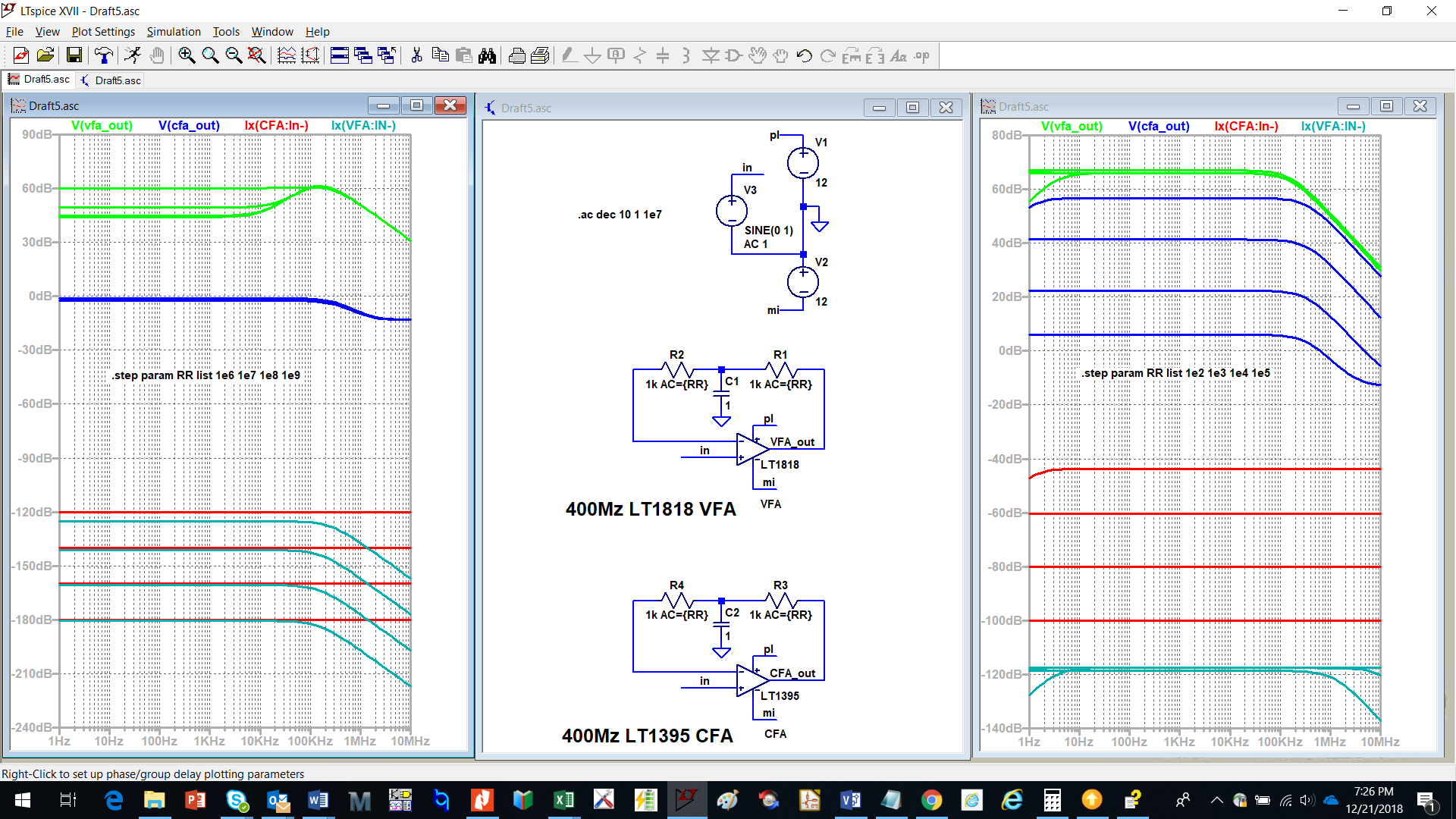

Hi again, Hans. As I mentioned, I wanted to consider the assumptions and limits (even the absurd ones) of your proposed test. I've selected a 400MHz VFA and a 400MHz CFA. I draw no conclusions, make no proposals, and have no hidden agenda. I simply present some data and am interested in your thoughts.
The first thing I wanted to do was to vary the shunt resistor in your test more than the 500 and 5000 ohms that you used. The more I thought about it, the more I decided I didn't need it. Because of the 1 Farad capacitor, I could simply vary the resistors in the T network.
The attached looks at not only the output voltages, but also the inverting input currents which, considering the 1V non-inverting input, can be thought of as conductances.
Again, no agenda on my part. Just interested in your thoughts about the results.

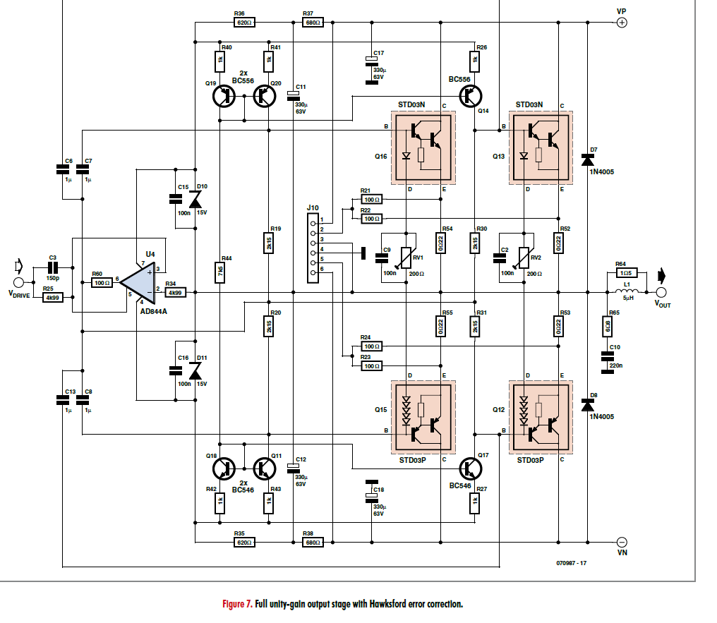

Hah! If you want weird uses for the AD844, try to parse this! 😀

Yes. The circuit around the AD844 is in concept (and execution) very simple, straightforward, but almost nobody sees it because it is so unusual. When explained, they all say - but of course! 😎
And of course if your mindset is in denial of current feedback, no way you are going to understand it!

Maybe I'm overlooking something, but this amp has only a gain of 0dB or was this the intention ?
The connection from In+ to Tz is quite clever in keeping the whole circuit stable.

Yes gain of one output stage, that's also what the caption says ;-)
Actually that connection is positive feedback and does not help stability. The pos feedback at hf is decreased by the C3 across R25 to aid stability.
The way this works is that the difference between the + input and the amp output sets up an error current in R34. That error current comes out of pin 5 Tz (due to the current feedback operation ;-) and sets up an identical correction voltage across R25 which is added to Vdrive, the input voltage. This is the HEC error correction, and (with ideal and perfect matched resistors ) fully nulls the output error.

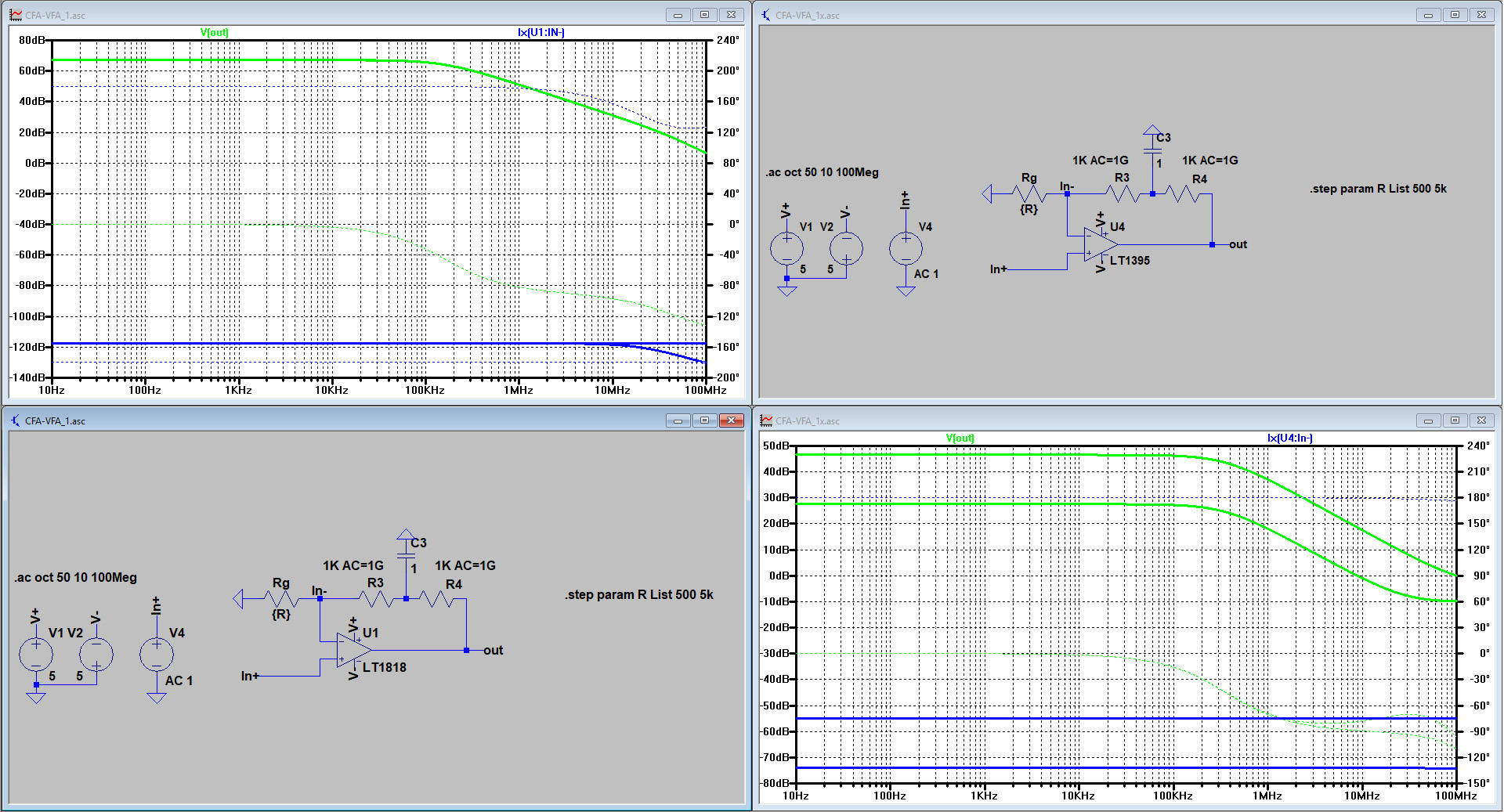

Sorry, but I did't really get what you tried to achieve.
The idea behind test my set up was that only the topology of a CFA makes that varying Rg in an open loop circuit wil vary the output voltage.
For that I have chosen practical values for Rg being resp. 500 Ohm and 5K.
The 1Gig feedback resistors for AC plus 1F in between can be regarded as open loop and only serve to zero the DC output voltage.
See my simulations for the same parts as you were using.
Quite convincing to my opinion, or is there still anything you are missing ?

Clever idea Jan.
However remove the connection from Tz and you have an oscillator that can only be killed with a cap on Tz, thereby significantly reducing the BW.
Hans

So in fact you have separated the voltage amp from the current amp, just like I did, true ?
Hans

Hans, what I posted was a simpler circuit (one less resistor). I also varied the resistor values over a wider range to test the limits of the idea. It was easy to look at both output voltage and input current, so I did. The results still allow you to distinguish between VFAs and CFAs.
