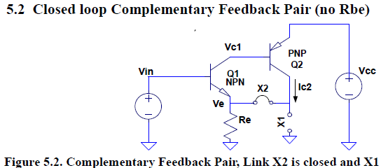

It covers BJT solutions using the Lambert W function for LF and large signal such as the emitter follower, CFP and hence CFA. I notice the previous posts mentioning that the EF,CFP,CFA are all in the same family.
Most test books only solve the small signal case for BJT's using the Re=26mV/Ic method but my PAK UG covers large signal solutions for any Vin up to hard clipping, which includes the DC 'Q' point which can then be used for small-signal analysis eg for the HF case just like SPICE "AC analysis" does).

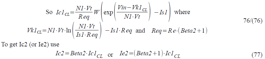

For example, solving the CFP for LF/DC see Fig 5.2 (attached from UG p66).The CFP can model a CFA by adding a feedback resistor 'Rf' where jumper X2 is; then write Vout = Buffer*Ic2*(Rf+Re) where 'Buffer' is the current gain of the output buffer. Also, for a CFA, Q2's 'beta' is that of a current mirror. Sorry I didn't think of doing the CFA solution when I wrote it. I may get to update it.
The solution for a CFA is then from Equation 77 and 76 (attached from UG p66-68) is the CFP, which is a subset of a CFA. The maths can now tell us what the circuit does, at least at LF.
All discussions about what the feedback does at LF can answered by examining this solution, since, once the output current is known, all other voltages and currents can now be derived from it. BTW I'd like to hear from anyone who has a text book that has a similar LF large-signal solution to mine.

I also attach the LTspice circuit that runs the equations above together with Cordell models (modified to disable the Early effect and Beta-fall). It shows the LF equations are accurate up to clipping. To run it you need 'Alternate' solver (set in the SPICE Control panel).

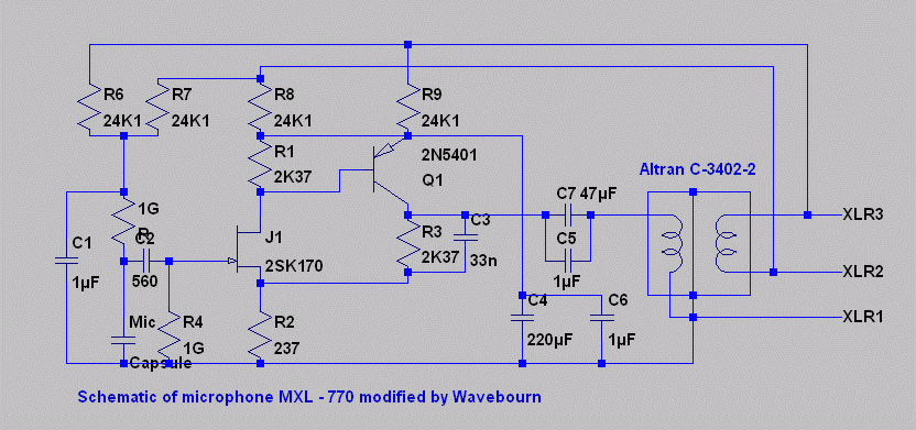

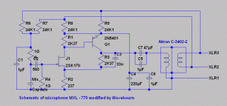

Who is "Lin"? 😀
I used them routinely starting from 1975, and still use.

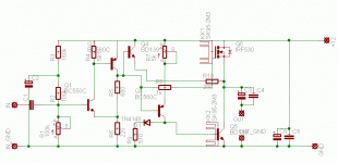

Examples are attached.

Who is "Lin"? 😀

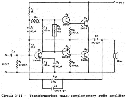

You know who Dr. Huang Chang Lin "Jimmy Lin" was, but for those who don't, you can see his circuit (attached) from
www.semiconductormuseum.com/Transistors/RCA/OralHistories/Lin/Lin_Page7.htm
He uses shunt-shunt feedback for both DC and AC.
You can hear him talk about his amp and the Sziklai pair (or CFP) here
www.semiconductormuseum.com/Transistors/RCA/OralHistories/Lin/Lin_AudioClip2.mp3
It is interesting that Dr. Lin used the quasi-complementary output stage because the Sziklai pair had just been patented 1956
Sziklai pair - Wikipedia for patents
