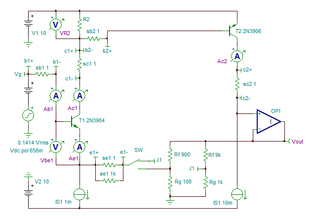

I simulated an evolution of my previous circuits with a single input transistor.
I added an ideal buffer at the output so that Rg is fed by a null impedance. The amplifier circuit has a voltage gain of 20 dB set by the feedback network, 9/1 kOhm or 900/100 Ohm.
Measuring the T1 emitter currents in open and closed loop, I found that in closed loop the impedances seen by the emitter of this transistor are 36 and 28 kOhm respectively.

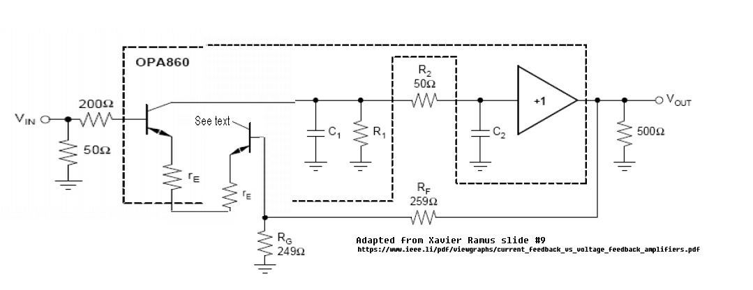

I have added a second input buffer to the Ramus slide 9. This makes it a "modern VFA" as in slide 12. Without the 2nd input buffer it is a CFA slide 9.
The difference is the base current that flows in the 2nd buffer when it is used. When the 2nd buffer is used the beta of the 2nd stage reduces the feedback current to the input stage.
This shows the type of feedback does not change only the relative amount of current fed back. So both forms do use voltage feedback. Relative current levels cannot change the fundamental operation principle.
The main difference is the relative current level at the inverting input changes, so the voltage divider resistor values for the CFA need to be lower for high open loop gain and for the HF end.
If anyone is interested in analysis of a CFA as a CFP a PDF is here. It uses the SPICE BJT model where Ic is generated by base-emitter voltage. So any attempt to drive a transistor base or emitter with a current source the circuit must first create a base-emitter voltage to allow that current to pass through. That's obvious when you see the collector-emitter current in the SPICE model is modeled as a current source which means you can't force current through the collector or emitter externally (assuming you work below it's breakdown voltage) unless you change the base-emitter voltage first.

...and that's exactly what I contest. The emitter imposes the voltage by delivering the necessary current at the varying impedance it sees at the feedback node. It is not the feedback which imposes its current in the emitter. This is so because the current feedback in Rf signal can't get ahead of the signal voltage at T1 emitter. If it does not happen like that there is a space-time violation. T1 base-emitter voltage commands, Rf current obeys.
That's exactly what I wrote more than once...
This is nonsense. The translinear relationship between Vbe and Ic is satisfied in the steady state for all of these circuits. The cause/effect arguments are pointless.

Forr, this is nonsense. A bjt common base circuit configuration is defined as a circuit where the reference (or ground, if you wish) is connected to the base, and the input is connected to the emitter, collector being the output of course.
It has nothing to do with levels of signals or impedances in the circuit.

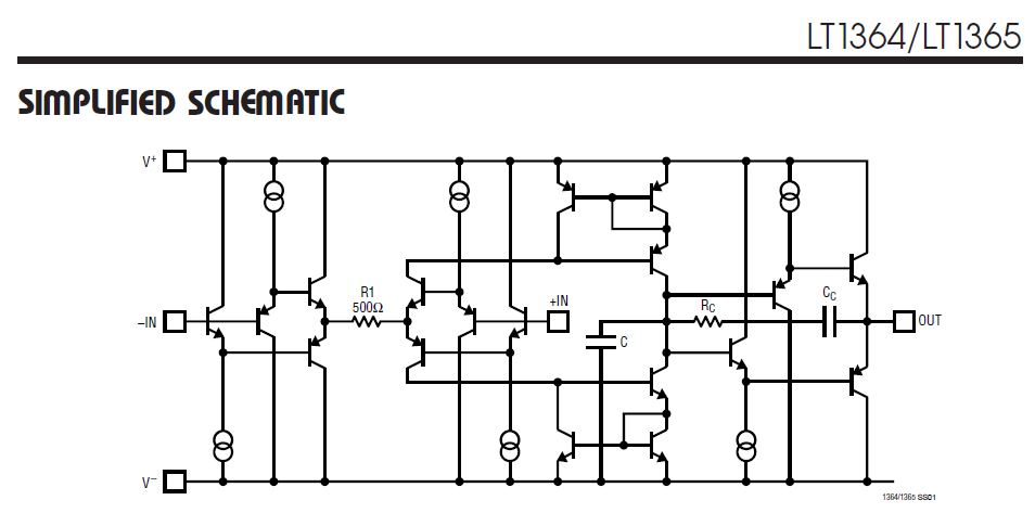

An interesting twist is LT1364, which has similarities to a CFA, BUT the inverting input is not common base.
In this case, yes it can be seen as the added second half of the differential, with R1 as the Rg of the CFA.

Apart that, your statement is only true for a circuit like LT1364, but not for most other VFA topologies.
A standard diff input is not a buffer, as it cannot supply or sink more current to the other leg (and into the VAS) than the tail current. The emitters are isolated by the B-E junction.
In a CFA, the current conveyed into VAS is not dependent on the biasing of the neg. input transistors.
This alone justifies a different naming convention....
