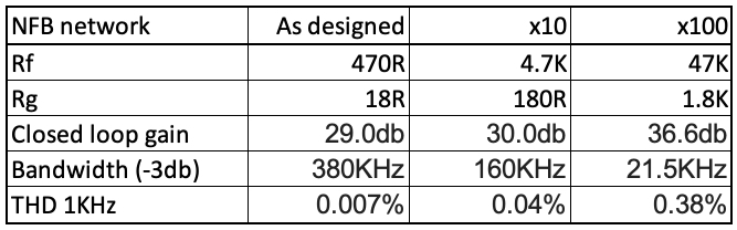

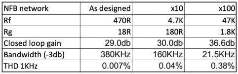

I ran a few quick and dirty simulations on one of my CFA designs.
Here is what we see (attached). All options are shown for the same output swing (20V RMS @ 8 ohm). I keep the Rf/Rg ratio the same.
The results pretty much confirm the considerations mentioned above (Jan, Pawel, CPaul). Higher feedback network values lead to narrower bandwidth, higher CLG (lower loop gain), resulting in higher distortion.
I was wrong with the assumption the low impedance "-" node requires the low impedance feedback network for controlling it - actual reasons for the low impedance FB network are explained in the posts above.
Thank you guys for the good discussion.
Valery

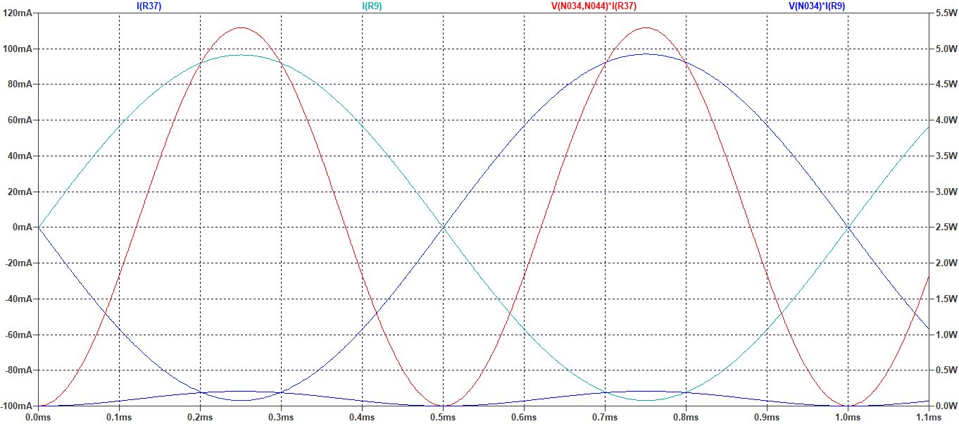

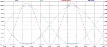

I simulated my 200W CFA, the plot of the FB currents and power dissipations on the FB resistors attached.
Output power - 200W/8ohm
R9 - Rg - 22R - 96.54mA
R37 - Rf- 560R - 96.95mA
Difference current going into - in =0.41mA
