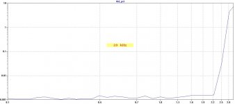

I don't understand - are talking about the rise in distortion as the input level signal decreases as depicted on the Vout vs distortion plots? Can you put up an example to make your point clearer?
There is no rise in distortion as the input level signal decreases in well designed CFA amp.
Attached simulated THD20k related to the input voltage.
The rise in 'distortion' with lower levels that you often see in (VFA) opamp circuits is often just worsening the S/N ratio with lower levels. Almost always it is THD+N that is shown, not just THD. What is shown in your graph?
A good example of how toxic simulations can be in a discussion. You are trying to make a point, then you got slapped with a simulation. It could be correct, it could be wrong, no way to find out up front. What are you supposed to do? Spend hours in extracting information from the authors, capture the schematic in your tool, verify the models, compare results, etc...? And for what purpose? Meantime, the original topic got diluted to the point of no return.
Not that I am trying to take anything away from your excellent amps Dadod, but that is a sim and you will get the same result with a well designed VFA.
The reason I ask Wavebourne for clarification is this:-
If you measure any amp - or OPA - the distortion will RISE as the input level decreases because the test instrument noise floor is increasing.
The AP SYS272 has a resolution of 2 ppm or circa -114 dBV. It should not come as a surprise therefore that when you measure a good opamp, the best performance is usually around 1~3V output - the AP sweet spot and somewhere before any LSN from the DUT creeps in. Note the AP has gain ranging/attenuation hence the sweet spot spread. If you measure the OPA with a 1mV input, the distortion is correspondingly higher. This has little to do with cross over or any other DUT artefacts - most OPA's are running in class A when delivering only a few mV into a reasonable load - 2k and up though some will do this trick into lower load resistances.
The reason why you don't see rising distortion in tube amplifiers is that the amplifier distortion noise floor is orders of magnitude higher - the test instrument noise floor is buried way below the DUT noise and distortion floor. The result is you get a flat plot until the DUT distortion starts to increases at high output levels.
Sims of course will not show this effect at all - the resolution is for all intent and purposes orders of magnitude below any real world test gear and your plot is an example of this.
