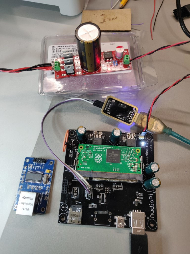

It's not the Boss' power supply that I'm worried about, it's the RPi's.
The RPi even when powered by a very good, low noise 5V linear power supply still has a number of on-board switch mode power supplies that inevitably pollute pretty much everything. This "pollution" is not severe enough to cause actual problems in the operation of the RPi but when it is coupled to our DACs through the I2S lines it can (and most of the time, does) cause degradation in the SQ.
This is the main reason that the RPi sounds better with a linear power supply vs. a run-of-the-mill SMPS. Noise signature. It matters even in the most carefully implemented systems. It's also the reason that different linux distributions have slightly different SQ.
We're not talking about night-and-day differences here, and you will need a good (read: resolving) sound system to even notice them, but once you do, there's no going back. You have to chase the rabbit down the rabbit hole. 😀
These days I'm doing a p.o.c. board for a CM3-based "audio grade" RPi. It is looking promising, with noise on the I2S lines looking significantly less than that on a "standard" RPi's lines, both of them using the same good quality power supply.
Still, it's too early to say whether these electrical differences will translate to a significant SQ improvement. Time (and testing) will tell. There are still too many variables, plus my p.o.c. board is extremely far from being optimized for audio SQ.

Like I said, I am indeed comparing a linear power supply to a run-of-the-mill SMPS. I am very specific about what I am comparing to what.
Why am I doing that? Quite simply because that is what I have on hand and/or what I can design and build.
I do not plan to become an expert in SMPS design. I see no reason to do so, since linear power supplies are so much easier to "get right". See Allo's attempts at a "proper" SMPS and how many man hours they have sunk to it (with no finished product to show yet).
Polluting everything!?!? Interesting.
I'm sure you measured this "onboard switch-mode power supplies" originated pollution and it's impact on "everything".
As a matter of fact, I am very close to doing just that. Seeing on my oscilloscope "fuzzy" (RPi 3) vs. "less fuzzy" (my CM3 design) I2S lines does point to exactly that.
RPi 3:
My RPi:
Mind you, they were both powered by the same linear power supply. The main difference is that on my Pi the 1.8 & 3.3V rails get generated by linear power supplies.
There are no more power supplies onboard btw! There are DC/DC converters or regulators.
Semantics. A DC/DC converter that uses PWM (like the one that is used on the RPi) is very different to an LDO regulator DC/DC converter.
