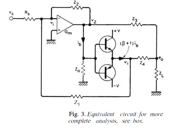

L1 has no real effect on the amp bandwidth. The L1/R3 ratio determine the feedback ratio and thus the gain, and you wonder what happens with increasing frequency when the L impedance rises. But look at the other branch of the bridge; the C is juxtaposed and it's impedance will decrease with frequency, so the bridge balance is maintained over the whole frequency band! And as can be seen in the calculations, bridge balance will ensure that the dumpers' gain variation (which is its distortion of course) is cancelled out.
BTW the C in the bridge does double duty as the miller compensation cap for the class A driver amp.
This is one hell of a smart circuit! It is very hard to understand intuitively (or at least for me it is). I had to work through Walker's original article and the critique by Lipshitz and Vanderkooy several times to start to understand what's going on there!
Jan
Yes. Please indulge me, I love this stuff ;-)
Assume the dumpers are off. Then there is no signal across Z4 and the feedback through Z1 sets the gain.
Now assume the dumpers conduct. The dumper current creates a signal across Z4 which increases the feedback through Z1 which decreases the current output from the Gm stage*. This decrease in current is - with bridge balance - exactly the same as the increase in current from the dumpers. So the system gain does not vary whether the dumpers are on or off, so any irregularity in the dumper gain does not impact the system output!
The second stroke of genius was making Z2 a capacitor which then doubles for the miller comp cap, and then make Z4 an L to maintain bridge balance over frequency.
* The class A driving amp is a transconductance stage which provides output current, not output voltage.

I played around with a version of this concept during my linearization studies last year (minus the clever compensation networks). Omitting the compensation, this is similar to the emitter follower enhanced Sziklai pair shown in Art of Electronics X Chapters (p127). One difficulty I faced is that every time I put in local current limitting, it passed the current limitting problem upstream. So I had to add more reverse polarity and current limitting to each section than I anticipated.
On the other hand, one great thing about the concept is that during normal operation it does not pass base currents from the output stage upstream. I found that the local floating VBE linearization concept I was proposing elsewhere provides about 20dB of benefit before the non-linear base currents pass through enough to cause their own issues with VAS distortion. I think these concepts could be combined to provide amazing overall output stage performance.
I will have to work harder to analyze whats going on with all the feedback paths. Is the connection back to D1/D2 from the output a feedback path, a feedforward path, or maybe a bootstrap?

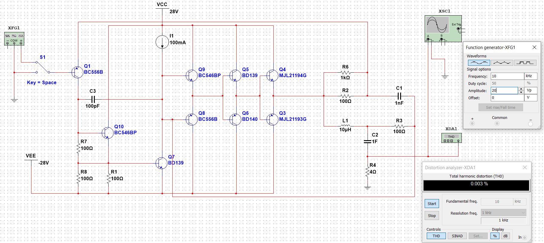

I have done lots of simulations. My observation is that the THD with "Current Dumping" configuration is much lower than a "Blameless" style Class AB with the same idle current. Almost 10dB lower on average.
PS: The "idle current" of the "Current Dumping" amp is the current on Class A portion. The Class B portion has No idle current.
I think the reason is that. In "Current Dumping" configuration, the Class A portion is some kind of bootstrapped by the Class B output stage. The Class A portion never runs out of current. Thus, the Class A stage works the whole cycle of the sin wave. That is the major difference than a normal Class AB amplifier.

"Deep Null" is hard, even in the simulation (for me). When I get "Deep Null", the THD is around 0.001% or near -100dB @ 10KHz in the simulation.
However, I find it is relatively easy to get "Mostly Null" with 2% tolerance parts. The THD is around 0.003% or -90dB in the simulation.
On the nulling bridge, for resistors and cap, you can get 1% tolerance parts easily; For the inductor, I believe you have to make by yourself, a good LCR meter is helpful. 5% tolerance is good enough.
You also need to include input stage transistor's re into your bridge. I find it will mess up the balance of the bridge a little bit. To get away this, use CFP (Sziklai pair) as input stage instead of single transistor. With CFP, the equivalent re is beta times smaller as that of a single input transistor.
Depends on your goal, for me, I won't bother to fine tune the bridge once it is built.
