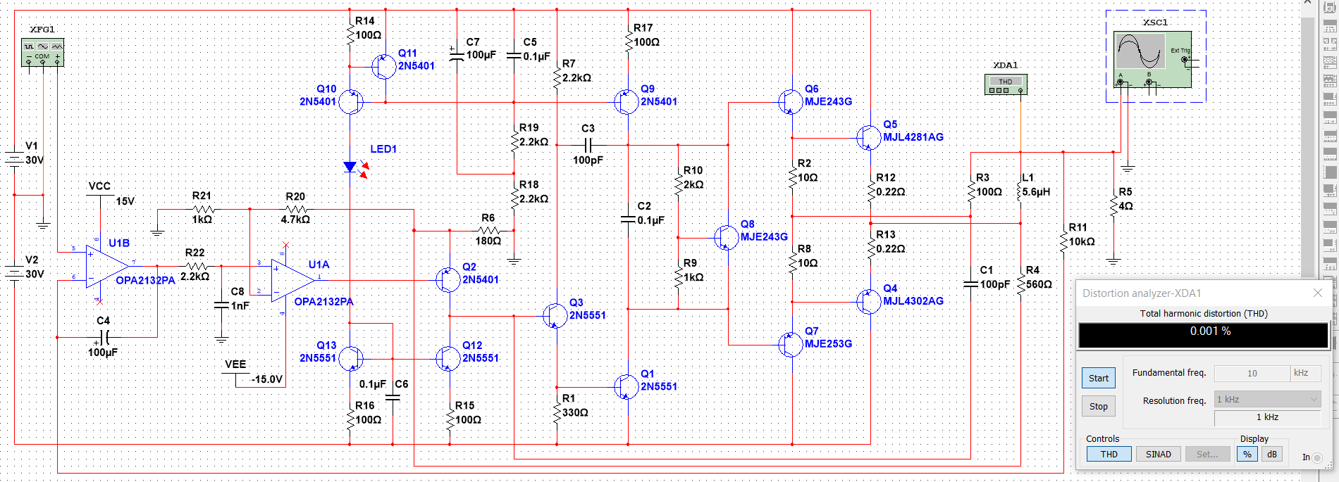

Here is the design for my future reference.
THD 0.001% at +-23Vpp into 4 Ohm.

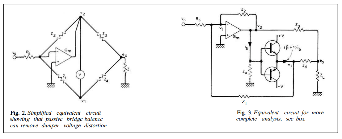

That's part of it, but that in itself is not what Quad called current dumping.In short, it combines a small current Class-A output with the final output stage
Where are the bridge components in your circuit? Is L1 part of the bridge?
Jan
The bridge: L1, R3, R4, C1That's part of it, but that in itself is not what Quad called current dumping.

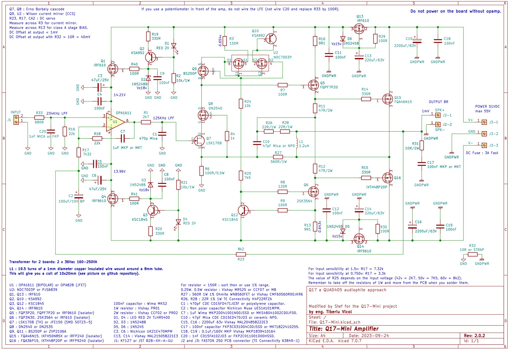

Thanks for sharing Q17. Last time I saw Q17 schematic was years ago. It may make sense to use mosfet in the input and vas stage for high voltage gain and simplicity.Hello,
Look at the Q17 project if you want to get ideas for a complete current dumping circuit. You can do the same with bipolars instead of MOSFETs. It wouldn't be bad to compare. 😉
