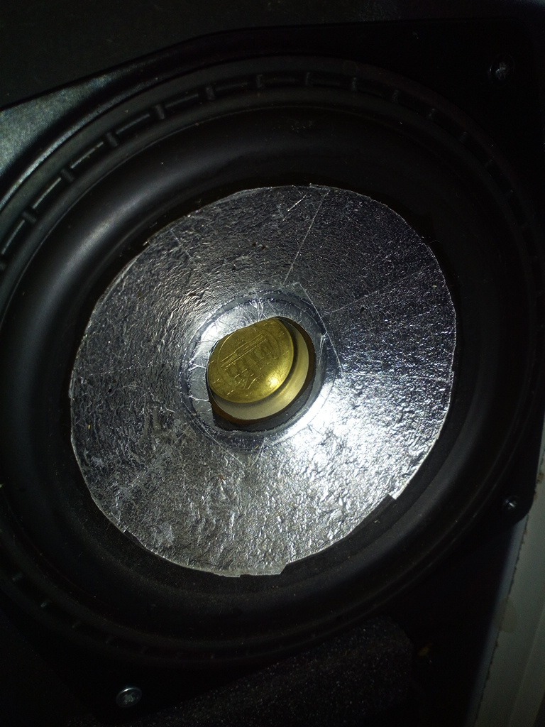

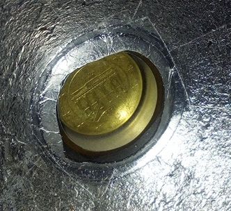

You can put on any fullrange driver a copper ring after removing the dustcap. I call one modification the "50 cent trick". So you can do a listen comparison (or measurements of any type) after modifying only one driver and then take a mono recording and using the balance knob to compare both drivers just only showing this one single difference - with or without this 50 cent piece:
https://www.diyaudio.com/community/...n-to-current-drive.389985/page-6#post-7197710
If you use a copper ring on the pole piece you immediately hear the difference in sound - less distortion, more highs, clearer sound.
You can also use a copper ring - not a 50 cent euro coin

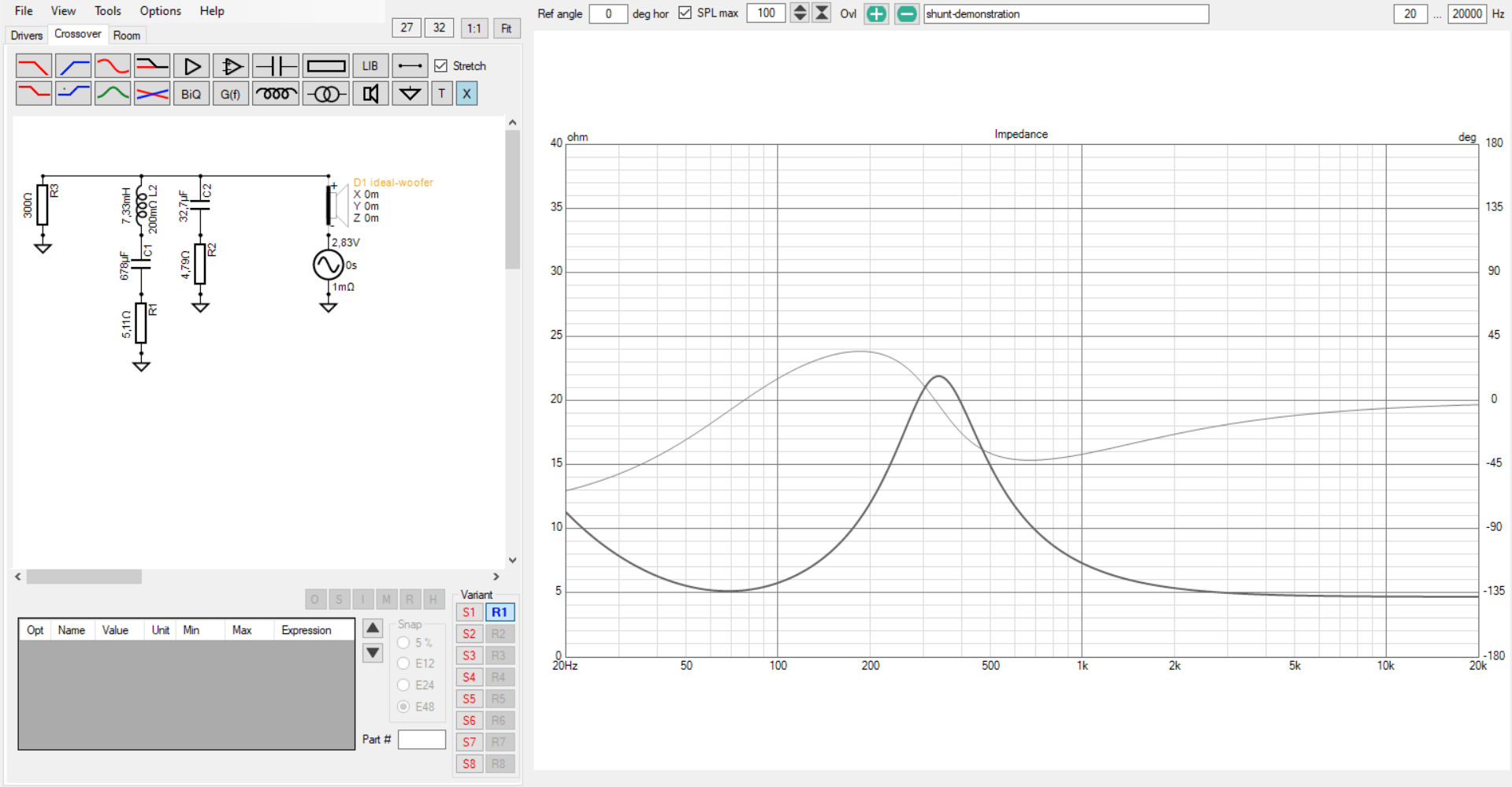

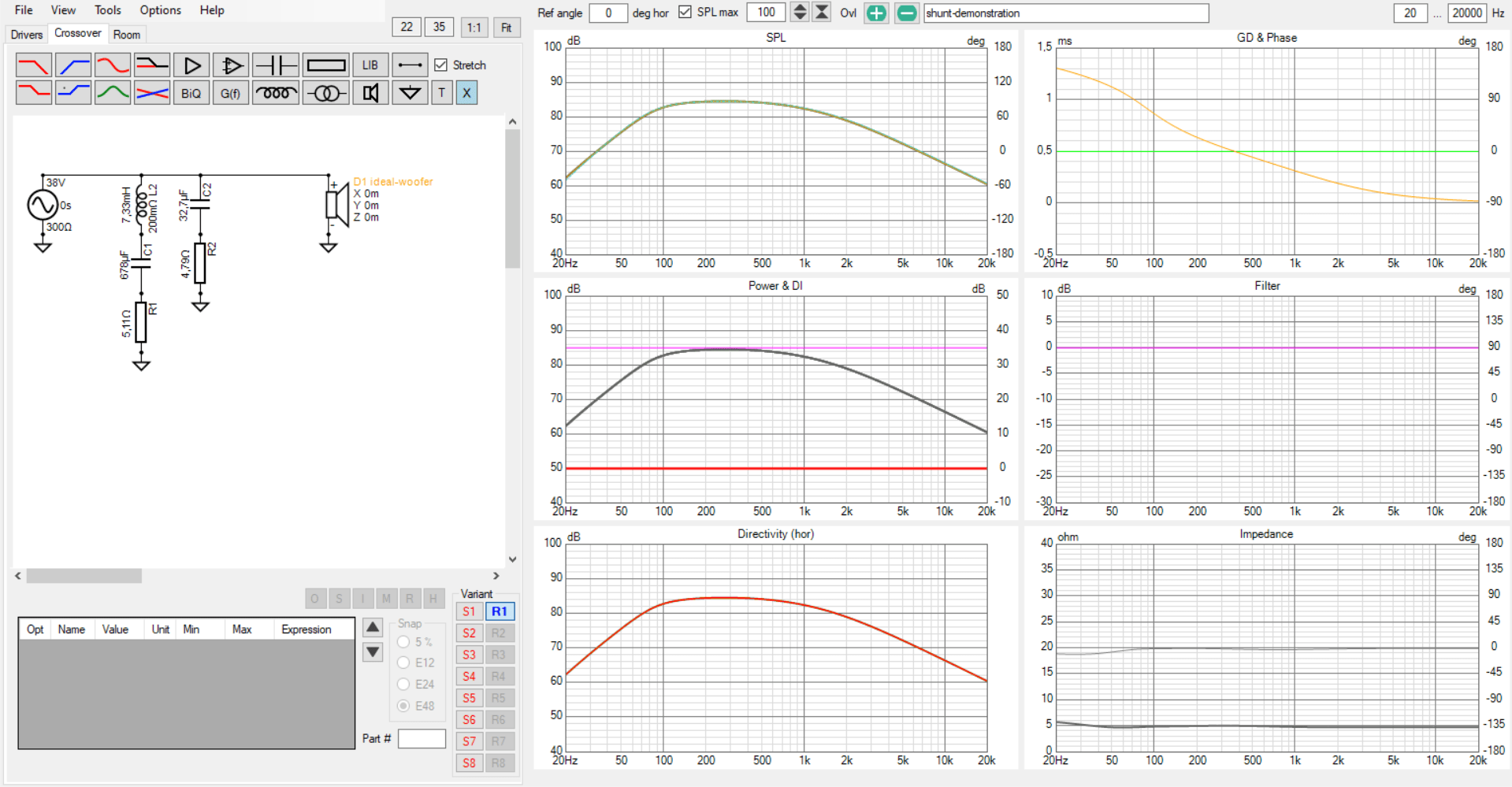

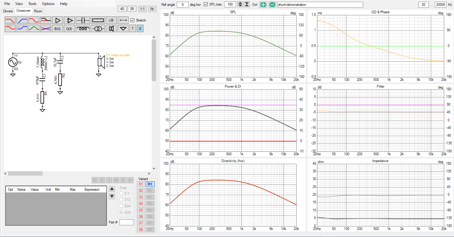

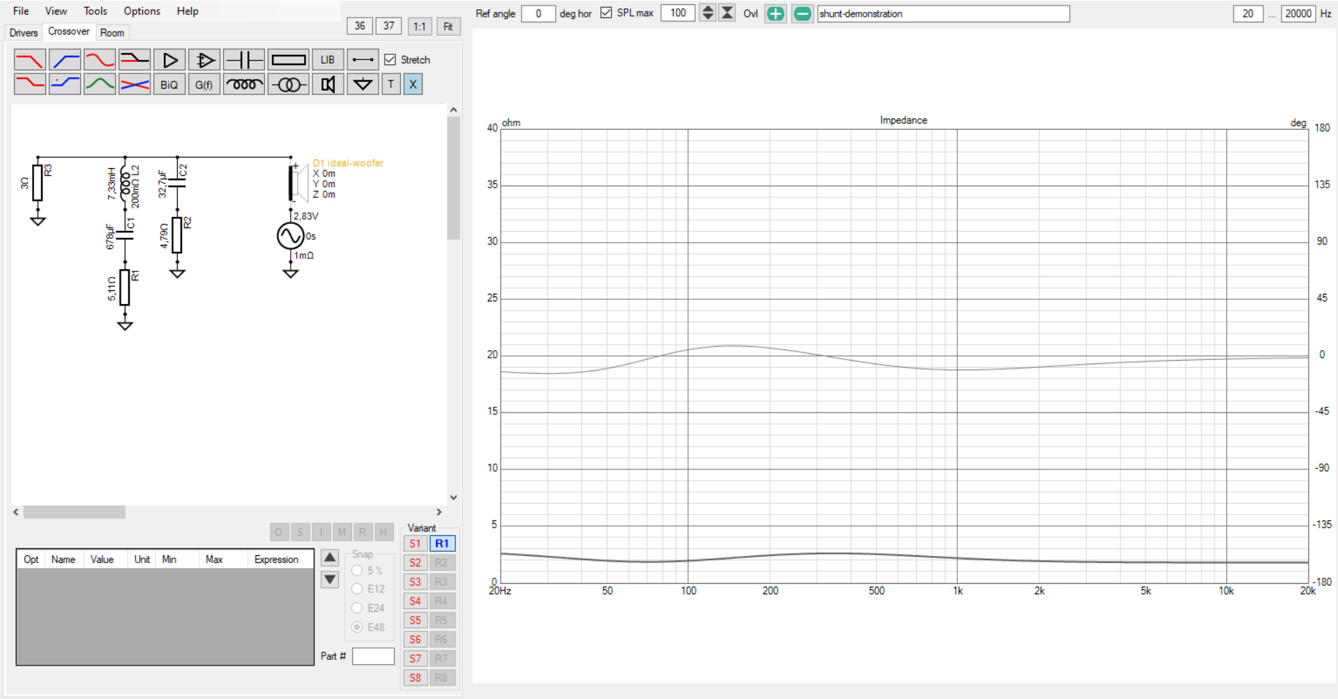

On multiway speaker one must accompany such high output impedance amplifier speaker system with DSP or suitable drivers, because if one has to use passive network to straighten frequency response it will shunt the Ro and reduce benefit of current drive. It doesn't matter if its 50 or 500ohms output impedance, if there is few ohm zobel and conjugation networks in parallel. One could use regular (voltage) amplifier and try to increase series impedance when possible, to get almost the same result without trouble, and burning power.
Example:
Shunts enable to maintain acoustic frequency response no matter the amplifier output impedance. Here with 3, 30 and 300ohm Ro.
Inspecting what the load is for driver by replacing the amplifier with equivalent resistor, to estimate how much current backEMF can make, thus distortion:
3ohm-Ro-impedance-for-backEMF.png30ohm-Ro-impedance-for-backEMF.png300ohm-Ro-impedance-for-backEMF.png
We see the driver load is less than the Ro on all these cases, because the shunts are in parallel with it. In this example, 30ohm Ro without any shunts would provide more distortion reduction, "more current drive", than 300ohm Ro with shunts.
Shunts can be left out only if the speaker was designed for high circuit impedance and to have flattish response without them. Or, use active EQ before amplifier.
