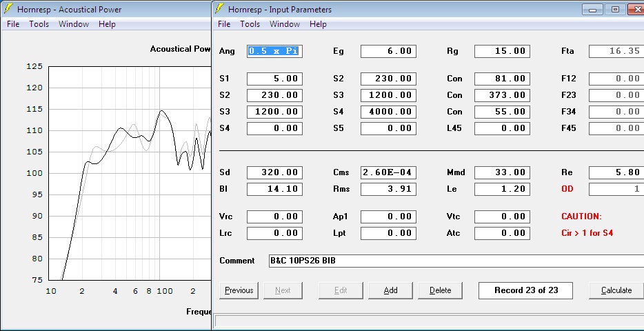

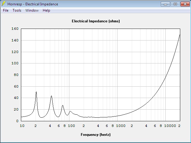

Have you got Impedance curves for your BiB?
I am sorry, but no actual measurements. The best i can do is Hornresp simulations.
This is my BIB as it is built (within a couple of centimeters).
The last section of the horn (L34) is the the corner-expansion outside the actual horn, crudely measured/guesstimated with a with a yardstick. It is not very exact but it is a better representation of the actual horn path and expansion then if omitted. It is much nearer actual measurements of the spl-response, then only the actual horn simulated without the corner expansion is.
Grey line is with normal voltage drive. Black line is with 15 ohm series-resistance. If designed for currentdrive i would have built a much larger BIB, simulated with 15 ohms or higher Rg.
My BIB sound best with 6 - 10 ohm resistance. They lack some of the deep bass with to high resistance.
