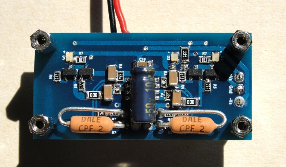

The SHPP Transconductance
Refer to the wiring diagram for the SHPP in the description pdf.
You should permanently solder a pair of 2W 10R resistor between S & O (see photo).
Connect 50R dummy load between S and G.
Connect both G to 0V of the aux supply (+/-24V) (for testing only).
Then connect a 1k resistor to S.
Apply a functions generator with 5~10V sine wave at 100Hz with initially 0V DC offset.
Nothing should happy, and the relay show go on after a slow start delay.
Increase the DC offset of the func gen slowly, to about 1.06V.
The trigger should then occur.
This then corresponds to a DC current of 1.06V / (1k + 10R + 50R) ~ 1mA.
The AC signal should have no effect when DC is not present.
Check DC offset in both directions and for both channels.
The SHPP Trans is primarily designed to work with SL Trans in current mode only.
In principle it can work in both current and voltage modes.
But the 10R current sensing resistor in the SHPP will increase the Zout by 10R.
AND you need to limit the power supply current to 300mA in the regulators.
When the SHPP Trans triggers the amp is loaded by Rs only and hence you must have current limit somewhere.
The other simple way around is to change Rs to 5.1R, and accept 2mA DC current (0.1V DC for 50R load).
Then the current limit of 600mA is still OK.

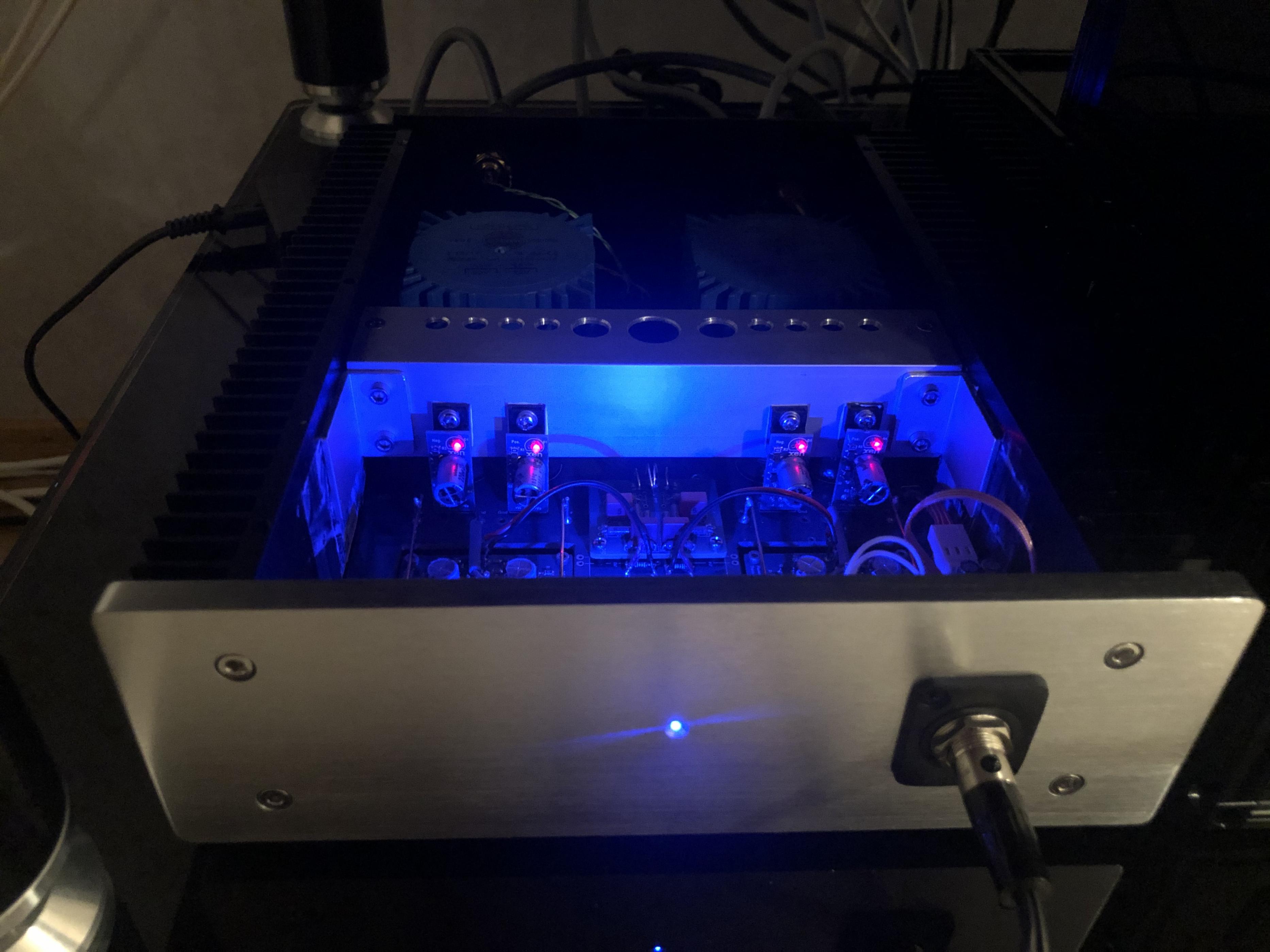

I’ve had the pleasure to enjoy the Super Linear Transconductance headphone amp for many months now since Patrick kindly sent his build for me for listening test. During these few months it has proven to be an excellent companion for my Audeze LCD-2 (phazor) planar headphones.
The SL Trans is now my new reference headamp so it is highly recommended if you happen to have planar headphones to pair it with.
Actually I like it so much that I refused to send it back to Patrick...😀
