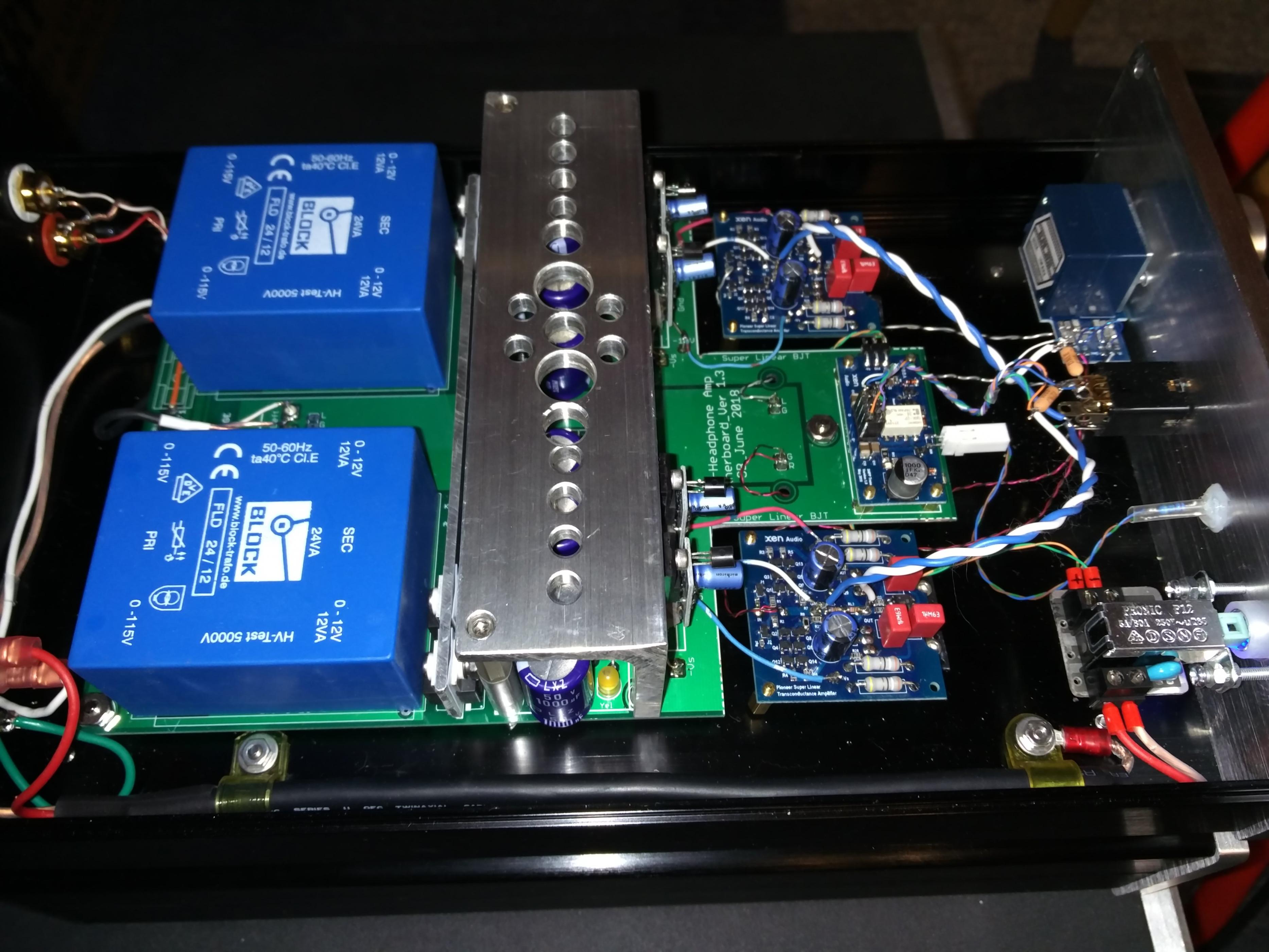

The circuit was also successfully built by a Beta tester, who used the version with DC servo.
In any case, it is still recommended to use a protection circuit, especially when this is non-invasive.
All listening tested were using planar magnetic headphones, HiFi-Man HE500 & HE-400 respectively.

Hi. I was the Beta tester 😉 and here my experience with this other great design from Patrick (EUVL). This design was interesting for me because at the time I just got a nice pair of magnaplanar HiFiMan HE-400 headphone and was using them with the Xen Audio Pioneer Ultra linear headphone amp, with excellent results. Patrick asked me if I like the HE-400 with the his amp, and I answered, Yes very much! He told me that even if the Pioneer Super Linear was a great amp, the magnaplanar HP could be driven with even better result with a current amplifier, not a voltage one, as the Pioneer, and guest what! he had a design that he wanted me to try. I was in!
To make a long story short, my time as a beta tester was a short one, because out of the box Patrick design worked like a charm. I must confess though that I missed the time to fully tried all function, such as the voltage mode adapter, in part because I already had the nice Pionner Super Linear (voltage mode), and I was pretty busy at the time with other projects. Also I used my extra parts inventory from the Pioneer project to build this amp. The small smd transistor were not as perfectly matched as the previous project, and I was not sure if the amp would be as well balanced, so I used the servo from the start. Other can certainly comments on the kit others features if they have more time than me. Here the final result
As some others members can see I'm using my own motherboard design for this built, see the original GB for detail: GB for Pioneer Super Linear Motherboard
If there is enough interest with this new project, and if Patrick doesn't offer his own motherbaord option, I may run an other batch, we'll see.
So this project is a breeze to mount. For better results you'll need Xen Audio great discrete regulators, and the little protection pcb is a must, because this amp has a large DC swing at start-up.
Also take note that the amp, in current mode can be use only with a magnaplanar headphones. For other headphone type, simply use the voltage mode small pcb adapter, to convert the amp to voltage mode. The protection circuit can protect with the both mode, see the excellent documentation for details.
So in my view it may be the perfect headphone amp, can probably used with all the headphone out there (naturally not the electro static ones, as Stax). and sound just great, here my listening impressions:
I replied to Patrick with this simple comment: Well this amp may well be my last headphone amp [not with tube 😉] that I ever build, it is so good...
With my HifiMan the sound is gourgeous, huge bass, mids to die for, crystal clear highs, and the speed, the speed! As they say in the UK, Lovely...
This latest Patrick's design is very recommended. Thanks Patrick for sharing.
