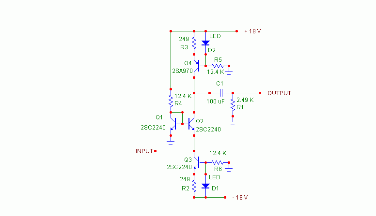

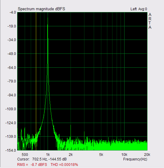

This picture are the distortion of a single-ended common base like the one Calvin use, connected to a single output of a PCM1794 at -1dB .
this is a very simple circuit than only uses 2 npn transistors and 2 jfet as ccs, the current that passes through the circuit is only 15mA.
The distortion is only 0.00018%
There is no problem with the d.c. bias as this is a single-ended circuit and it has a output capacitor.
Even such a simple current conveyor can outperform the 0.0004% distortion from the PCM1794 datasheet.

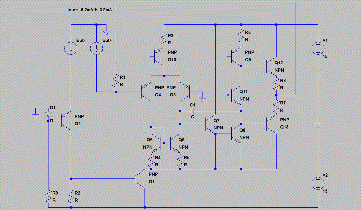

This pictures are from the same current conveyor as the one from the post above, and also with -1db, but this time with a resistor in parallel with the output of the dac chip, to simulate a DAC with lower output impedance, the first is with 1000R and the second 220R the distortion is much worst and even with a 10K resistor the distortion is now 0.0015%
As we can see from this, simple solutions like single-ended common base are not easy to implement in chips like the ES9018 that has a output impedance lower than 200R.

Yes, every circuit has inevitably drawbacks and requires compromising.
And also yes, that in principle it is good, THD-wise, to keep the percentage of signal swing as part of Bias small.
In qusp's thread where a single MOSFET were used in a common gate arrangement, they got impressively low THD values running the FET on 75V/300mA (afairc).
The common base circuit I used ran on ~10mA and +-15V, fed by the -3.5mA+-2mA of a PCM1795/96. A PCM1794 required slightly more bias, but still <<20mA. All values low enough to allow for SOT23 or similar SMD casings.
The THD performance is admittedly a bit sensitive to bias settings, and also to the DACs output impedance. For lowest THD the source impedance should be high.
I kindly disagree about the current conveyor beeing inferior with DACs featuring an offset current like the AD1955 or TI's PCM179x series.
With symmetrical complementary current conveyors one needed a dedicated current source/sink to cancel the DACs centre current.
But this is not the case when You go single ended as with the 4 principle examples shown before (see the current labels, e.g I1=Idac+Iq1).
First sims I did yestday showed that THD decreased to <-100dB when Q1 of the common base circuit were replaced by a CFP. (PCM1795/96, 0dBfs, 1kHz, 2Vrms output, +-15V supplies, ~11mA at idle, Zin<1Ohm with sufficient bandwidth).
I don't see any practical advantage going more complex from here, apart from adding a buffer of course.

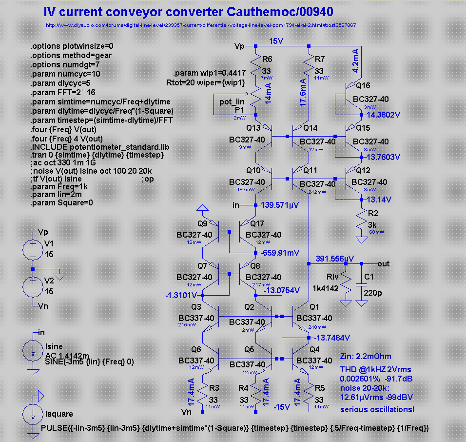

BTW. similar to Sergio I don´t understand the complexity of Your circuit. What are Q9/Q17 intended for?
Do Q10/11 really improve signal quality/THD here?
The current through the ´cancellation transistor´ Q7 needs to be constant.
A simple resistor or a simple CCS may suffice here. Why do You employ a current mirror? Compare Your circuit to the SE-Bakuun of #17. Adding a ccs towards Vnegative and connect Riv to gnd instead and You see a simplified NPN-version of Your circuit. Maybe I´ll CFP it and sim that for comparison too 😉
I think i have made a bad choice of words, I think the circuit is to complex for the PCM1794 , but nonetheless it is a very smart circuit, and can be very usefull for low impedance dac chips. why ?
well , the most interesting caracteristic of the circuit is the use of a error correction mechanism , the current mirror formed by Q5/Q6 will mirror the current that passes through Q17/Q8 in Q7/Q9 , so Q7/Q9 Vbe variation will compensate the Vbe variation on Q17/Q8, this will make the input impedance very low.
ofcourse the error correction loop will work without the q9/q17 transistors, but they form a circuit like the wilson current source that has a feedback loop that also help to lower the input impedance of the I/V converter.
(Q10 / Q11 / Q12 ) and ( Q1 Q2 Q3 ) only serves to make the Vce of the current mirrors low , to increase temperature stability.
The distortion mechanisms than one has to deal in the case of the PCM1794 is the early voltage distortion and the none linearity parasitic capacitances, and that circuit do a poor job in that department.
By my experience in error correction loops, I am almost certain that it needs compensation in the EC loop.
Hope I was clear enough, this time 😉

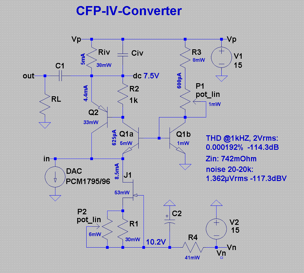

simmed the circuit from #18 for +-2mApp -3.5mAdc (PCM1795/96) and 2Vrms fullscale output.
THD@1kHz: 0.0026% -91.7dB
noise(20Hz-20kHz): 12.61µVrms -98dBV
Zin: 2.2mOhm, rising >100kHz
Serious oscillations even with Civ. Not useable wthout compensation as in schem.
As with all aktive loads (be it CCS, folded cascode or CM) noise is quite high.
Output nulling reacts quite sensitive on trimming.
Zin is very low and linear up to >10MHz
The current conveyor transistors need to take the DACs centre current - run on high idle currents.
A complementary circuit would place the burdon on the current source transistors instead.
For the same conditions the simple CFP current conveyor sims far better.
It offers lower THD, lower noise, lower part number count/effort/cost and lower power consumption.
No difficulty in dialling into dc-bias and input-null points.
Merely a slight overshoot than tendency of oscillation.
Zin is higher but linear and low enough to not cause trouble with highimpedance output DACs.
JFET CCS provides for lowest noise of all CCS here.

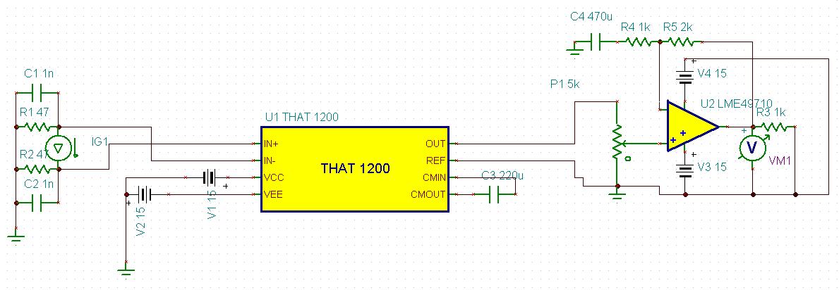

how is this circuit.
OPA is PNP or PchFET IPS ,and miller compensation VAS, 4558 or similar architecture one.
common base IVC 's output voltage swing is in-phase to OPA output.
bootstrapping OPA's -rail with it make the OPA's VAS like "differential receiver".
it helps the OPA's slew rate.
