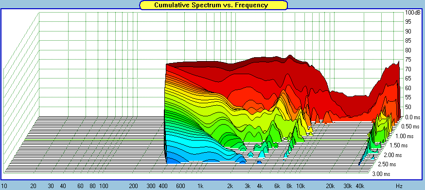

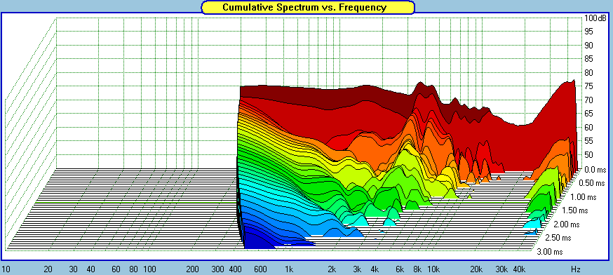

I wasn't going to go into this detail originally, but looks like I will. First what does really CSD show? Most people are looking at its horizontal slices, since the computer spits out horizontal slices, and the descriptions of how the algorithm generates it tells that it is a repetitive frequency responses (the horizontal slices) with increasing start time of the impulse response window. What most don't know and ignore, is that CSD is meant to show the time decay envelope of the system on an infinitely going on sinus response that is suddenly ceased. And this is meant to be corresponding to the vertical slices of the CSD. For instance the vertical slice at frequency = 1Khz on a CSD , is a calculated envelope of the time response of the system when it had been fed with a 1Khz pure tone, and at time =0 the tone is stopped. That 1Khz vertical slice shows the envelope of the decay. So, that is the starting point of CSD, and that is what is it supposed to show and looked at. The horizontal slices seems to take more "press" 🙂 I think because it is easier to generate the 3-D data by generating the horizontal slices rather than the vertical slices.
So in that light, and using one of the CSD's posted earlier in this thread, which I took a section of it and posted below, I will try to show how "parasitic resonances" occur, and why they are already in the FR as problem regions when driver is minimum phase.
These often are the result of deep notches in the frequency response. At the attached picture (if I got it to attach correctly), I tried to mark to vertical slices as example. First the one at around 500Hz, there is a dip, and dip goes deeper, and then it comes back as a ridge. The second one is there is a severe and narrow dip at 900Hz, again it is initially a dip valley, then starts to come back and becomes a ridge. Note these are both related to FR shape, they just become a ridge later, but both are related to dips in the FR. And the narrower the dip the more pronounced this initial dip and then ridge occurs.
Let's look at the 900Hz vertical slice and try to explain what is going on. As I said above the vertical slice is supposed to give the decay envelope. So looking at the 900Hz, the driver has been excited with 900Hz pure tone for a long time, and at time = 0 it is stopped. First just as time = 0, the amplitude of the driver output by definition is its value at amplitude FR, since the signal had been applied for a long time, it is the steady state amplitude of the response to 900Hz. And before time=0, the signal was pure 900Hz, since it was a long going (infinite) 900Hz tone. But just after t=0, signal is stopped. What is that signal? It is no longer a pure 900Hz tone. If it was it would still be playing till plus infinity at 900Hz. Because the signal is stopped, now new tones are present in the signal besides the 900Hz. And when we look at the FR of the input signal (which is an ongoing but then stopped 900Hz signal), its spectrum contains components not only at 900Hz, but a lot of others around 900hz, which decrease in amplitude as moving away from 900Hz. That all means when the signal stopped at time = 0, the rest of the response of the driver (the decay response) will be mostly determined by the FR by the close neighboring region around 900Hz. And that is why the narrower the dip, the more this valley and peak shows up in the CSDs. As I said the input signal contains sine componentts populated around 900Hz. The one at 900Hz cause a small output because there is a dip at its FR, but the neighboring ones don't because their FR amplitude is higher than 900Hz. As a result the decay envelope shows up like that. Nothingn to do with harmonic distortion or nonminimum phase behavior, all can be explained and demonstratable with linear and minimum phase behavior.
And the important part is, the bad behavior that shows up in the CSD, is easily traceable to the amplitude FR plot, to narrow dips. As much as a sharp peak is indication of time domain problem, a narrow dip is also. Any deviation from a smooth flat amplitude FR results in problem in time domain.

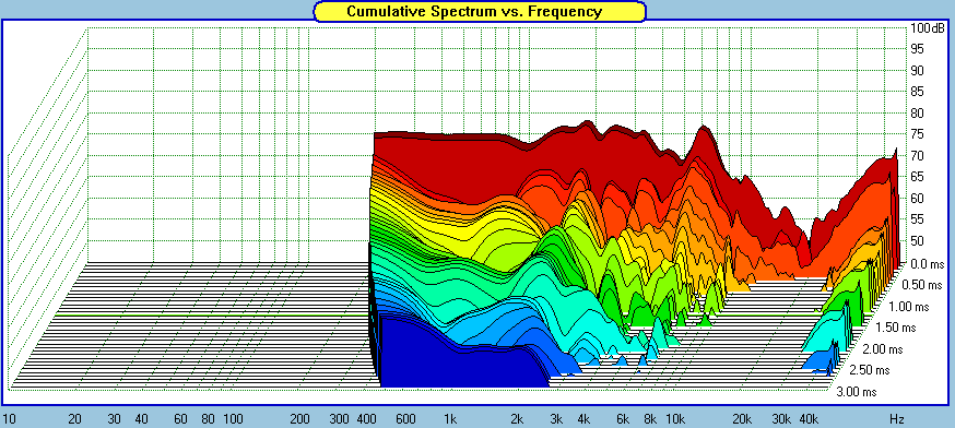

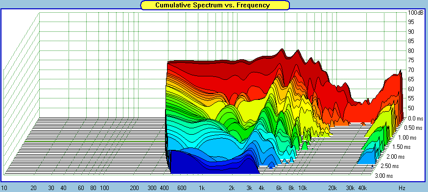

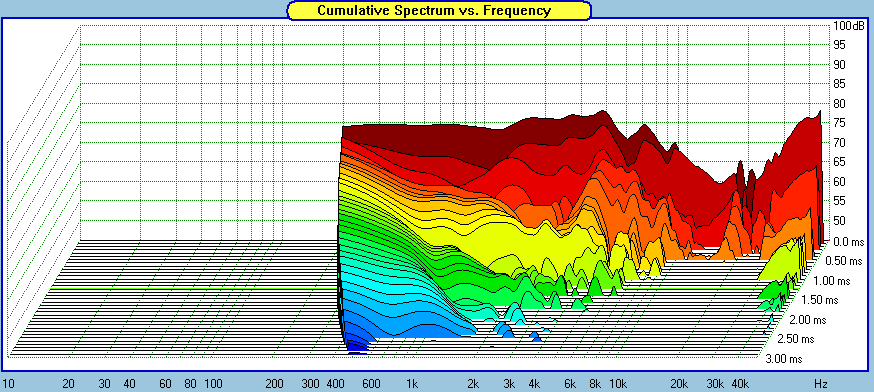

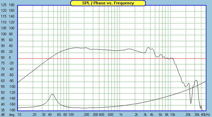

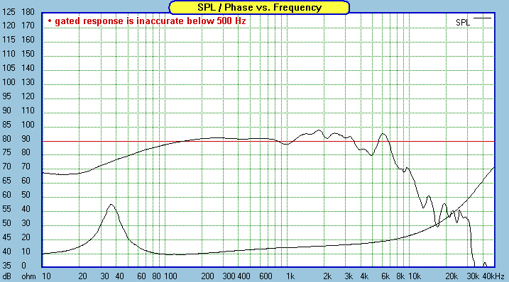

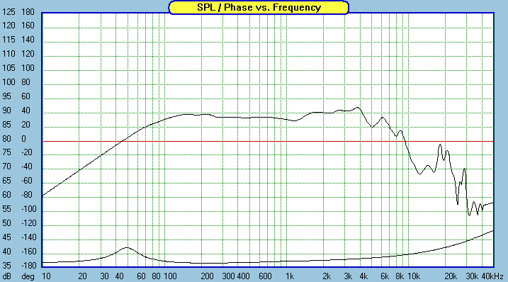

Here are the CSD of the frequency responses that I posted earlier. These are the ones everyone was afraid to comment on and no doubt now will get responses about contamination of the measurements, blah, blah, blah. Can't trust his measurements...
First they could read the stored energy in the frequency response, but after it was posted they wanted to see an impulse response and one guy even asked me if I could e-mail the file to them so that they could see the CSD and then comment on it. How funny is that? Put them to the test and they want to see the answer first.
Anyway, see if the stored energy is where you thought it was or if the magnitude of the stored energy is what you thought. Some were pretty obvious but still no comments were made.
Here were the two questions asked:
1) In each graph what area has the greatest amount of stored energy?
2) Of the three graphs which woofer as the greatest amount of stored energy and where?
Say whatever you want to now. It doesn't matter. The results were just as predicted. No comments were made.

This one (below) was good. It was rather obvious and I hoped someone would at least catch that part.
The red and blue curves have the best energy storage below 1k.
But then you basically said the same thing about the green one too.
The green will have energy storage issues below 1k
And you obviously missed that one.
The sharpest thing you said was this:
Second, a nearfield measurement, while helpful below 1k, has to be interpreted very carefully above 1k due to the interference nulls that will occur that aren't really there.
This was very correct and this issue is clearly present on two of the curves.

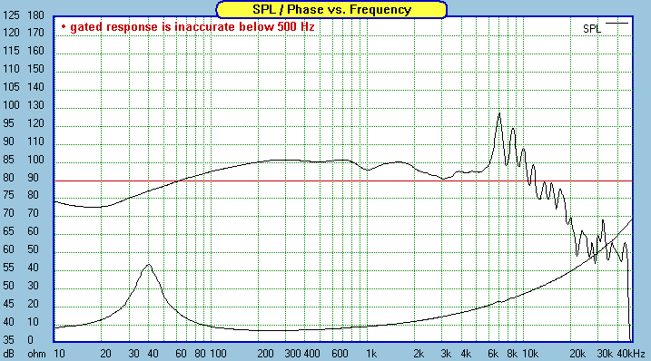

What if the metal cone driver would have looked like this one?
Even if the crossover were steep enough to get rid of some or most of the break up in the upper end, it would still have quite a bit of stored energy below 3kHz where it would be used. You also wouldn't know from this drivers frequency response that it had excessive stored energy below 5kHz.

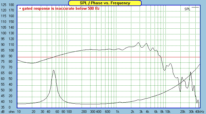

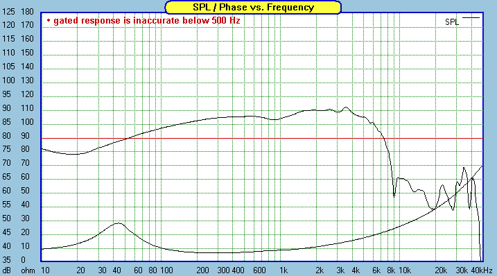

It is hard to see without a phase plot (which is unecessary if the system is minimum phase) but is the "Blue curve" in Danny's examples above minimum phase at the zero(s) near1.8kHz?
Result of the narrow deep notch and not necessarily an indication of nonminimum phase behaviour, already explained here:
http://www.diyaudio.com/forums/showthread.php?postid=1273682#post1273682
Since you brought up, notice the original smoothed FR curves for those didn't show those narrow notches. But they would out of mysterry would show as ringing on the CSD's, and then a claim could have been made that "see nothing relating to FR but the CSD shows the ringing" if the unsmoothed FR plots weren't requested here🙂 And seeing (or foreseeing) this, why would anyone answer to a challenge which the question was ambigious to start with: which driver has most energy storage. How do you quantify energy storage of a driver. You can't do it without reference to frequency, because it is not just about time to decay, it is about how many osciallations it takes to decay. Response diminishing after 5 oscillations at 200Hz has same stored energy problem as response diminishing after 5 oscillations at 2Khz, but one takes 25 msecs, the other 2.5msecs.
]Originally posted by DannyYou also wouldn't know from this drivers frequency response that it had excessive stored energy below 5kHz.
What determines "excessive" stored energy? That is my point in the above paraghraph in this post. Your point of quantifying energy storage is different from mine, and from probably others here. Why would anyone answer your challenge, when your interpretation of the answer will be different, or suspect of your interpretation? And also I have posted twice on this thread before that that driver's FR is not so smooth below 5Khz, and it is no suprise that CSD will show up like that below 5Khz.
