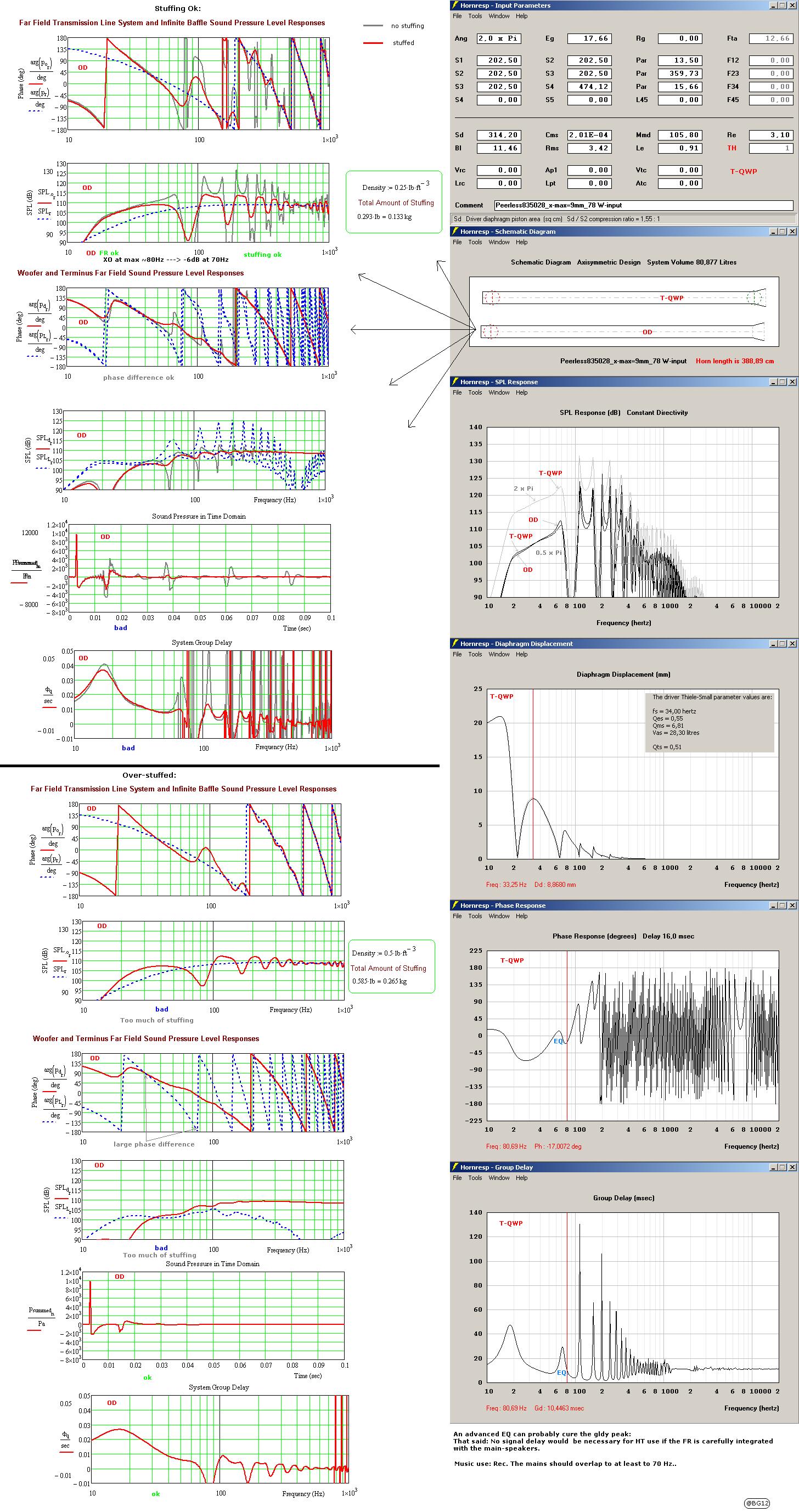

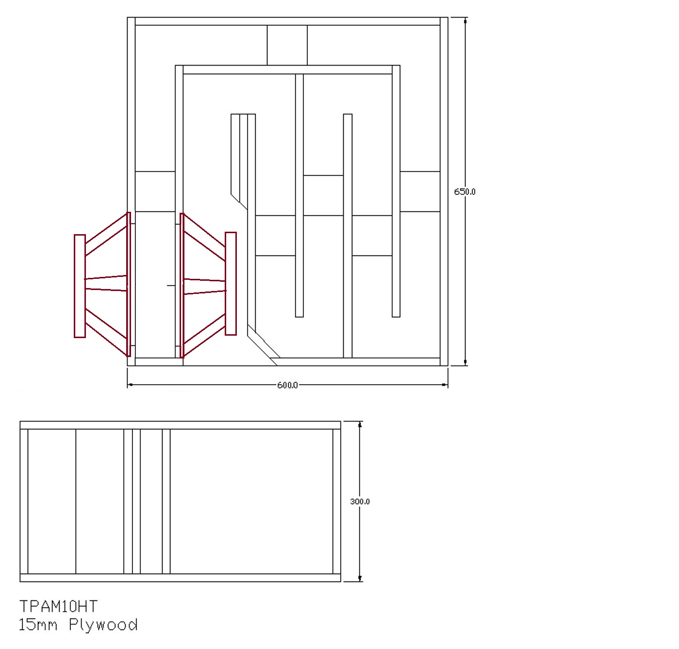

Perhaps this might be of intrest ?
Martinsson's Blog - TPAM10HT

Thnx Martinsson, I've seen it mentioned before but never saw the details about the TPAM10HT.
It's interesting to see the sims for the two different drivers.
Sort of similar response even though the drivers differ 10dB in sensitivity.
It's small and it covers the 20-80Hz area. It would probably do the trick...
Thnx. 🙂

No problem markusA, I'we sofar only gotten one report back on this one, from thailand i think it was, the user was very pleased with the size to output ratio, and the 20Hz perfomance.
A friend of mine here in Gothenburg is about to build one for himself within short, and will follow the development closley, seeing as I have not built this one myself, yet.

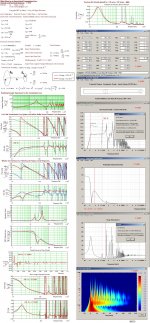

Hello B.
Such bass horn can be considered as quasi infinite so here attached is a relevant hornresp record to simulate the horn.
Best regards from Paris, France
Jean-Michel Le Cléac'h
