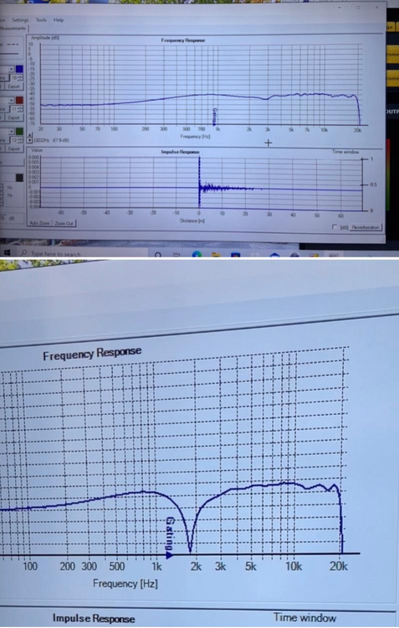

This response is separated 100hz [24db LR] in each direction:
