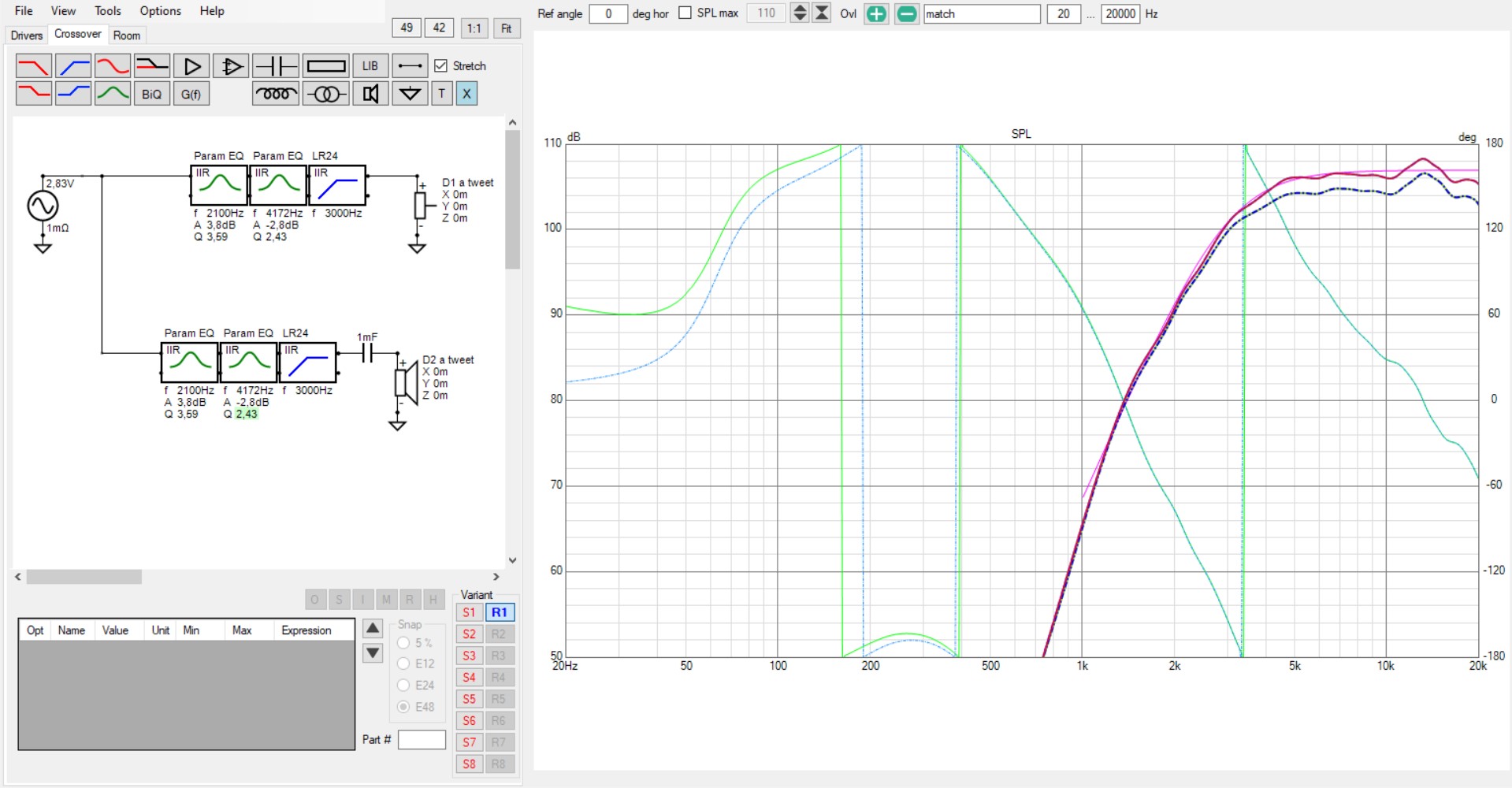

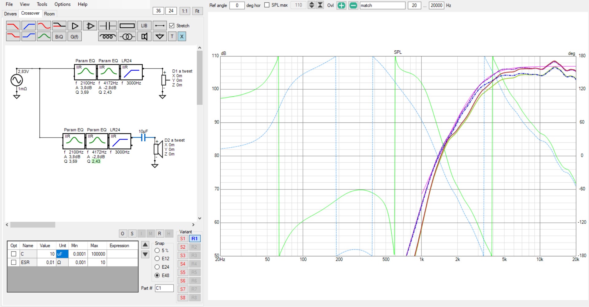

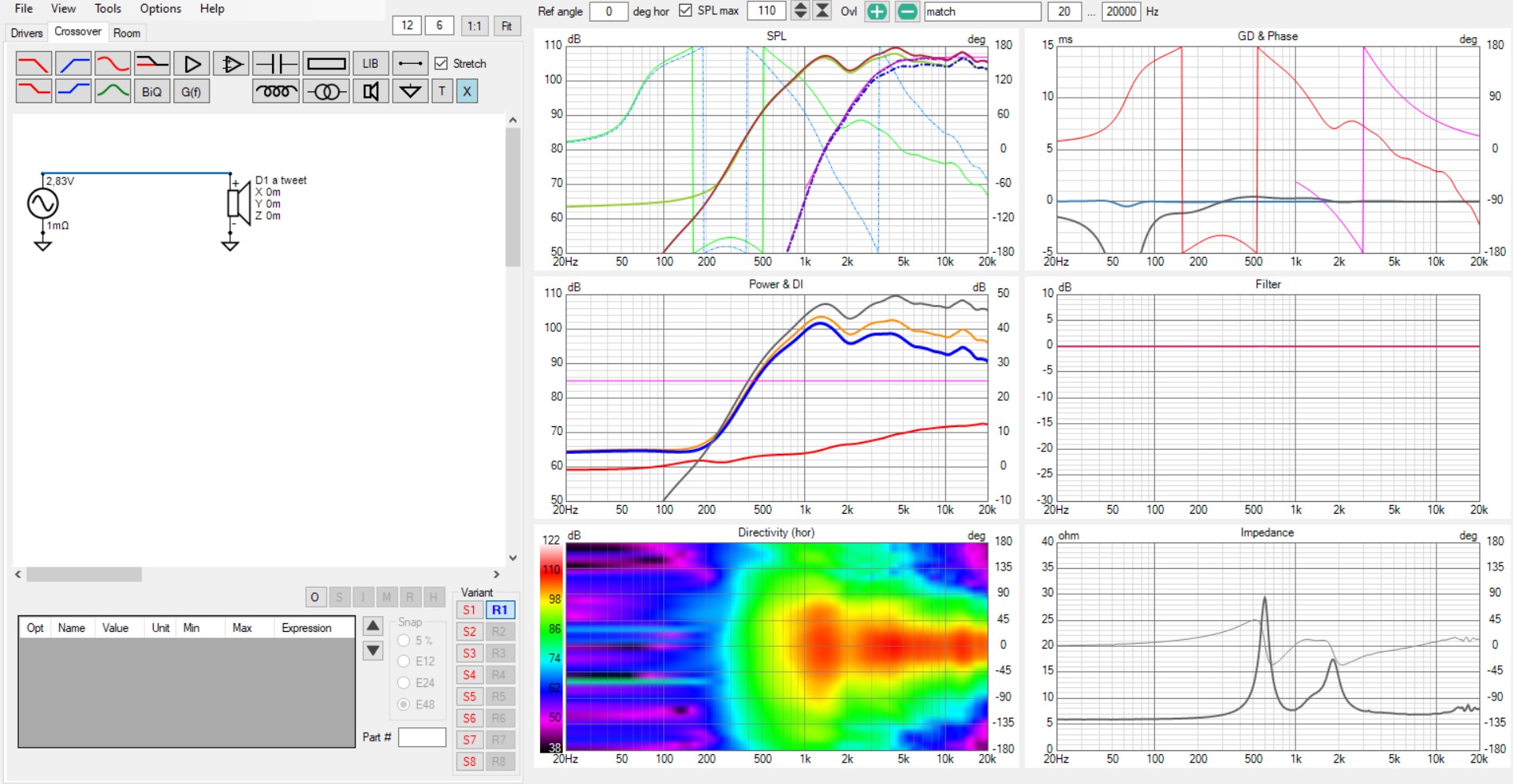

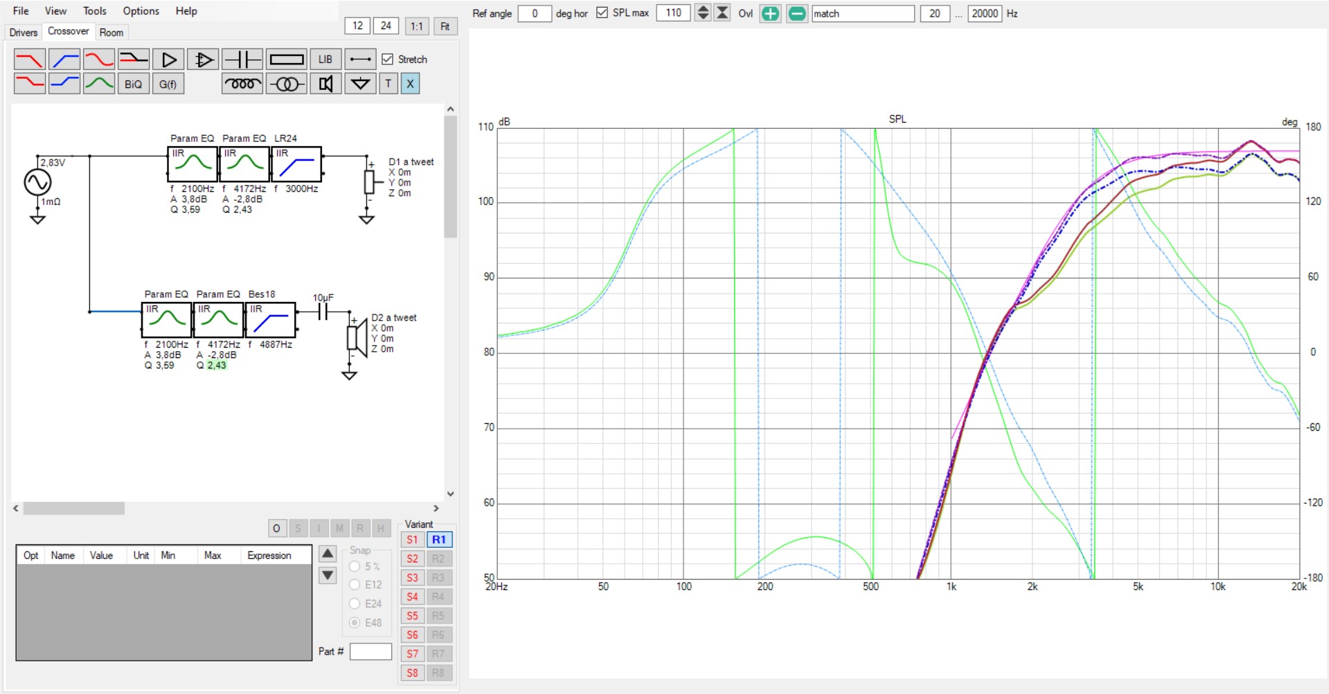

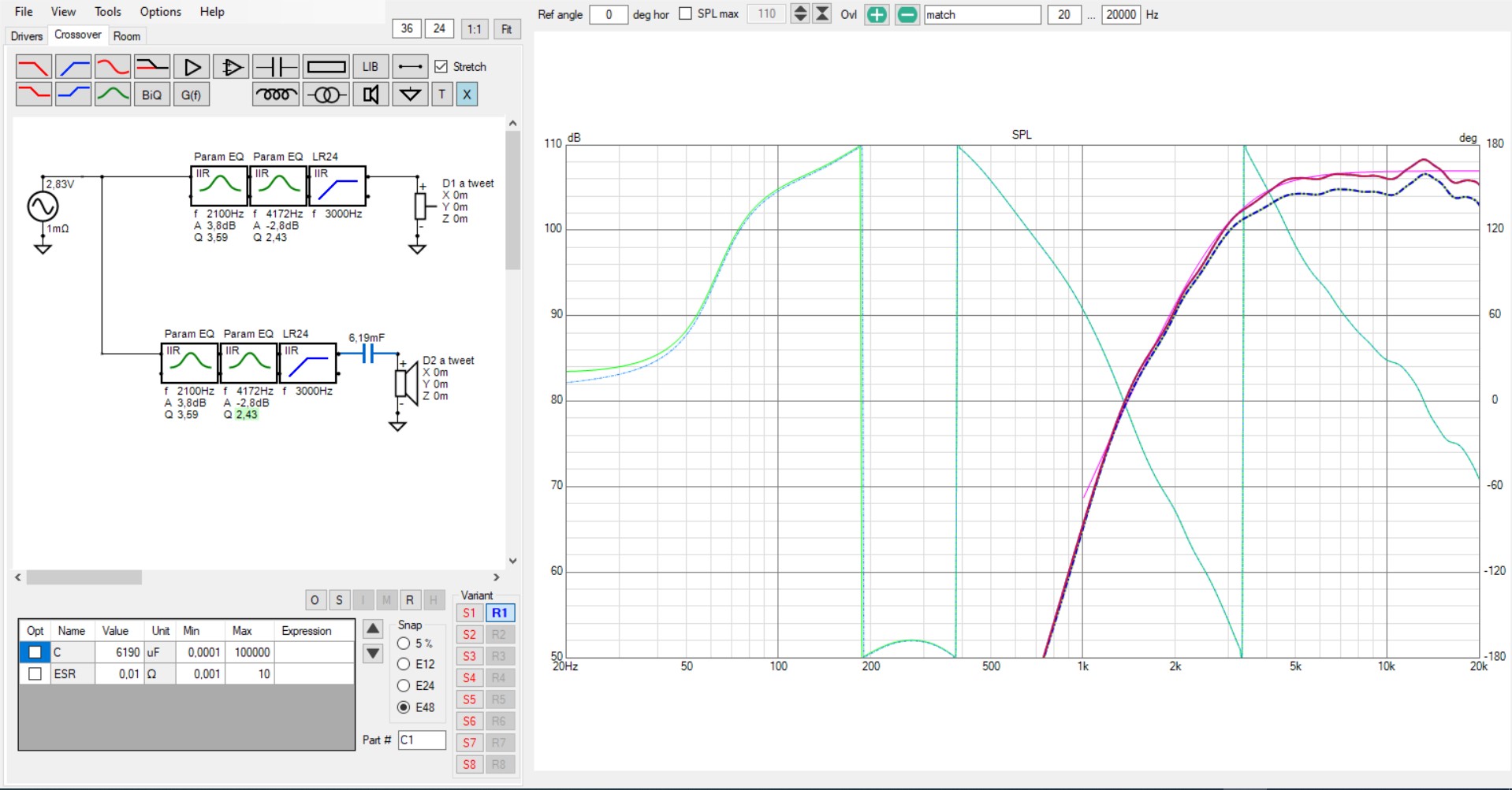

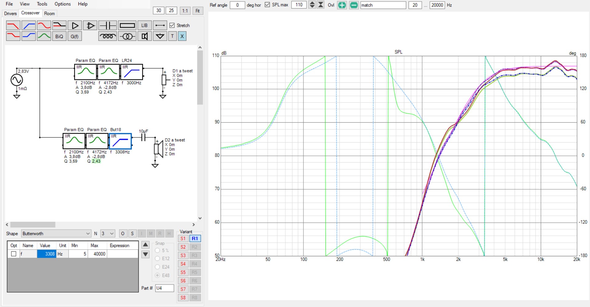

FYI quickie on VituixCAD. This is compression driver in a waveguide. There is two PEQ filters and a high pass filter to make close LR4 acoustic slope at 3000Hz. This is made as overlay visible on all the attachments as light blue phase trace and purple axial response.
On the crossover window the filters and driver is just copied for another branch, could have done all of this with one driver and set of filters, don't get confused 😀 The upper branch was used to generate the overlay and is muted on the attachments so it doesn't have any effect.
Attachments roll down from huge cap to a small cap, in addition to the DSP tweaked acoustic LR4 high pass. Just for fun to see how the phase and highpass response changes compared to no capacitor version of the same DSP filters.
1. huge cap around 6000uF, no meaningful effect
2. still huge 1000uF
3. 100uF
4. 10uF
5. Raw driver response, impedance also showing.
As you see the response doesn't change much until the smallest 10uF cap. Also the phase doesn't change too much, it is related to the frequency response. Notice how the frequency response and phase differs around ~2kHz where there is peak in the driver impedance. The cap interacts with the driver and additional DSP filters or passive parts would be required to tame that! Other than that using relatively large cap it doesn't affect much to the slope or phase. There is about 30 degrees and 2db difference at 3kHz in this case with the 10uF cap.
To negate the influence of the cap on the acoustic slope and match it back to LR4 it is just matter of changing the DSP high pass filter to 3rd order Butterworth, which I think you ment Puppet? 3rd order Bessel filter attached as well, can't get the response match with that. Filter frequency in both cases is tweaked so that phases match around 3kHz. Attachments 6 and 7.
Note the phases match nicely for the crossover region and up except where the driver impedance peaks are and also the frequency response differs there. Phase and frequency response are related and there shouldn't be any difference in phase if the frequency response was tweaked to be the same with or without the capacitor. These graphs are showing effects of the various filters to the measured acoustic output, which we are tweaking after all.
All this doesn't really matter, the response is seen in the simulator and getting it to liking is just a matter of tweaking with passive parts or DSP filters and it really doesn't matter what filters and parts are required as long as the response all around looks nice (and hopefully sounds nice 😀). Even if the phase differed for some reason it wouldn't matter either since it is just few more tweaks in the simulator. It is the acoustic output that matters eventually, not how to reach it.
