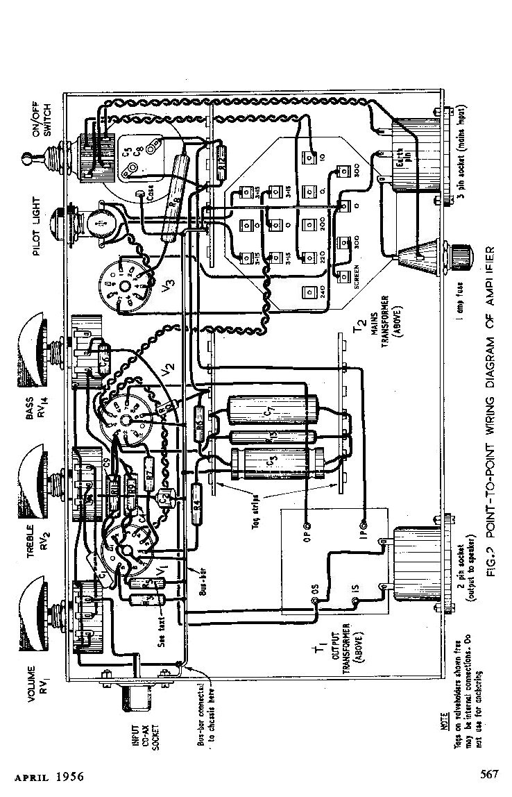

Please can some good folk help me cure a hum problem? I have built two Mullard 3+3 valve amplifiers which work very well except that both have rather more hum than I feel they ought. It isn't over powering but certainly a slight distraction during quieter passages of music.
I have used best quality components and the filament wires have been twisted and led round the periphery of the chassis. Each amp hums about the same amount and does so with no input. Turning up the volume control does not increase the amount of hum.
Earthing is largely by bus bar technique except in the early stage where a couple of earth links are made by connections in series and then to the bus bar.
There is only one chassis-earth connection at the RCA input socket end (of course there is a mains earth at the mains input socket at the other end link directly to the bus bar.
I have tried earthing the mains transformer to the bus bar but the hum got worse. I also tried earthing the body of the volume control but that made no difference.
The original Mullard circuit had a resistor and capacitor in the power supply part of the circuit to drive a valve preamp(R16 & C10). I omitted these but I'm wondering if I need to install extra smoothing by implementing this part of the circuit.
I'd be grateful for any suggestions as to possible cures for this hum problem. I should say I have limited theoretical knowledge but am keen to learn
Try upping the filter cap firstly, then add a 100ohm 2W resistor from each filament wire to ground.
Mains earth should go to the chassis, not the ground bus. The ground bus must have one and only one connection to the chassis - you have chosen to do this at the input sockets, which should be fine.xtaljo said:There is only one chassis-earth connection at the RCA input socket end (of course there is a mains earth at the mains input socket at the other end link directly to the bus bar.
How is the mains transformer HT secondary CT grounded? It should go straight to the negative end of C9, then from there to the ground bus. This keeps charging pulses away from the signal ground.
Are you using modern or NOS valves, especially for the EF86? Some modern valves don't have such good heater-cathode insulation, as they assume that DC heaters will be used for low-level circuitry.

In connecting one end of the ground bus to earth I was following the wiring diagrams given in two articles on constructing this amplifier. I have attached one of these diagrams. However, I am quite happy to try re-wiring the earth to the chassis and disconnecting it from the ground bus. I know certain wiring practices have changed over the years and this looks like one of them. I will report back.
I will also double check the wiring of the CT of the HT secondary.
The valves are from fairly reputable stockists in the UK who say they carry out a range of tests before sending the valves out. As it happens I used two different supplies for the two amps so to lessen the chance of getting valve specific faults. They are a mixtture of 'Mullard' ,'Valvo' and 'Phillips'.

Here is a report on what I have done so far:
1) Disconnected mains earth from the Power Supply end of the bus bar. Connected earth terminal of mains socket to the chassis about 1/2" away having cleaned the area and using tightening washers and well well tightened nut. Result: no difference in the level of hum. Hum now increases slightly when volume pot is turned up.
2)Checked that wire from CT of HT secondary winding goes straight to negative side of C9. Initially it went to the bus bar about 2" away but I re-wired it.
Result: no difference in hum level.
3) Tried using different valves, in particular EL84. Swapped 'Mullard' for 'Phillips' and a cryo-treated version supplied by Watford Valves Ltd. Result no significant reduction in hum level.
4) Tried disconnecting earth from body of volume pot. Result slight increase in hum. Connected body of pot. to the junction of the bus bar and the negative side of C9. Result a very slight reduction in hum.
5) Separated some of the wiring around the valve holders particularly around the heater wiring. Care was taken to ensure that the majority of wires ran at right angles to the heater wiring. Just one or two have very short runs parallel to the heater wiring. I'm wondering if the HT wires from the HT secondary winding of the PT which run to thr rectifier anodes ought to be twisted too. At present they run parallel too each other and are separated by about an inch.
6) I have followed Mullard's recommendations about the layout of these amps. So, for example ,the axes of the transformers are at right angles to each other and the input socket is at the EF86 end of the amp etc.
Puzzled I eagerly await any suggestions.

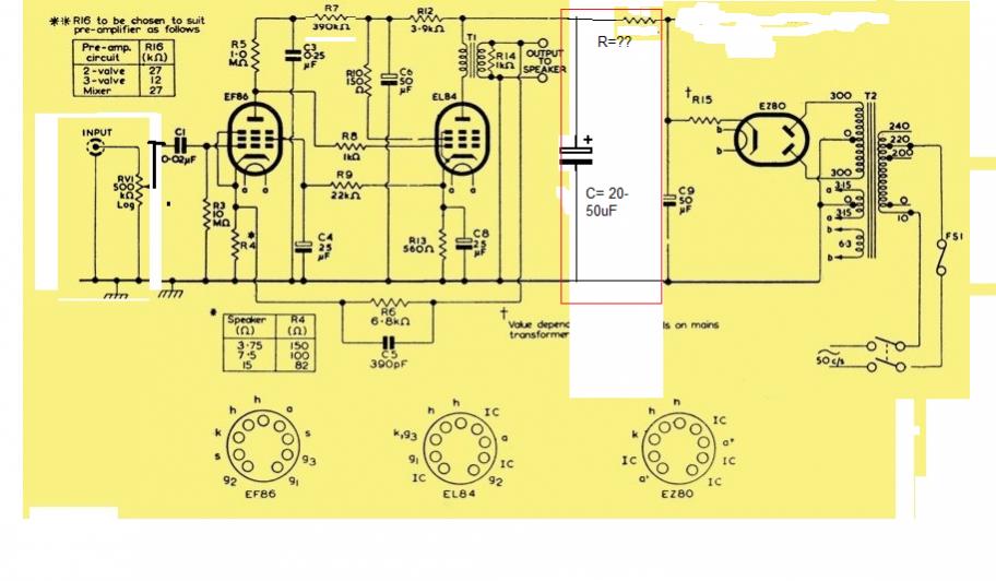

Enzo:
I'm not entirely sure about the circuit mod. you are proposing. I will attach a diagram of what I think you mean and send it in a new msg. Sorry to be rather slow on the uptake.

Yes, that is exactly what I was proposing. The R? could also be a choke.
COmpare these Fender Champ power supplies which are done as my suggestion:
http://www.webphix.com/schematic heaven/www.schematicheaven.com/fenderamps/champ_5e1_schem.pdf
http://www.webphix.com/schematic heaven/www.schematicheaven.com/fenderamps/champ_5c1_schem.pdf
To this later one, whwich is done as your original cicuit, and is noisier:
http://www.webphix.com/schematic heaven/www.schematicheaven.com/fenderamps/champ_5f1_schem.pdf
In the later version, Fender decided to save a couple dollars, the increase in hum being considered "good enough."
SOmething else to consider: hum is not generic, it can come from multiple sources and each source has its own remedy. So you may have some B+ ripple hum, which my extra filter may help, but you may ALSO have hum from tube heaters, or from grounding issues, or from insufficient shielding, or whatever. So if you have a small amount of hum in the first stage, the volume control might reduce ity, or pulling the preamp tube might reduce it, but those things won;t affect hum in the power tube stage. That might explain the volume control helping a small amount but not completely.
R? is not critical, without calculating anything, I'd think 250-500 ohms would be a place to start. A small choke would be appropriate. Antique Electronic Supply LLC offers a selection. I'd probably start with a resistor to see if the arrangement helps. Then if I felt the NEED for a choke, I;d check the B+ current draw of the whole circuit and check my choices based upon that.
It is just an idea, you might find just slapping larger filters in the existing circuit to be enough.
100Hz hum is from power supply ripple, and that is what my idea fights. 50Hz hum is from grounding, shielding, radiated pickup of transformer field, heater noise. 100Hz and 50Hz are the same note musically, one is an octave higher.

Thanks everyone. Hum cured!!!
I was re-arranging the components at the input stage and this improved things somewhat. Then I noticed I had wired an unnecessary/duplicate ground connection to the bus bar causing a ground loop. One snip (amp off) and (amp on) all was well! Just a slight residual hum if you put your ear within a couple of inches of the speaker which is normal.
