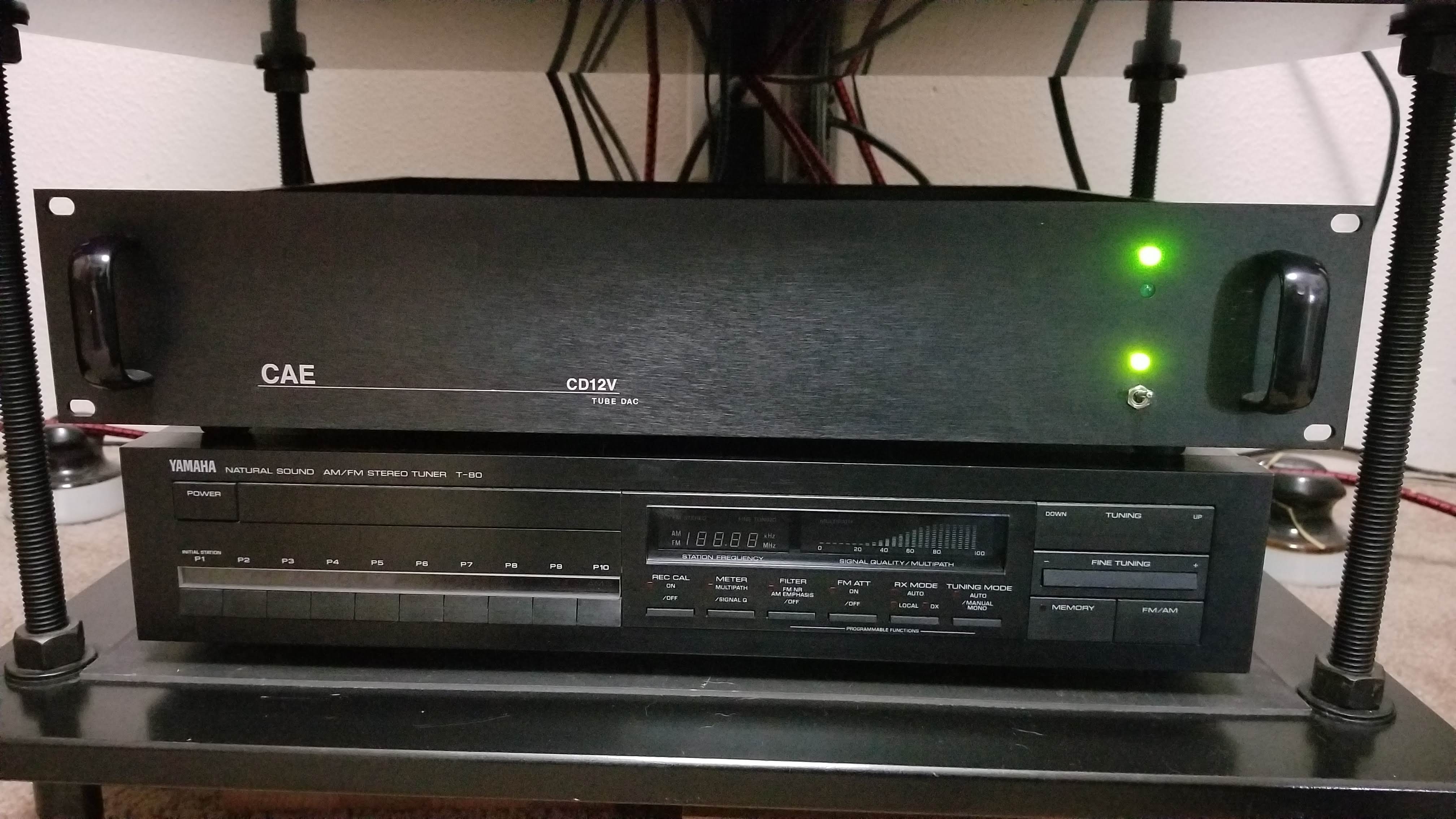

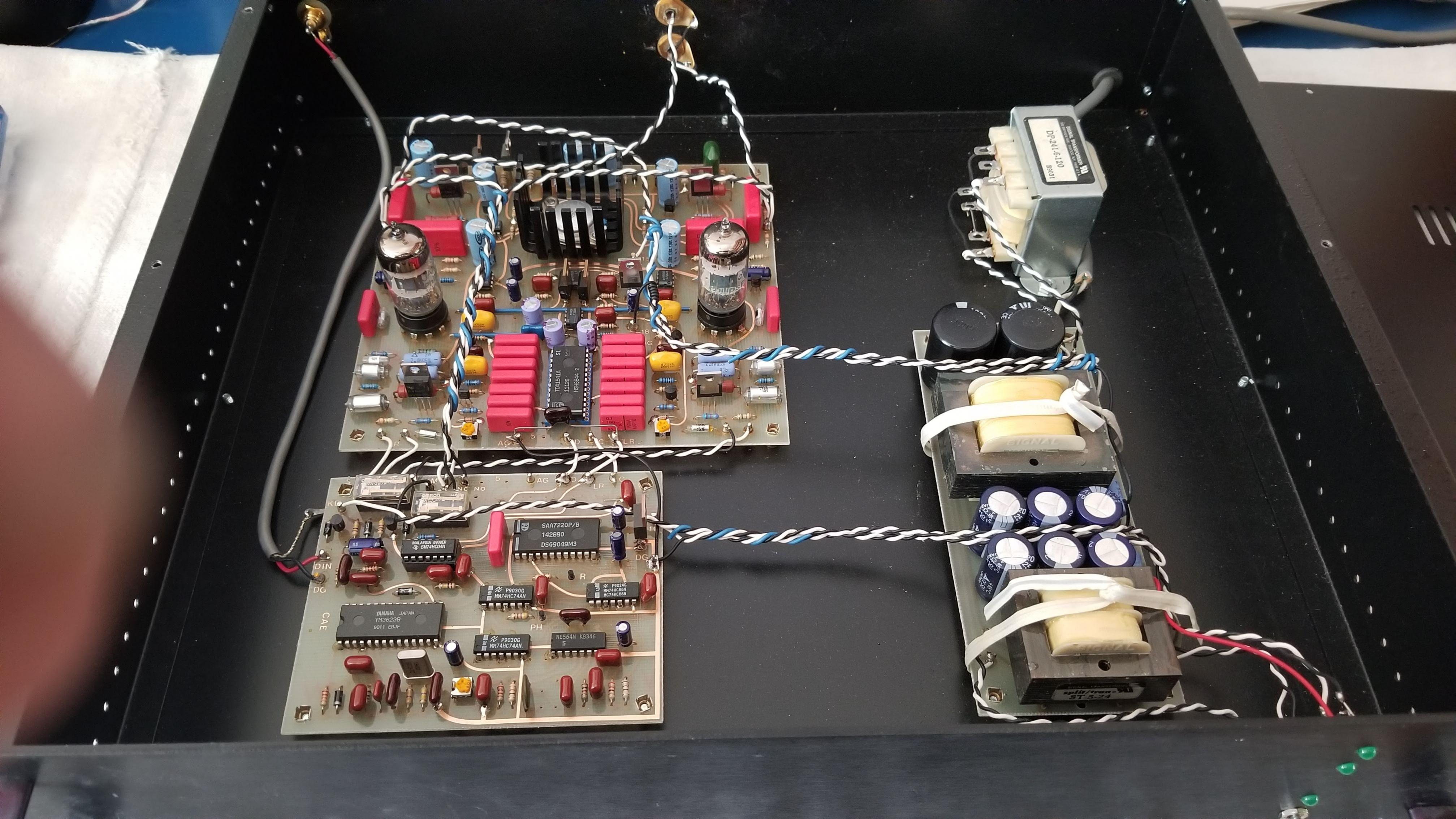

Hey all,
Looking for documentation for the Curcio CD12V dac. Hopefully somebody has held on to it and can share. I've reached out to Joe Curcio without success.
Background: I have a working CD12V that I picked up at an Estate Sale. Didn't know what it was until I got it home. The DAC has been working and in use intermittently without significant issues since.
You can read about the score here:
DIY tube pre-amp(s) identification help needed | Audiokarma Home Audio Stereo Discussion Forums
The reason I want to locate the original documentation is because I would like sort out a couple things on the unit.

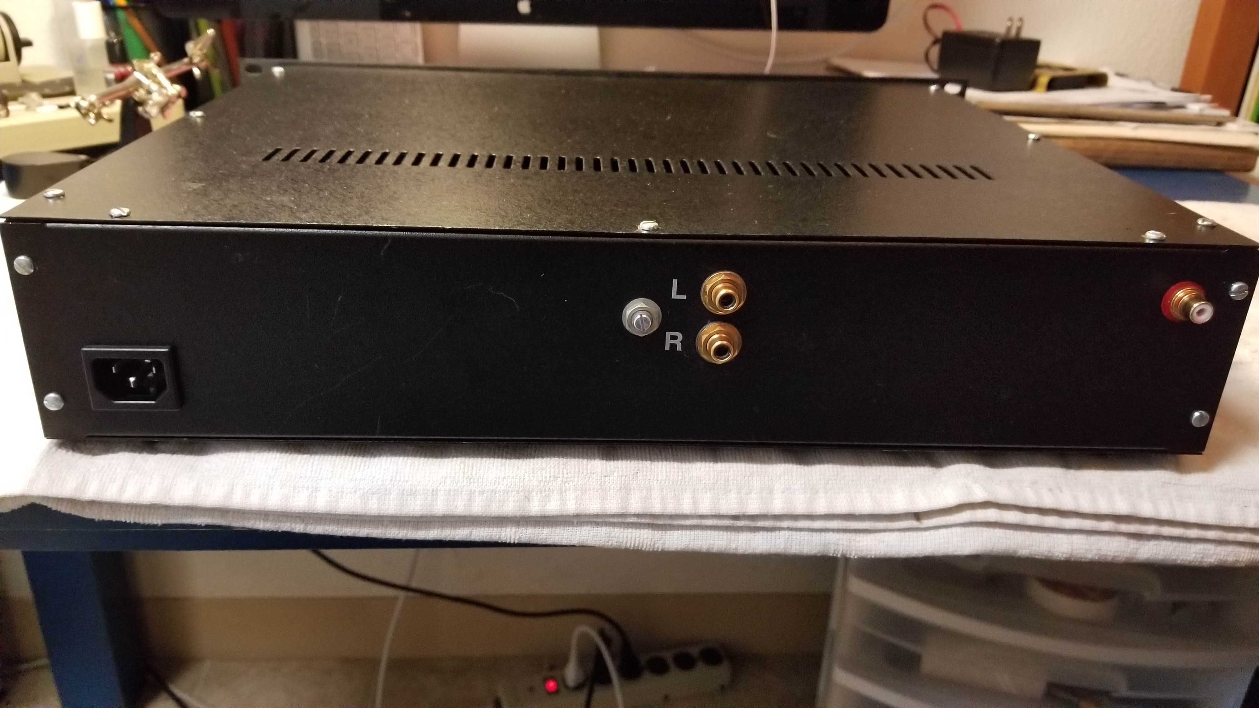

  1. There are 3 LED's on the front panel, one is obviously power, another illuminates upon "Lock" with the CD player, but the 3rd LED never illuminates. I cannot for the life of me figure out what it is for. Maybe for 48khz instead of 44.1khz? Or is it a non-functioning MUTE circuit?
  2. If it's possible to reduce the gain or output level?
  3. Maybe adding a Mute switch? It seems like I've seen that option on the few examples seen on the web. When the unit is powered up, but when there is no lock on a digital signal there is some annoying noise that will come through the system.
  4. I also want to explore adding multiple inputs. I know this won't be reflected in the documentation. I will probably look for an off the shelf DIY kit (i.e., Twisted Pear Audio) and will need to identify a place to tap power for whichever kit I locate.

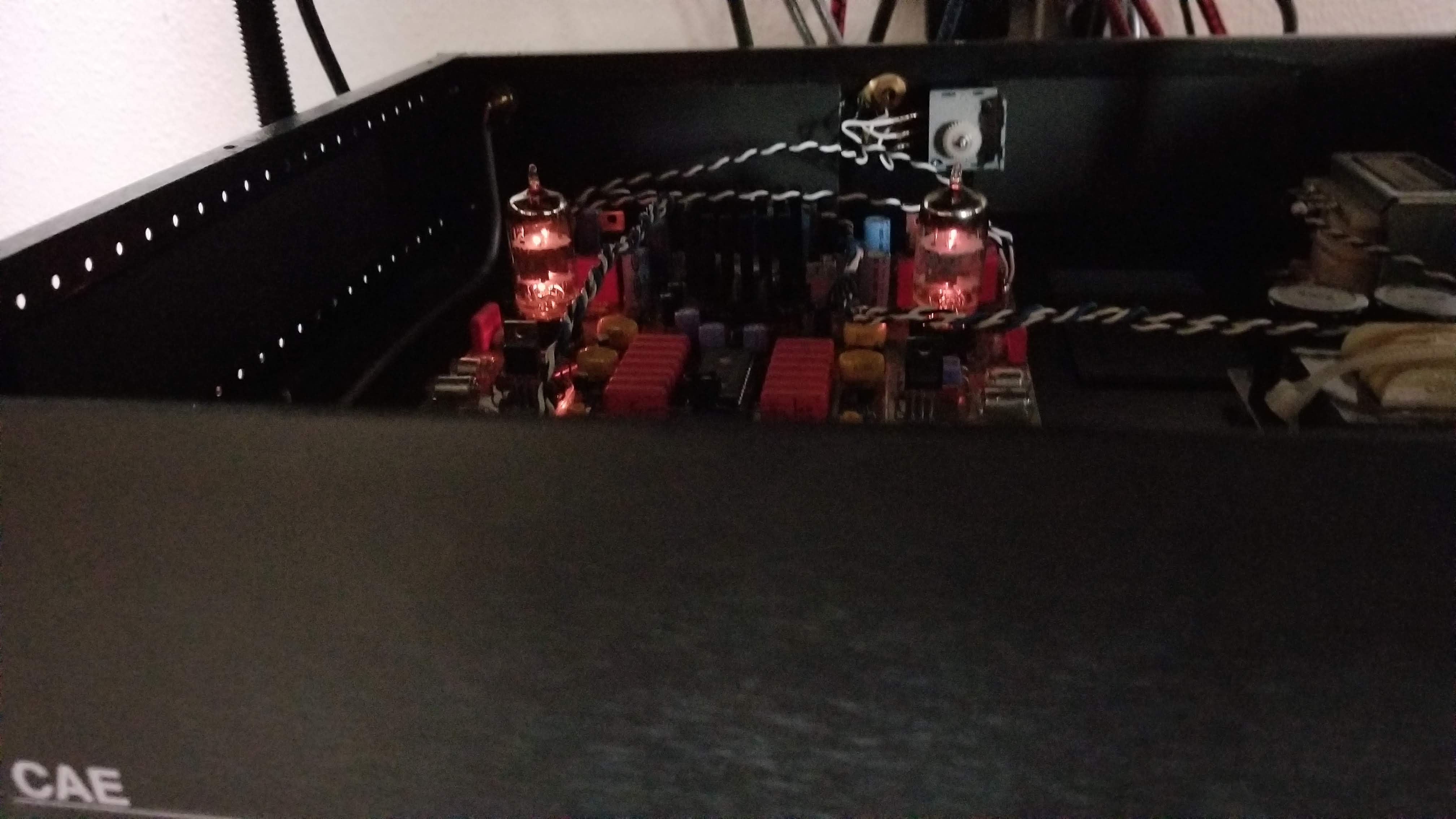

Maybe y'all can help me solve the gain issue without the documentation. Curcio lists the output level as 4.4v RMS on his website. He also posts the attached schematic. I've circled R121 and R122, which look to me like they may be a voltage divider (?) and a good place to adjust the output level?
R121 and R122 appear to be 470Ω and 3.3M based on visual inspection of band codes. They are just before "LO" which I believe stands for "Line Out"?
I'm guessing the simplest solution would be to add a pot on the analog output of the DAC. But, if I can simply change out these resistors I would think that would be better than adding another component. I would really like to get the DAC output down to something like 1.5 - 2.2v output to gain match with the rest of the components in my system.
Any other suggestions? This unit is set up for 12AT7's, not 6DJ8's. Is there a 12AT7 substitute with less gain? Is there a way to adjust gain in the circuit closer to the tubes? Like in a feedback loop?
I have the most basic understanding of tube circuits and can read a schematic OK. But, figuring this out is a little over my head and need some hand-holding.

You would probably be better off just putting a pot on the output, however it looks like the circuit might sound better with maybe something closer to a 10k pot rather than a 1k Pot. You could try either or both though. However, to the extent using a larger value pot increases the output impedance of the unit, that could potentially cause some high frequency roll off of your audio depending on interconnection cable capacitance, etc. Maybe better to put the pot at the input of your preamp, say.
The 3.3meg resistor, R122, looks to me like its just to provide a discharge path for C110, its not a voltage divider to set the output voltage. R121 is probably there to assure stability (freedom from oscillation) of the output stage, although it would probably be safe if R121 value were increased (again, too much resistance and some HF roll off might occur with longer cabling, etc).

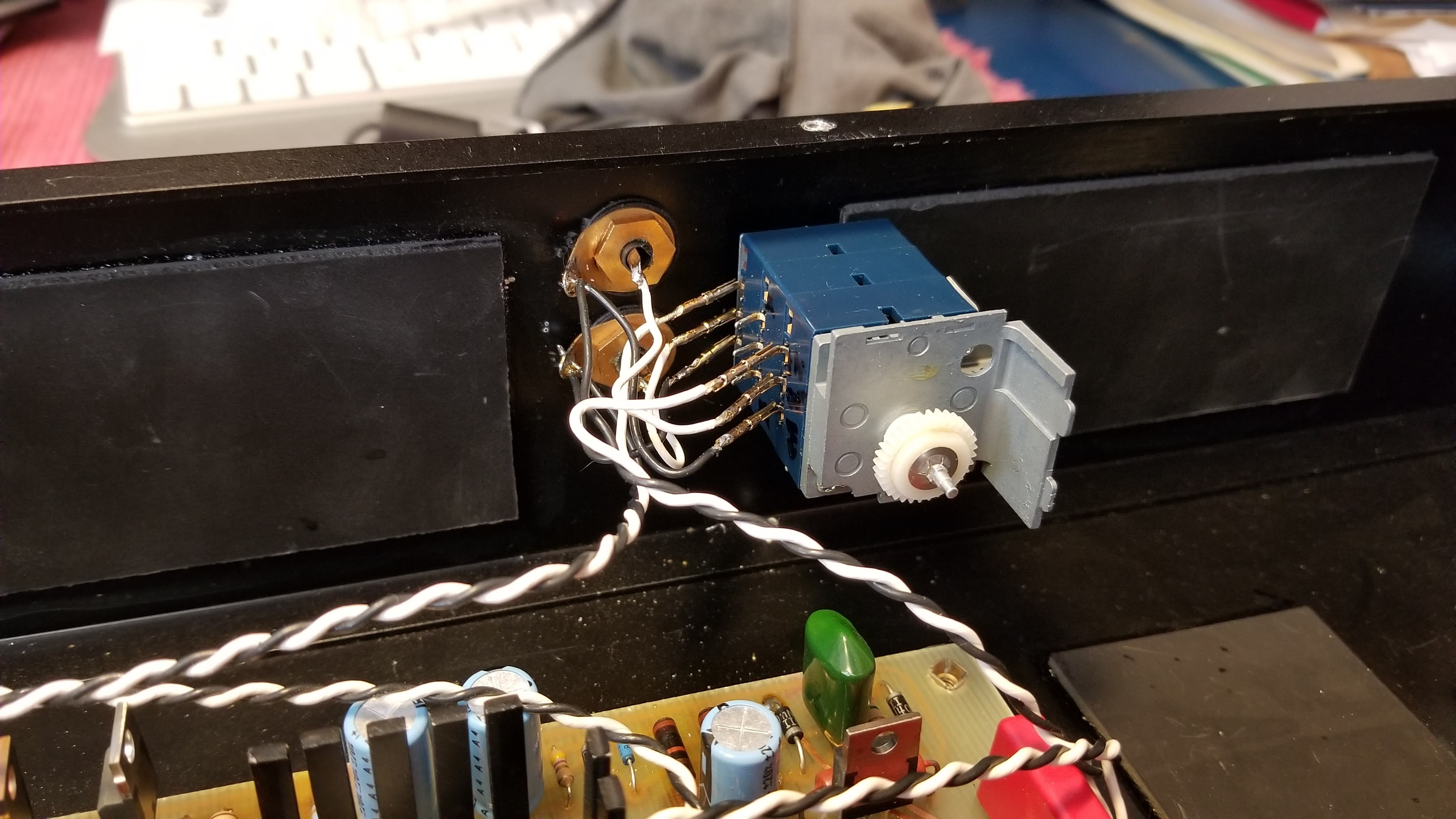

I dug around in my spares bin and found a 10k ALPS pot. This one was a motorized 3 deck version that I think was from a dead CD player and was the internal control for a variable output. The fore and aft decks tracked very close, but the middle deck tracked differently. So I removed the motor and installed it very close the analog output RCA's. Rather than solder to the pins of the pot I used some gold-plated female D-Sub pin connectors that I use to make my own headshell leads. This will make it easier if I want to swap out the pot.
Once I got it set up I installed it into my system and using headphones I gain matched it to the CD player feeding the DAC by switching my preamp back and forth between the two sources. I got it very, very close by ear.
While I was doing this I could not discern any loss of fidelity between the CD player and the DAC. In fact it was so close that I am actually disappointed there wasn't more benefit to having a tube stage.
Note the CD player is a highly modified Philips CD-60 with a TDA1541 dac. So essentially I think it came down to the difference of a tube (12AT7) vs opamp (lme49720ha) output stage. The mods on the Philips unit very closely follow everything in this thread...
Marantz CD-50 and CD-60, TDA1541, CDM4/19
I would say the Curcio DAC has a slightly wider soundstage and cymbals sound ever so slightly more realistic. But otherwise the difference was extremely subtle, which is kind of opposite of what I would expect I would experience due to expectation bias. Funny.
Then I took it back out and measured between input and wiper of the pot and found it was 2.6k and at about 3/4 to full output turn of the pot (225º).Not sure what that translates to in terms of -db from full output, maybe someone can tell me. But, I now have much more usable travel on my preamp volume control when using the DAC.

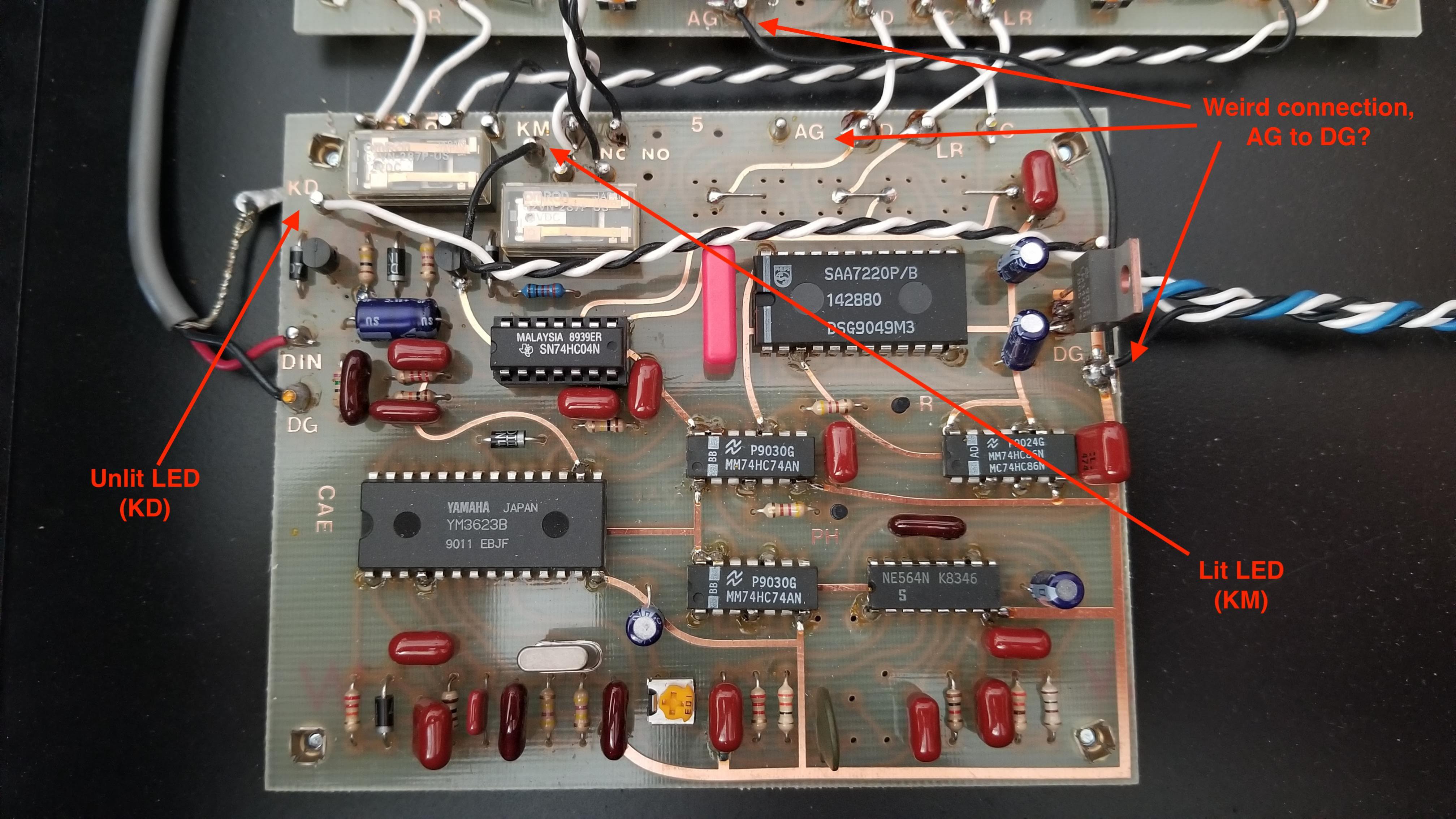

Now I need to figure out what that unlit LED indicator is for.

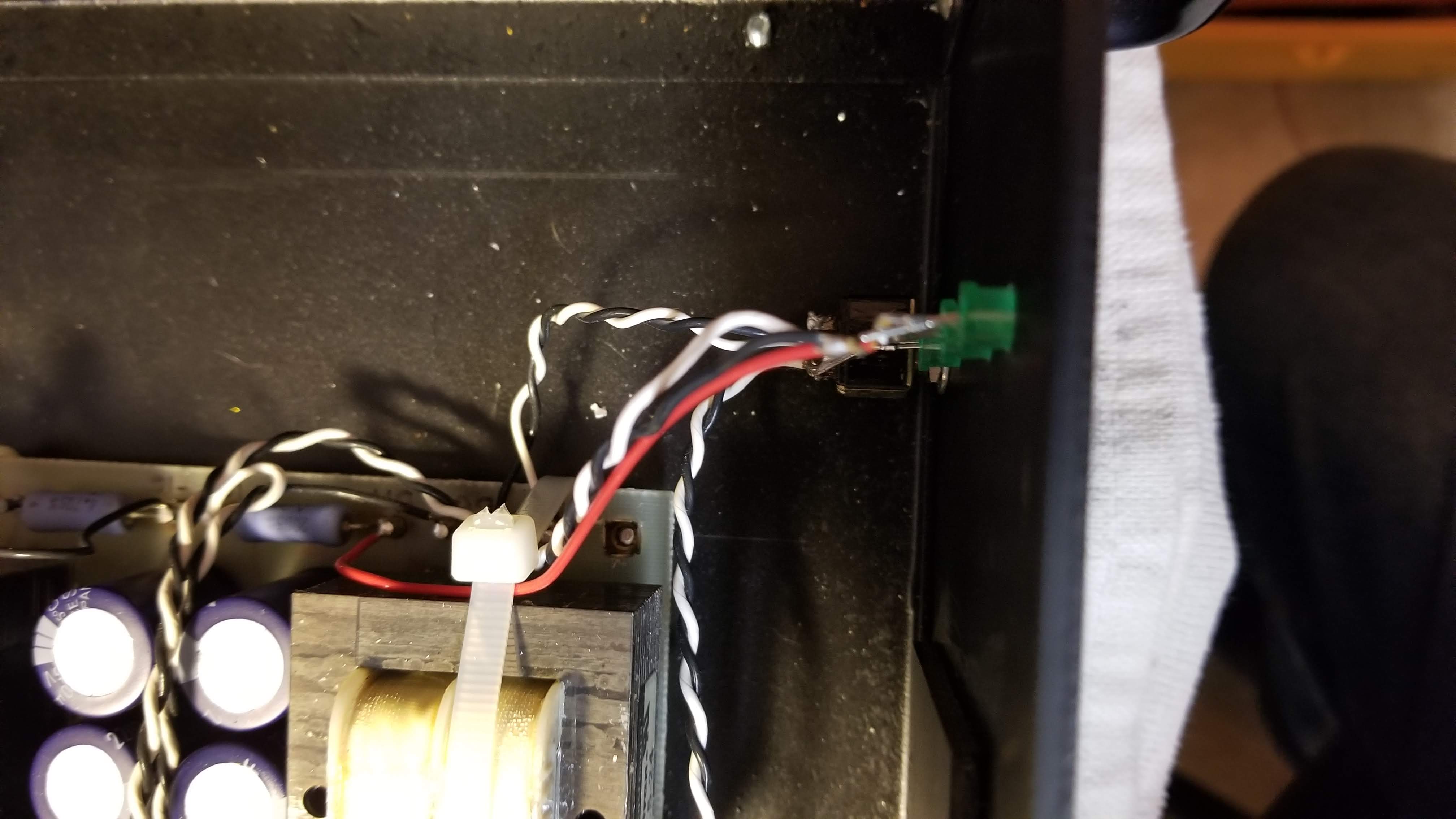

Here's some pics of the leads. As you can see from the pic from previous post, the top LED lights when it locks on to the CD player. If I turn off the CD player the LED goes out. Of course the LED above the power switch if the power indicator.
After getting the Curcio Daniel 2 preamp working I learned that Curcio liked to put LED indicators in series with relay coils to light them whenever the relay is activated.
In these pics you can see the two LEDS on the front panel are wired with one hot lead (red wire) tying their Anodes together and the Cathodes are attached to the black and white wires. The working upper LED is the black wire which goes to the terminal marked "KM" on the filter(?) board. The other LED that never lights goes through the white wire to the terminal marked "KD". Both terminals appear to connect directly to the coil pins of the nearest relay to them.
So, does anyone have any insight to what "KD" might mean in Curcio nomenclature?
I think "K" is used by Curcio to denote relays. So I thought KM might be 'Mute Relay', but it definitely is not muting the output. Maybe it's muting the digital input?
Maybe KD is 'Digital Relay'? and might be if it received a certain type of digital signal. Maybe the de-emphasis idea is correct. Not sure how I could feed it a an emphasized signal to test it. Or, maybe it is for a switching between 44.1 and 48khz? Also not sure how I can test this with what I have at my disposal.
I really wish Curcio would respond to my email and send me the documentation packet.
Edit: forgot to mention that I noticed a connection between the boards of AG (audio ground?) to DG (digital ground?) as noted in the pic.

Ok, new information.....
That LED that I have been trying to figure actually did something today.
I was listening to some music and the CD started skipping. When the skipping started the LED started flashing. Not with every skip, but on the big ones. It wasn't flashing with any pattern. It was coming on at the initial "tick" of every skip that seemed to set the laser back instead of moving forward if that makes sense. Also, as the song ended the mistracking continued into the fade out and as it got quieter I could hear the relay clicking in and out.
I have never seen this before. Does anyone have a clue what this means? Is it some sort of error indicator?
Fortunately the Philips is a rock steady performer and it is very rare to get any skipping, so I couldn't replicate it. In this instance I pulled the disc and there was a fingerprint on the disc that was easily cleaned.
It was a long time ago that I built one, from vague memory, 1st led for signal lock, 2nd absolute phase and 3rd deemphasis. If I am able to find documentation I'll let you know.
Man, if you had the documentation that would be great!
I dug through my CD collection to find my oldest CD's. Found a couple that were pre-UPC code issues from the early 80's and played them through the dac hoping at least one was a "pre-emphasis" disc. No luck there, or at least if it was a pre-E disc it didn't trip the LED.
I don't know enough about "absolute phase" to know if there would be any CD that would cause the LED to trigger if that's what it indicates. Unless, maybe absolute phase came into play if someone was using a different source such as DAT, computer, etc.
Edit: oh....it just dawned on me that the terminal the LED in question ties to is labelled "KD". So, if Curcio uses K to denote relay, then D more than likely stands for De-emphasis. Now, how do I test this?
