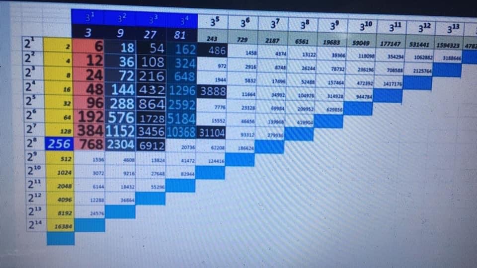

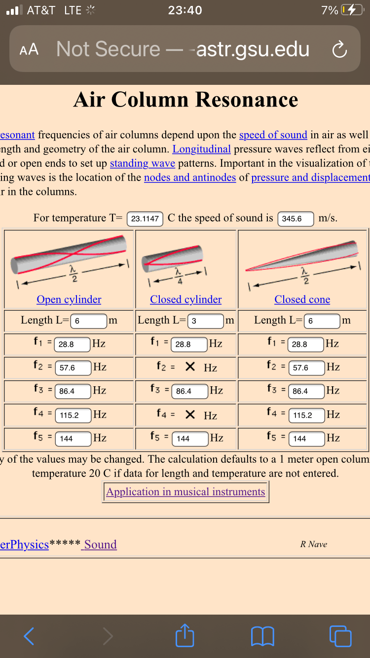

Strange ? the simplest things are actually how everything works already don’t let the ideal gas law for you you can look at that after the fact for obvious reasons especially if you’re flying an airplane over the mountains in the afternoon instead of early morning😝😝)
