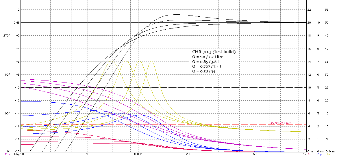

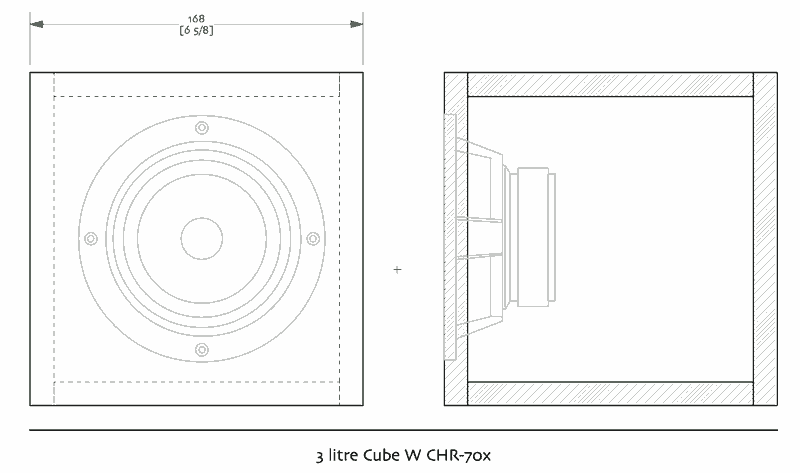

CHR-70 version 1, 2 or 3? 2 or 3 will work OK in this volume, Series 1 would really like a bit bigger box. F10 is going to be near 60 Hz. About as good as you’ll get (in a really big box) with the CHR is something like 40-50 Hz.
With 12mm panels:

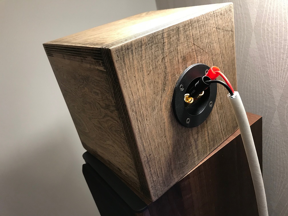

Little progress, I attached a photo. I decided to make a pair, so I could test them and run them in with my home system. I will sand them to 320 grit, then use two layers of Osmo Polyx oil wax (3075 dark brown, which better matches champagne colored drivers than bare birch) and then sand to 600 grit for ultimate smoothness :)

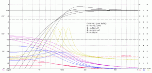

What generation CHR70 do you have? So i can pick the right set of sealed sims so that you can get an idea of what your bass rolloff should look like.

So I finished the speakers. Been running them in at low volumes and with classical recordings. After few days they already sound way better, revealing more details every day. I used online calculators to understand how low does the CHR-70.3 play in 3 litre sealed enclosure and I got 89 Hz, is that correct? My woodworking skills are left to be desired, so next time I will let professional paint my enclosures properly - my friend works at premium car paint shop.
F3 has been shown to be a meaningless number. Look at the F6 or F10 (~70, mid 50s). F3 is only of interest if you are using it as an XO.
A PR is a vent substitute. At least for the CHR you need to start with a bigger box.
