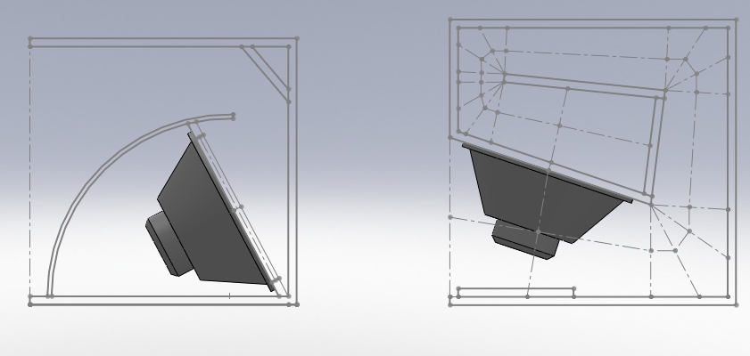

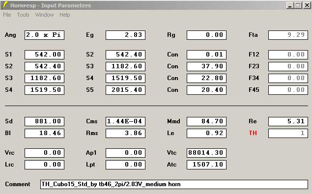

The other way to model the Cubo in Hornresp is to treat the chamber as a large throat chamber (Vtc/Atc), set S1 and S2 to the horn throat size, the other three sections can be used to define the horn and the driver location.
A while back a made a quick sketch of three different models of the Cubo15 (sorry, I don't recall where I found the original data). This is not a completed drawing, and should not be seen as such, just to show the different versions, and the general locations for the Hornresp data inputs.

I did come to the same conclusion, pretty much in the same way. That method also allowed me to simulate Cubo Extended in Hornresp.
I use this method mostly. Except I use different segment steps and arrive at a different chamber size (smaller). Regarding the pdf: That first Cubo design isn't mine, it looks more like a ARLS IIRC.

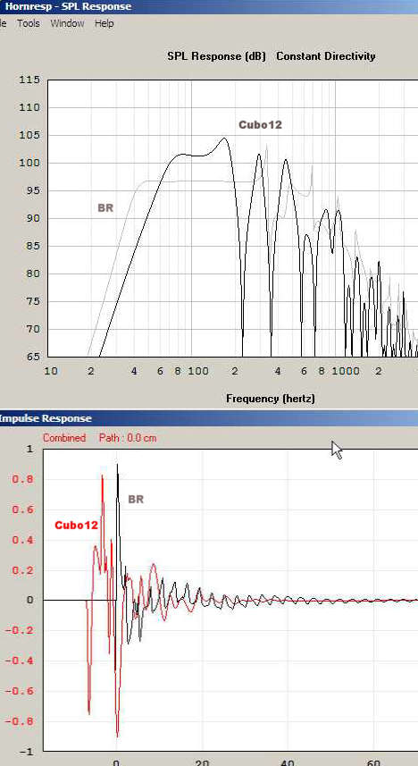

I'll attach an Hornresp SPL and Impulse comparison between the cubo-12 from that page, and a simple bass-reflex.
