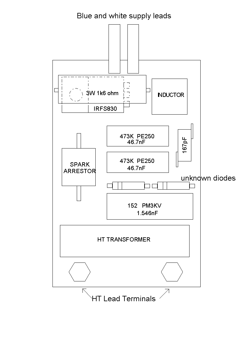

Does anyone know where I could lay my hands on a service manual for a EZpro585 or similar. I have one with a dead ignitor (at leat that is what i think it is).
It is a small black box, which used to be potted. It has a blue and white lead fed it from the main PSU pcb, and two white HT leads then went fo the HID lamp.
I have removed the circuit board from the black plastic, to try and repair it, but some of the components are unidentifiable, such as two black diodes (these are similar to the 1N4000 series but longer) They have some markings on them but they are at work at the moment, so I can not say what they are. I will look on monday.
Any help is very appreciated.

Do you know what could be? I have same projector, and I turn on, is start and after few second light turn of, and fan slow down. And after half minuth, is start again, and is same again. Light go of, and fan going slower. Do anybody know what could be??? Projector CTX EzPro585
