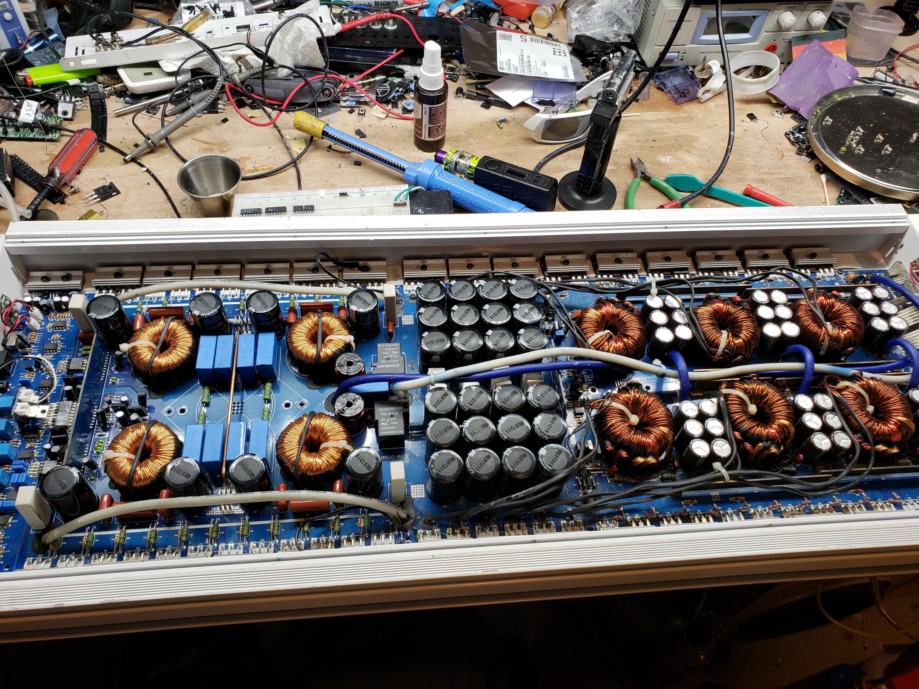

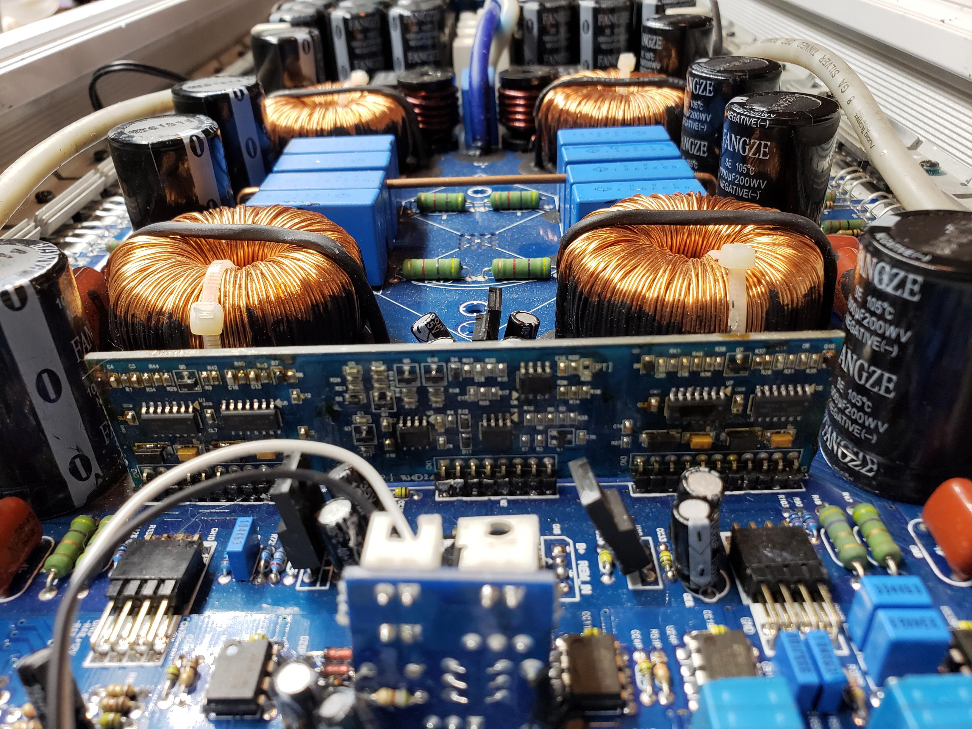

The output section isn't kicking on for some reason. I replaced all of the 21844s chips, all of the transistors and all 3 op-amps on the board. All rail voltages are present and all of the regulators are working. Also I have a working version of this amp I can reference from im just out of ideas.
If the input is swinging above and below ground but it has no output, it is likely defective (rare).
I don't know what you mean by 'i have 5v'. You need both positive and negative 5v supplies feeding the IC and a square wave swinging to ±5v on the output of the LM211.
Is the power supply producing any drive to the PS FETs?
If not, post the DC voltage on all terminals of the 494.
