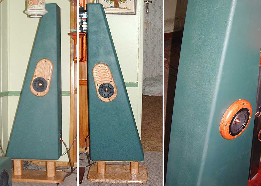

Just fired off my Bi-polar ML TQWT using the CCS FR 125 full rangers and after 5 minutes of listening I had to grab two handfuls of Accoustastuff and push them into the vents. Hard to imagine a 4" driver with too much bass! Can't measure them but they follow M. King's model for two drivers in a single enclosure.
The physical specs are ;
length 50"
Top and bottom areas 1and 7xSd respectively.
Vent; (Now restricted) 3'' dia x 6'' flared at both ends.
Drivers at 50% of length
Fill 1/3 lb / cu ft.
Material; Baltic birch (3/4 ") braced along side joints and 1" hardwood dowels front to back in 11 places.
They really sound great. Would love to post pictures but the files are too large and my computer skills are too small to figure out how. Thanks Bob--these are a whole new kind of musical animal.

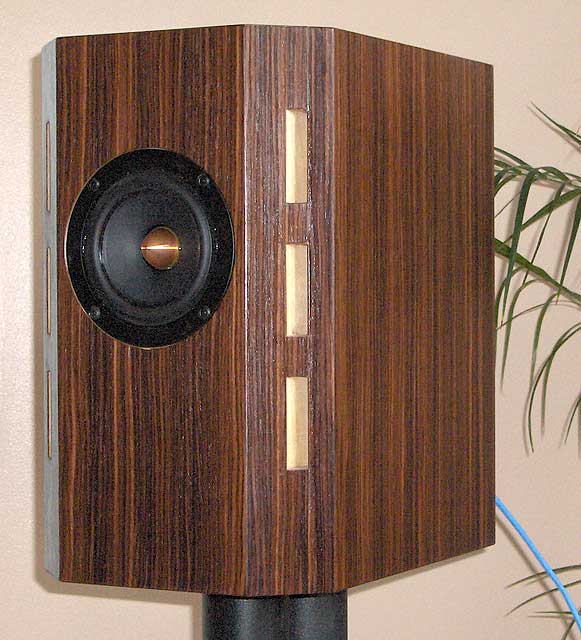

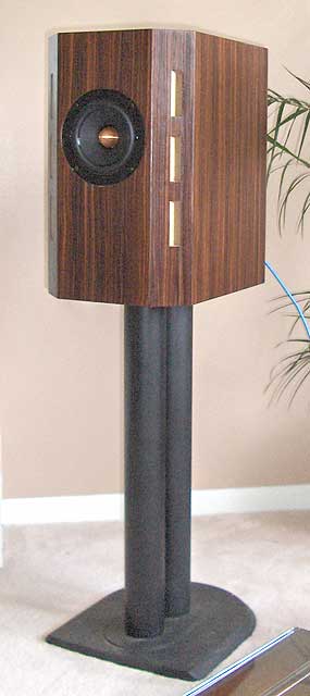

Lovely work Pete. OK if i draw up plans & put them with the growing list?
dave

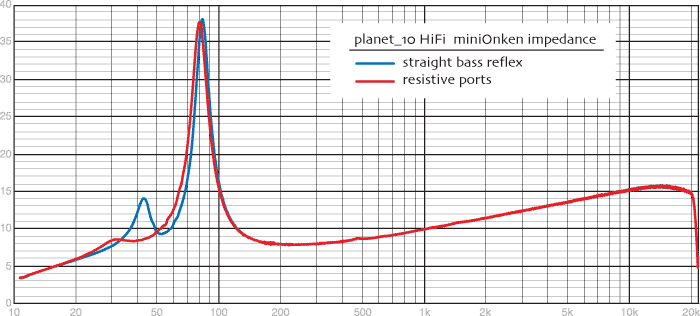

Peter Menting said:and after 5 minutes of listening I had to grab two handfuls of Accoustastuff and push them into the vents. Hard to imagine a 4" driver with too much bass!
Same with the bipole ML-TLs.
I was tempted with the monOnkens to do the same thing. but figured that as they broke in they would improve. Nope. 2 weeks later i added some foam stuffing to the port (because it was easy to get at). Bass got better, with no lack to impress. Version 2 of the cabs are now in tuning... without a little aperiodic help the BR port will unload the drivers in dramatic fasion if fed bass notes of the right frequencies (a problem with all BR).
dave

Quite awesome... we have watched 3 or 4 movies with the miniO protos in place.... for HT i have a push-push ApexJr Super 8 Sub which integrates well.
dave

Dave: Those mini "O"'s are looking real nice! Chris must be veneering up a storm. (We already know they sound great, I'll be talking to you about prices)
Dave; I have the plans drawn up in Deltacad----will mail you a set if you can open them. Feel free to put them on your sight.
