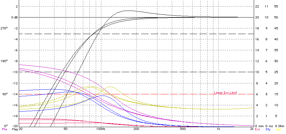

Anything bigger than 10 litres doesn't gain you much... attached are sims with (IIRC) about 2.5 litres (Q=1.1), 8.something litres (Q=7.07) and 20 litres.
With this i decided that something like 4 litres aperiodic would make a great small box to mate with sub(s).

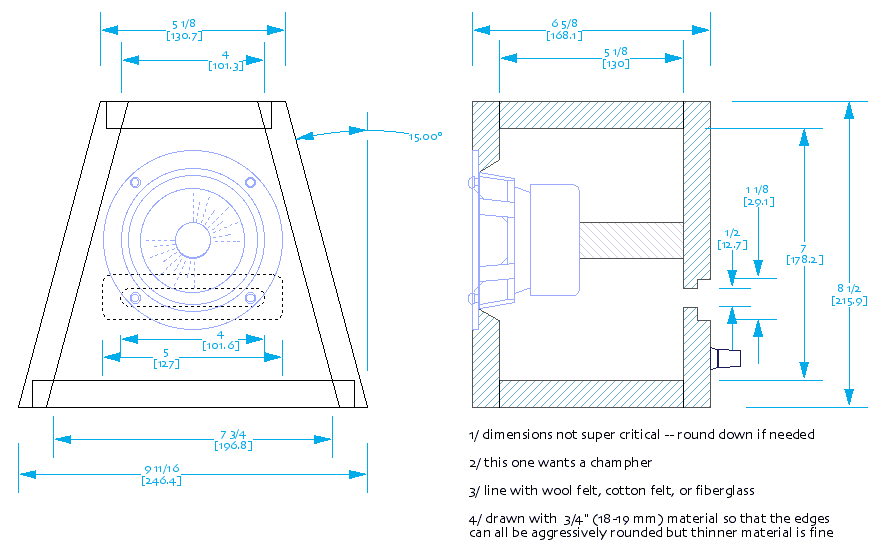

Attached is my idea of the little aperiodic. The beauty of a box this small is that there is a lot of flexibility in the shape (as long as you can fit the driver in). As drawn it is intended to have an agreesive roundover (otherwise i would build it with 1/2' and gain a reduction in dimensions of a 1/2" all round). Of course this shape does nothing for the bonus baffles (IMHO opion these are worth having just to find out how well the self-centreing works, even if you don't use them 😀)

It is also easy to fit the official 7 litre vented box into that sceme...

why the 'high' vent
Dave - why the 'high' placement of the port on the 7 liter design?
Given what I've seen you say about use of physical bracing of the driver using a rear directed 'post' between the magnet and rear baffle, wouldn't the design be better served with such an addition and movement of the port below the horizontal brace?
