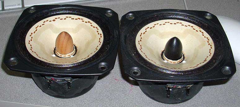

If i go thru the batch of FE108eS plug blanks and choose the smallest diameter, they should fit. I would recommend getting unfinished ones so that you can adjust the length and, if necessary sand down the barrel (a pain to do but what i do when i need a plug for the holey basket Coral version of the FE103A).
Note, that like the FE126/127 i do not recommend plugs for the EL70 unless it is the only way to recover a damaged dustcap. I've (luckily) not yet had to muck with an EL70 dustcap.
I have never had any luck with the vacuum cleaner, but have done a half decent job with a pin prick to lever out the cap. It doesn't come out perfect thou.
As the dustcap does a significant amount of the HF extension, losing the caps, or the inevitable reduction in stiffness from having creased the cap, the extreme top end will probably not be the same.
One trick passed on by a customer with dented FE126, was to carefully push in the cap (not too much) to create an inverted dome. He preferred them that way (until he tried too much of a good thing and pushed them too far).

Here is the picture i meant to attach in post $6 of some FE127 recovered from dust cap failure.
dave
