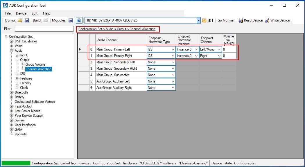

Can anyone help me with how to set I2S in qcc5125 because I want full output from the module if anyone help me I would be really pleased

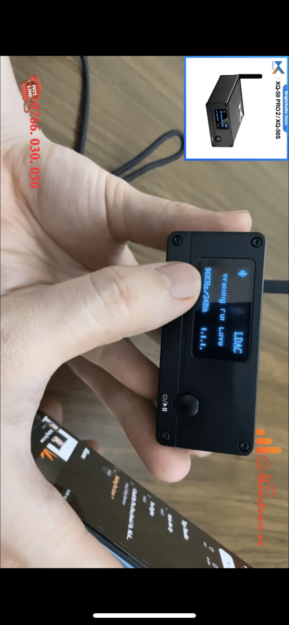

Do you mean get song name and print it on LCD or oled?Anybody know how to connect QCC5125 via I2C, what is a pio number? Any known I2C registes e.g. to get song name?
