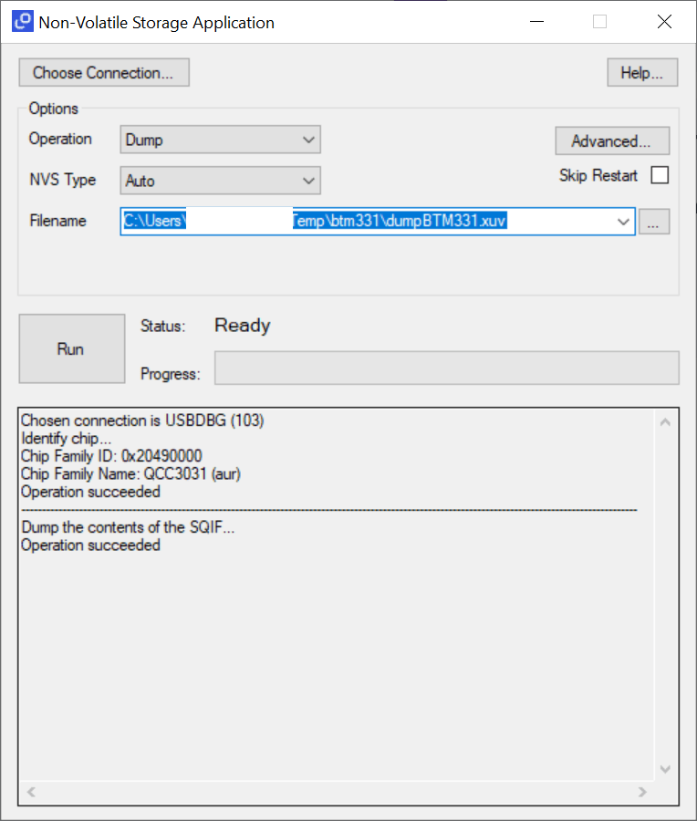

I'm tracking down random failures of the BTM331, and so far have obtained BlueSuite 3.3.10, unlocked the chip, and created a .xuv Dump of original firmware using NvsApp. Is the .xuv file a valid backup?

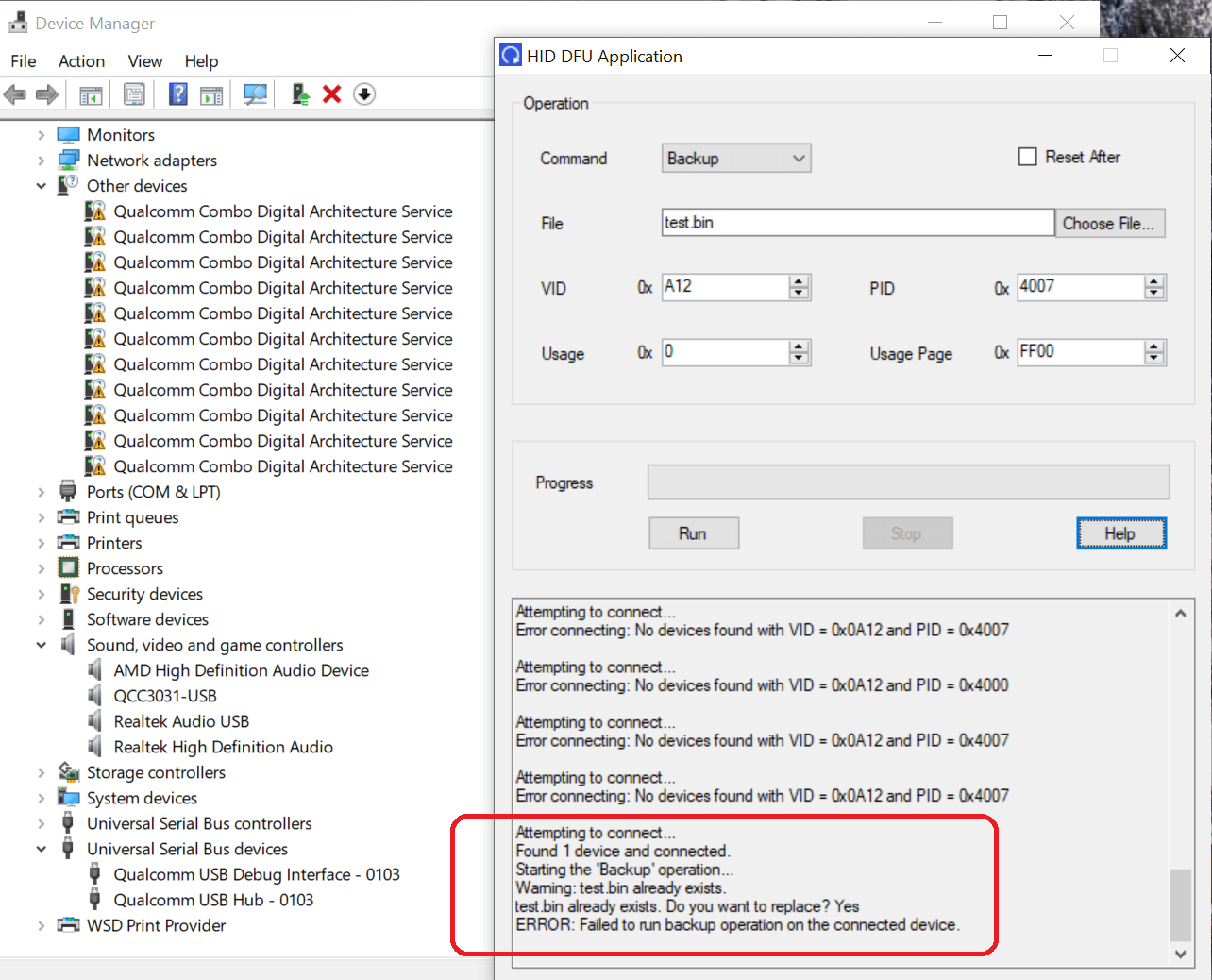

I've tried HidDfuApp without success (maybe a DFU dump is preferred?). I see PIDs 0x4000 and 0x4007. The DFU app will only connect to 0x4007, then returns an error.
It should be. You can look into it (as text file), it is similar to Intel HEX concept. The format is the following: @ADDRESS VALUE
Empty file would only show you "FF"s (hexadecimal). If the firmware doesn't have much custom-developed code, you may compile your own version of firmware, see few last pages for instructions. In case of failure you may just use debugger (available as a part of MDE, for QCC3031 you'll need ADK 6.4 and MDE 2.3)
HidDfuApp is useless unless you're a developer.
Thanks, @o11111! The .xuv dump is 57Mb and seems valid. I'm still trying to obtain access to appropriate versions of MDE and ADK from Qualcomm...
I've had multiple BTM331s fail to boot after several days of use, despite clean soldering and a well regulated 3v3 supply. Transplanting the 25U6435F flash memory chip from a new BTM331 to a failed BTM331 resolves, so the QCC3031 is not to blame. Maybe QSPI corruption at boot? Hopefully a re-flash helps next time the bug appears.
