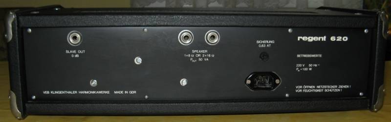

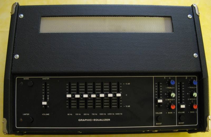

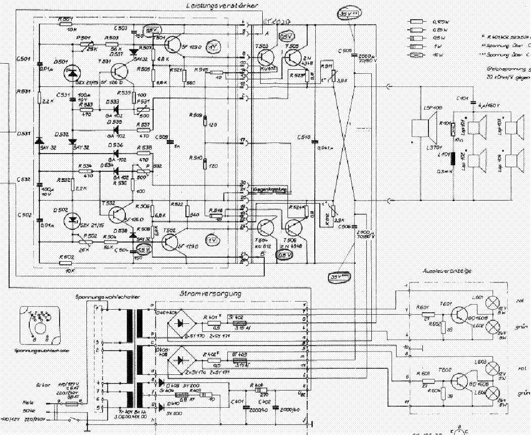

Thank you for this advice. additional I have find an additional solid state vintage amp with circlotron topology:
Vermona Regent 620
http://elektrotanya.com/PREVIEWS/63463243/23432455/regent/regent_620-1020-pwr.pdf_1.png
