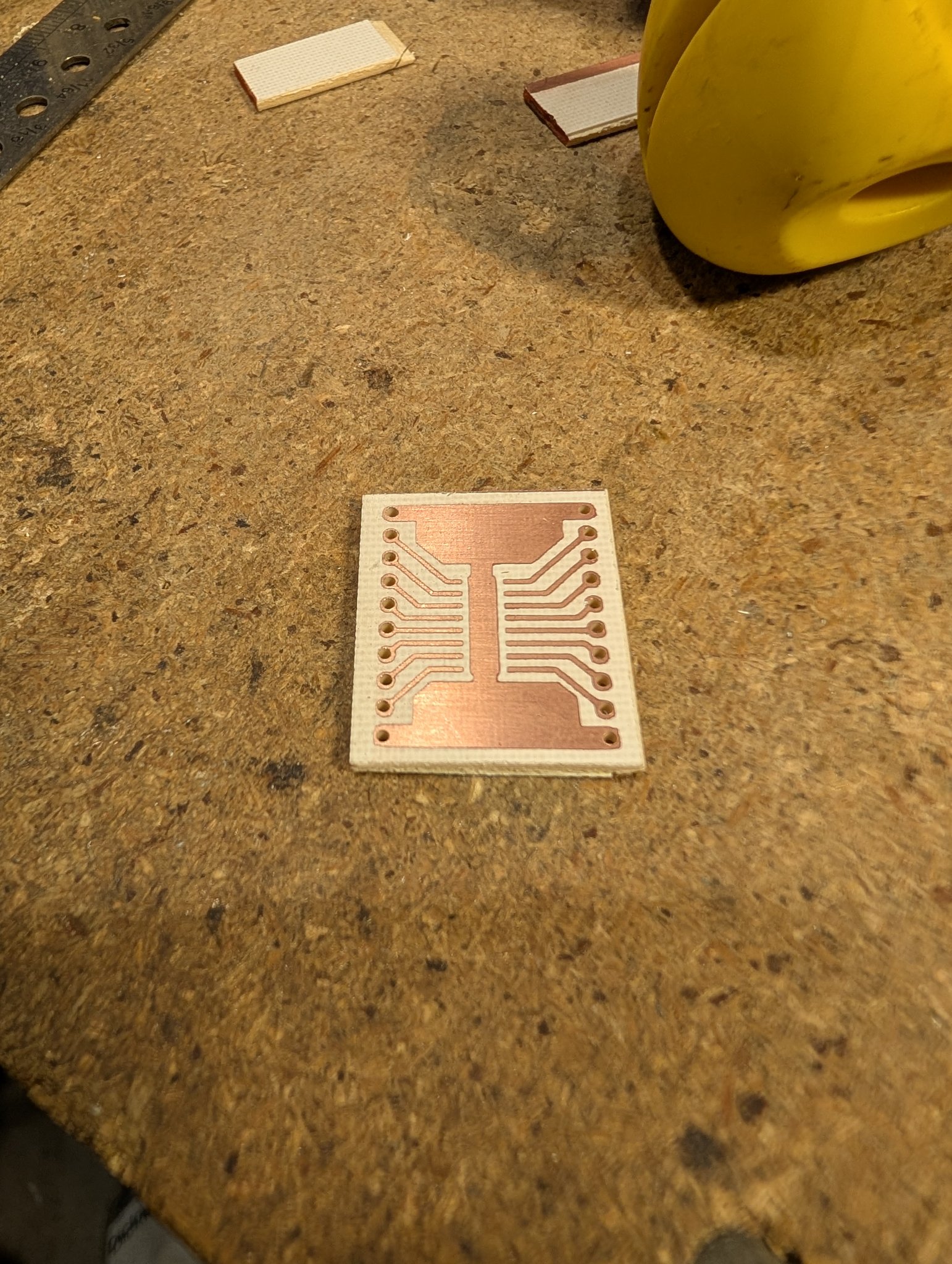

But I wanted to tinker with these chips in some of my hand-assmebled proto board projects. So I went on a search for ESOP-16 adapters. While some variations exist, I could not find any that included the bottom pad (pin 17 / ground). This is not only important for ground, but also is used somewhat for heat dissipation. So I did my best and attempted to design an adapter in KiCad myself. I am sure it is far from perfect, but it is what I am going to use for my proto board testing.
All files are attached here to the thread.

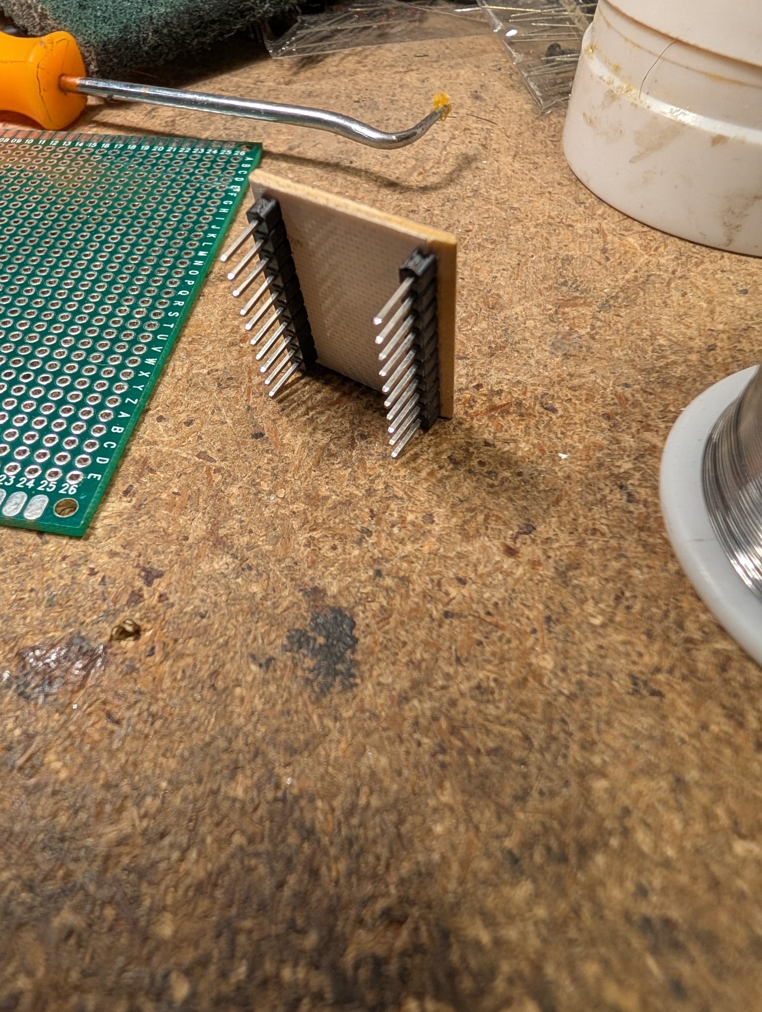

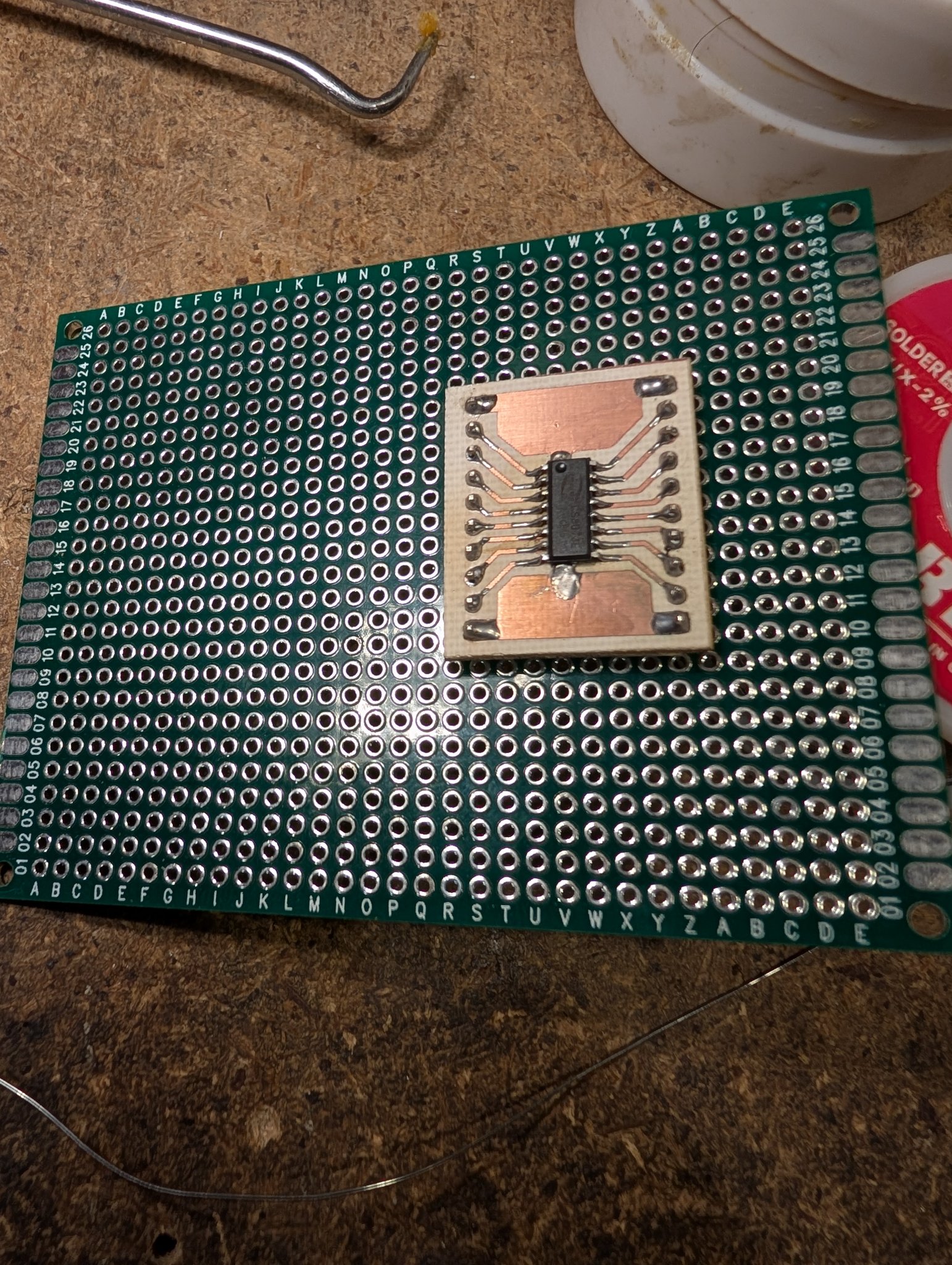

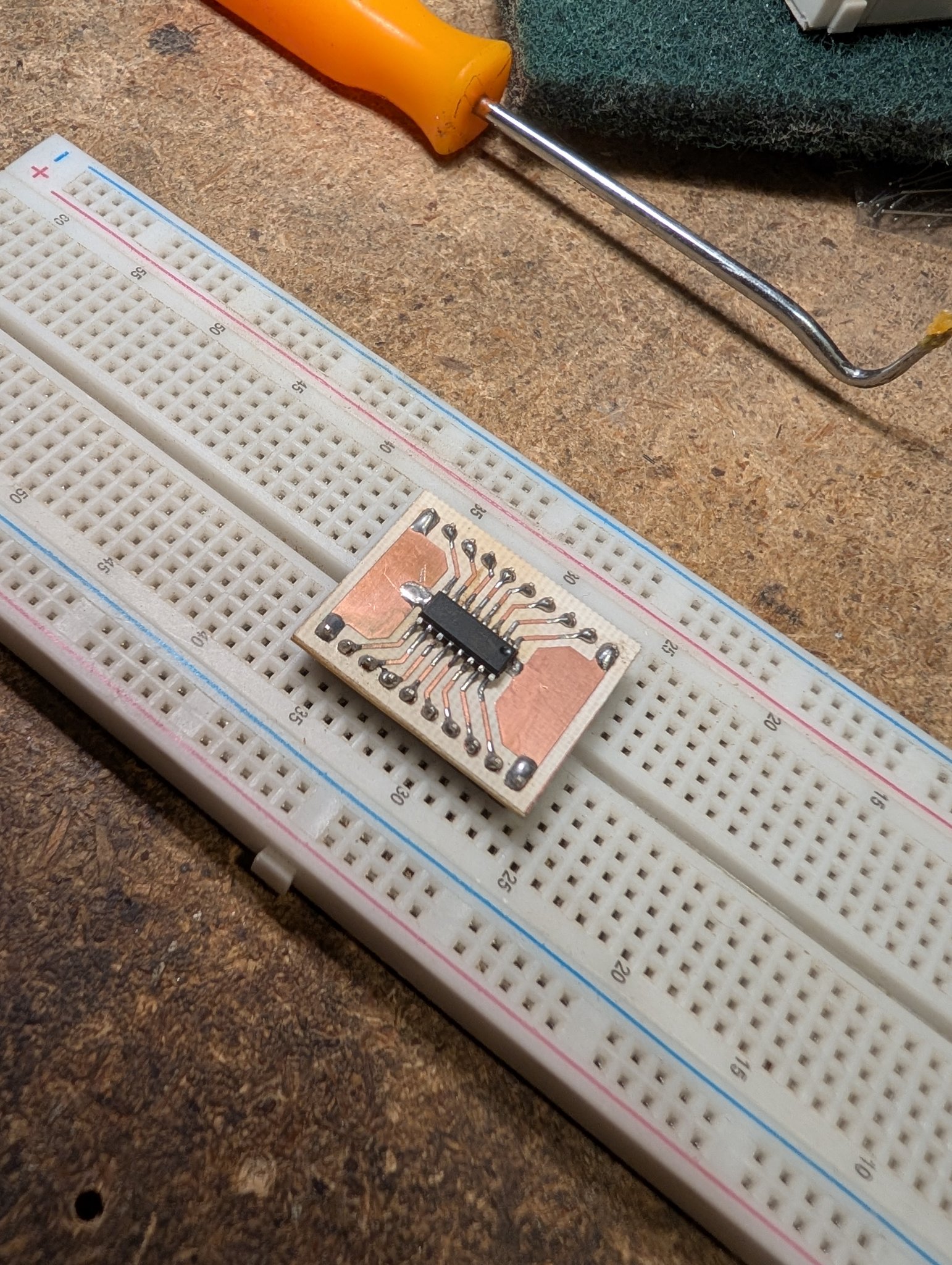

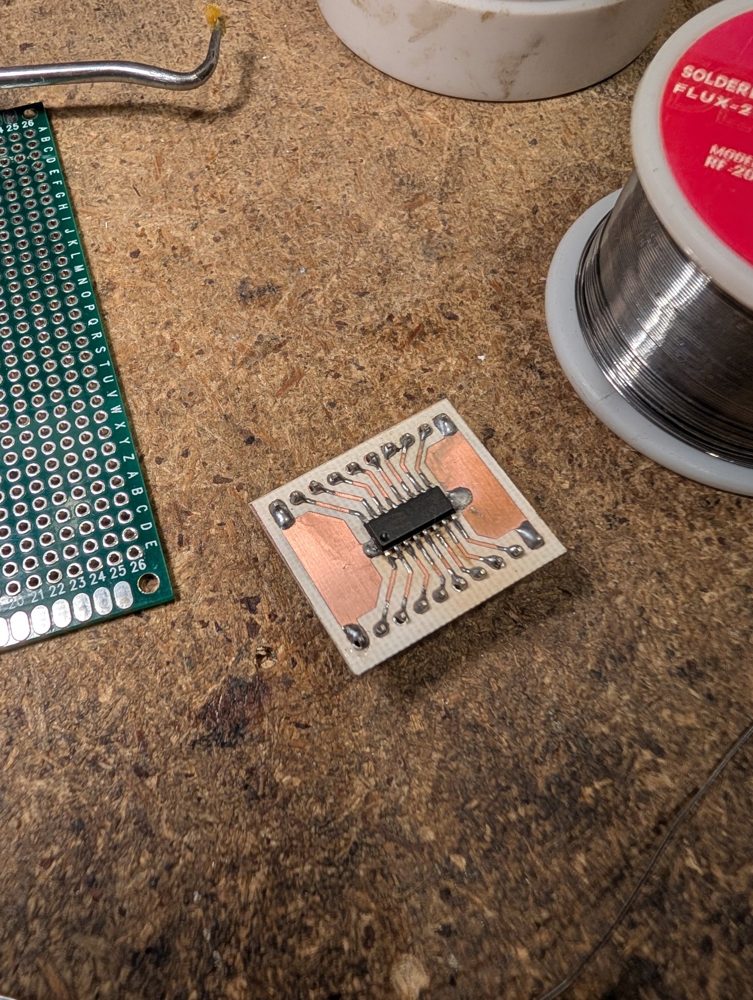

The ESOP16_DIP_Adapter zip file includes the custom symbol for this chip as well as the footprint. I have printed off tests as well as just etched a board and it lines up perfectly with the chip. The point of this adapter is to basically turn this chip into a traditional through-hole component that will solder down into any normal proto board or breadboard. But feel free to use the symbol and/or footprint for whatever other custom project you may have.

Also attached to this thread is an SVG of the adapter pcb directly. This is for those who want a no-bs way to JustMakeTheDamnCircuit(tm) without having to install or mess with KiCad, etc. The SVG prints a perfect dimensionally-acurate image on any decent laser printer which can then be used for transfer in order to etch. Likewise, the SVG also opens directly in lightburn and can be inverted to do the "paint the pcb, burn it, etch it, remove paint" method (as I do).
