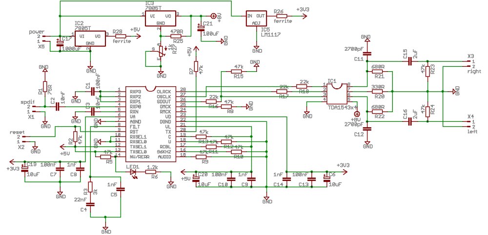

Cs8416 & Tda1543
I follow the post #6 and after read the datasheet, I've designed and made this dac.
But obviously don't work!
Probably I made a mistake, when push play in the cdplayer the led on this schema turn off but no music.
