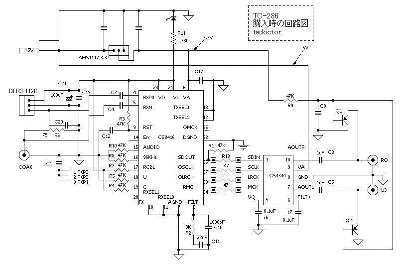

I ordered an inexpensive CS8416 + CS4344 DAC on Aliexpress recently; I have not received it.
I believe the attached is the correct schematic. I do not understand how the coax input is wired to RXn and the optical to RXp0. There is nothing I can see in the CS8416 datasheet that explains this. I believe the schematic is correct, since if it is just using RXp0 and RXp1 it would take multiple complex errors in schematic drawing for that to be the case.
I believe it is more likely a very deliberate design so that the 2 inputs will NOT behave like the built-in multiplexing.
Any help? TIA

You can only use one input at a time (Only one connection at a time) - it presumes that the optical input is well behaved with a "Dark" input.
