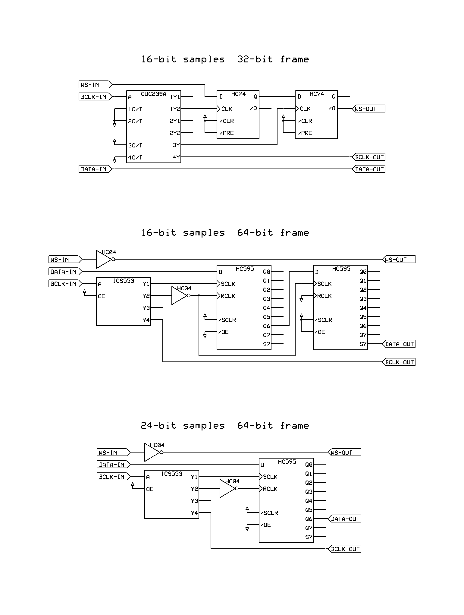

Its pretty straightforward to see why that circuit can't work - the original premise is incorrect. He says 'invert WS and delay the data by 7 clocks'. Well the first bit's right but the second is obviously wrong - within a 32 bit field, the difference between left justified (I2S) and right justified (EIAJ) will be 16 bit times. Subtract one for I2S's 1 bit advanced WS and you need 15 bit time adjustment. Add on another 8bit register to accomplish that and it might just fly.
Universal shifter
You lost me ... are you saying a 3-chip design might work?
The one in your Blog uses more than that as does the WORKING -- but messy -- "Universal Shifter" ckt I'm using:
(note that only DATA line is shifted, seven times. BCK and WS are fed to DACs BCK and WS pins unchanged).
The circuit on my blog isn't intended to do I2S to EIAJ - it just happens that such a conversion becomes almost trivial when the frame size is 16bits. Reduction of the frame size to 16bits is the purpose of my circuit.
Yes I reckon a 3 chip solution has to be worth a shot. Doing it with ALS374 latches though is messy because of having to wire so many ins to outs. Why not just use shift regs? I use HC595s because they're dirt-cheap here but they have another internal register which makes the circuit a little more difficult to design. 74HC164s would be a better choice.
{Actually, in the schematic posted the data is shifted 48 bit-times.}

There is no reason the I2S to EIAJ conversion cannot be done with as few as three CMOS chips while adding no additional loads to BCLK, preserving the timing relationship between BCLK and DATA (something the diyaudio experts don’t do) and not polluting the rising edge of BCLK.
Exam is open-book ... but show your work--you won't be graded on a curve!
There is no reason the I2S to EIAJ conversion cannot be done with as few as three CMOS chips ....
So ... where's YOUR schematic ;)
Your Universal Shifter is more like a Universal Noise and Jitter Generator. Don’t feel bad. All the diyaudio experts do the same thing.
I don't feel bad and the Universal Shifter is not my design. As far as noise in I2S<-->EIAJ conversion ... I speculated on this very issue some time back in the original EIAJ-I2S- and Vice Versa thread.
You might not get one - this from Tam Lin's comments on my blog :

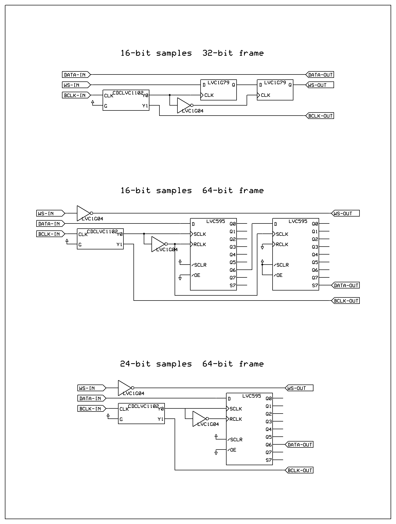

I've built that three-74HC174 converter and have stereo signal (i.e., music, audio, whatever) -- on the L/R OUT of the DAC chip -- but very distorted: sounds like pink noise+normal signal.
Also, when there is NO signal on DATA line (CD player is in STOP or PAUSE mode), there us a faint buzz/whine audible. If I keep DATA connected BUT disconnect WS and/or BCK to DAC, buzz/whine disappears (as does signal, of course).
I've seen (heard) this before, on other projects, and it was usually due to a poor ground (somewhere in the ckt). But ground SEEMS to be fine and the signal looks clean on the scope. (Also PS noise is quite clean) Wonder if it's a sync issue??? What does "poor" sync USUALLY sound like? That is, if the BCK and DATA don't precisely match on leading edge, whatever? Or if DATA is not properly justified? MSB not first ....etc., etc.
