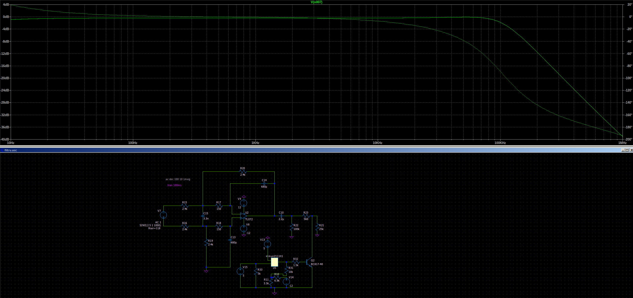

I don't have the TL072 model you do, the message only said the symbol was missing not the whole model. Sorry.
The problem is still that that the source as you have defined it has a DC offset between its two terminals, not an offset with respect to ground. The opamp may not work with a floating source with a 2.5v DC difference between the the opamp inverting and noninverting inputs, which is roughly what you told the source to do.

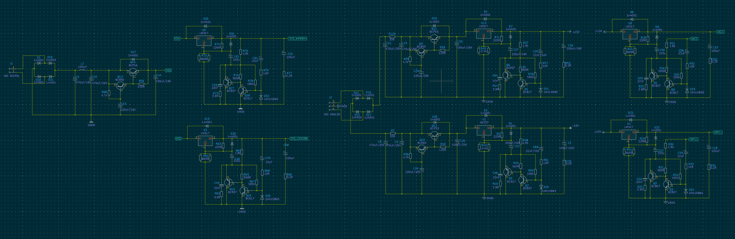

New idea.
DACs: AK4490(3), CS4398, ES9038Q2M and etc diff output DACs.

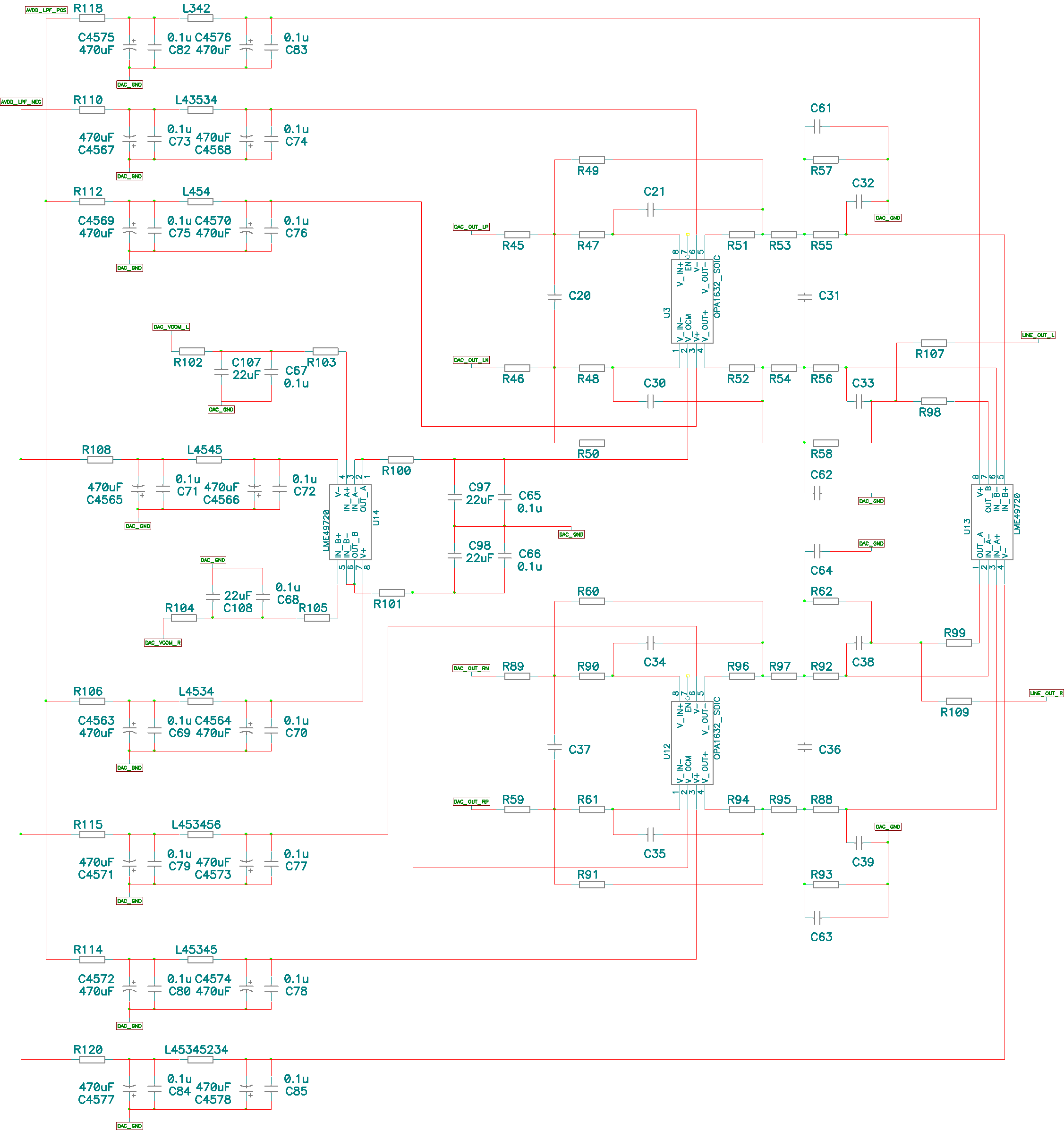

I used this version in my WM8804/CS4398 DAC and sounds great. For opamp I used OPA827. 2.2uF seems to work fine, but depends on the input impedance of your next stage.
Didn't yet test the muting circuit, I didn't populate it.

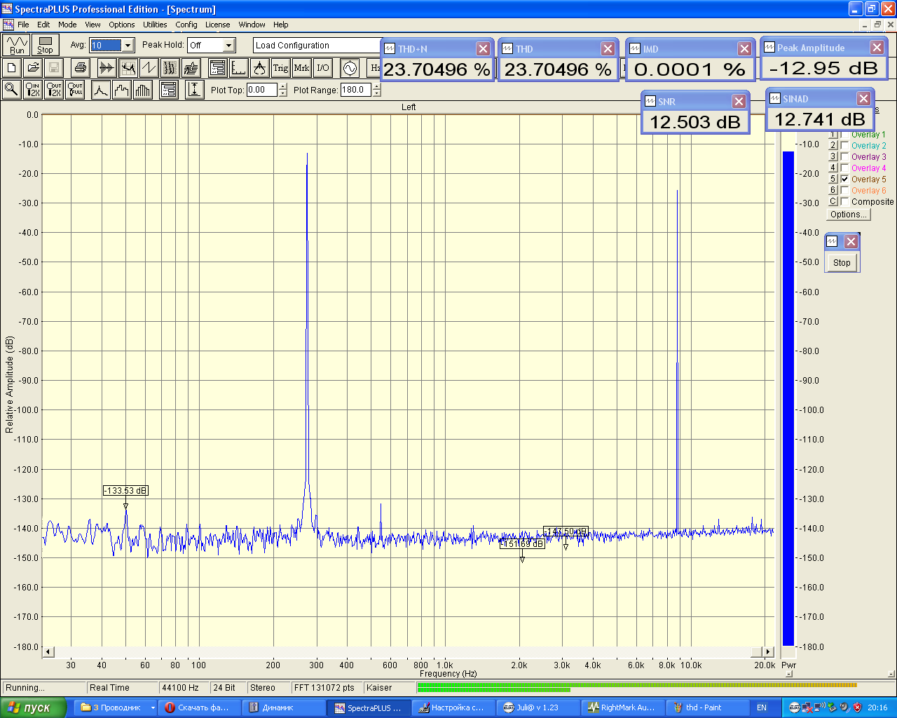

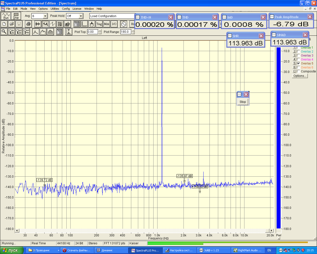

according to a similar scheme, I did a DAC a couple of years ago. very goog result

What did you use for the power supplies?
On my PCM1794 board I used the LM317 & BC337-40 denoiser. (One for the digital supply and one for the analog supply.) The IV stage is powered by LM317/LM337/LF353 low noise supply.

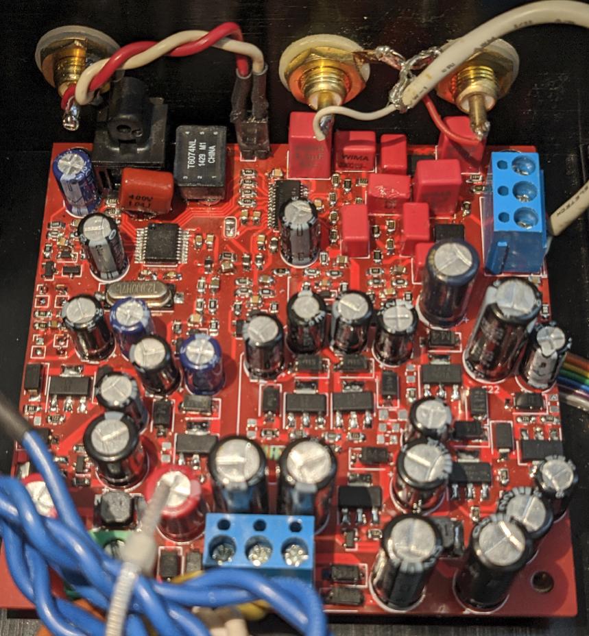

I used LM3x7N (SOT223) + dienoiser with BC8x7 for everything. Two 3.3V ones for digital (WM8804/CS4398), one for 5VACC, one for 3.3VAPLL, and two +-12V for opamps. CLC for digital and CRC for analog.
Might be overkill, but everything fits on a dual layer 83x86mm board. It was a straight swap for the older AK4396 pcb that I had. One of those ebay kits.
