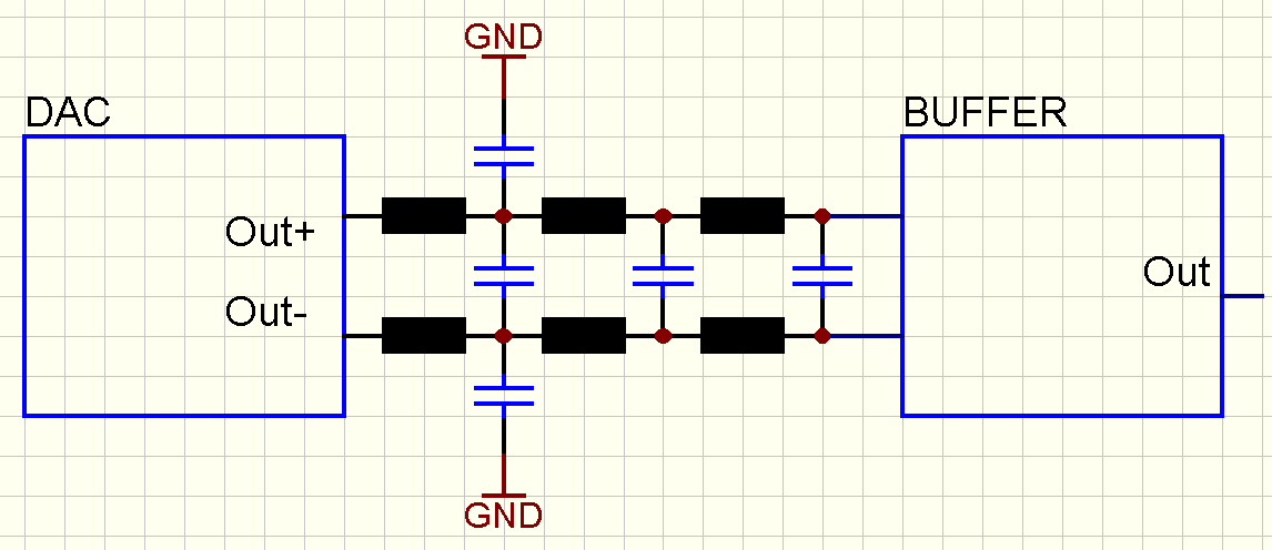

O.K.
but I'm think about such thing
Well, as others have mentioned, the DAC-chip is NOT intended for driving "heavy"/capacitve loads like a cable or the input on your amp. Therefor you need a buffer.
But more important:
The CS4398 (Like almost any other newer DAC-chips), is a differential DAC. This means that the output signal is NOT represented between Gnd and the output. It is represented between Vout+ and Vout-.
There will be some common mode signal on these, and if you only use one of them in reference to Gnd, you will NOT get the real signal out of it, even though it will play music. You just totally ruin the performance. Just like thoose people listening to old TDA1543 without buffers, believing that the "different" sound they hear is better...
That's why you should always use a differential to single ended buffer. Using an op-amp however... That's just not the best way, in spite of very nice specifications.
But more important:
That's why you should always use a differential to single ended buffer. Using an op-amp however... That's just not the best way, even though it has very nice specifications.
Finally I got some time to buy the components and build it. Although local shop don't have the exact value of resistor, I just use the close approximate value plus all the low capacitance value only availabe in ceramics 😱 Despite that now I got what you mean Hurtig, it sounded much fuller now, and some detail has been brought up
