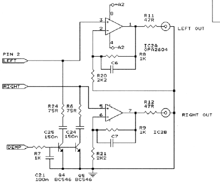

Looking in a little detail at the datasheet for the CS4328 DAC in my Creek CD42, it has a built in Mosfet output stage which will (when combined with a simple cap/resistor filter) drive a set of interconnects directly, with no need for further amplification or filtration. How good is this stage, using it directly will allow me to bypass the OPA2604 chips, which can then be removed, reducing the load on the PSU (which is another good thing).
On the other hand, I imagine Creek knew what they were doing when they put them in there, so does anyone have any experience of using this chip with no external output stage?

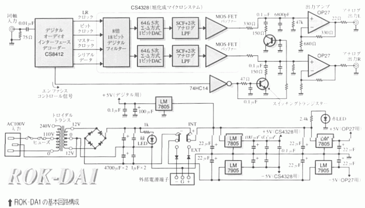

If you read the datasheet (I have it) you see that this chip has a built-in filter and as external filter is only a R+C needed. Download my schematics from my homepage if you want to see how it can be done.
Those of you who wants the datasheet (which isn't availabe from Cirrus), send me a private message.
This mosfet thing is a some sort of "sound enhancer".
You can infact use the signals directly from the dac only via this really simple filter.

Thanks for the quick reply! I have read the datasheet and it is because of this that I am puzzled that Creek chose to use an OPA2604 between the DAC and the outputs, as this should not be necessary. Ideally I can remove this and gain some sound quality, but I want to confirm this (if possible) before I get to work with pliers and soldering iron.

You can remove everthing except for the single filter .... but beware of this chip is no longer available, be carefull when you connect
Oh, I forgot, the opamp is probably the deemphasis thing which is to 99.9% unnecessary. The CS4328 has not built-in deemphasis filter.

I guess that having the opamps prevent loading of
the mosfet gain stage at the dac chip output. I have used
AD827 loaded with 5k ohm and they do not like that.
The bass lines sound very muffled, like hitting a pillow
instead of a kick drum.
They prefer at least 10k or higher. It seems that even though
the output stages can drive lower impedances, those low
impedances are not neccessarily the optimal impedance
when dynamics are called for.
