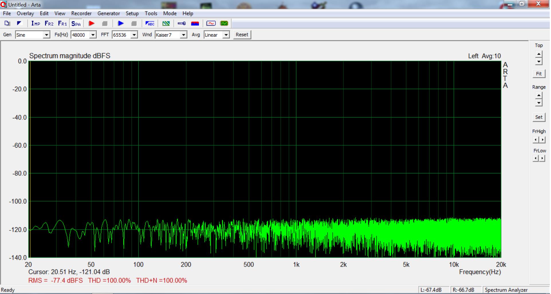

With "stand alone" pin-out in mind, I pulled I2S/LJ pin#13 to VL (3,3V) with a 10k resistor and attached M1, M0 pins#11,12 to ground for starters. But I messed the data lines... I had to go out for a while. I'm going to fix that now.

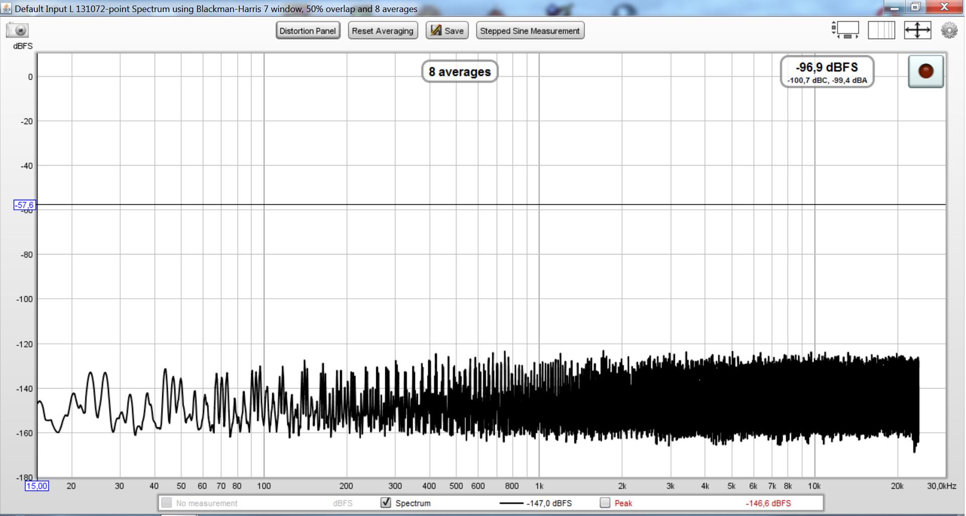

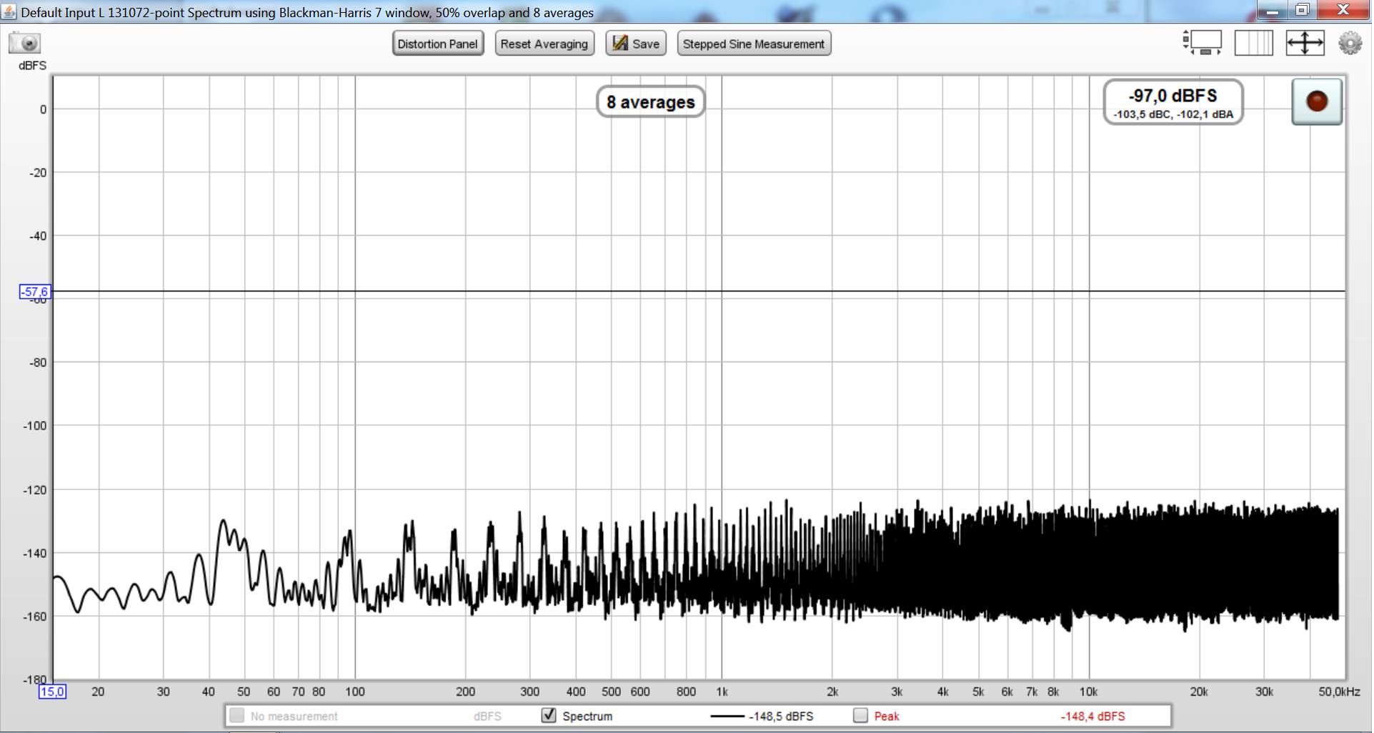

So, I've been playing with this. With ARTA, it needs to configure M0, M1 accordingly to each sampling rate or it won't work. Then it will do what's shown in the previous post. With REW -java drivers- it's a different story. With M0,M1 both set to 1 it will do all sampling rates from 44.1 to 96kHz. I also keeps the noise floor down where I would expect to see it from a 24bit chip. Leaving M0,M1 fixed is very handy but is it the correct thing to do? What would be your choice?
