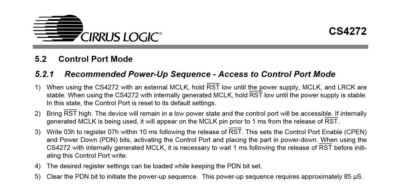

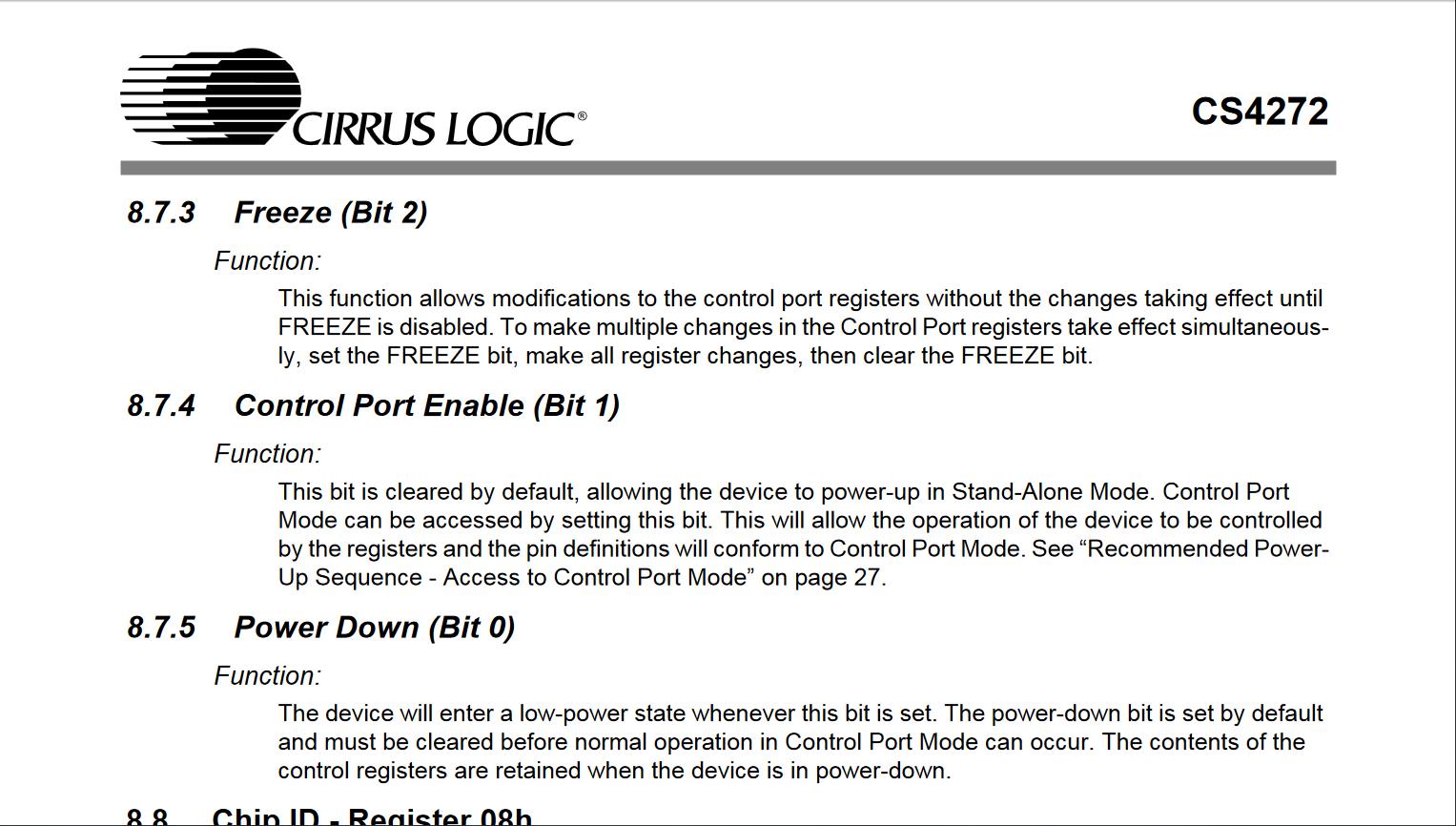

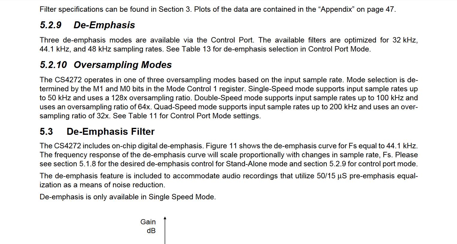

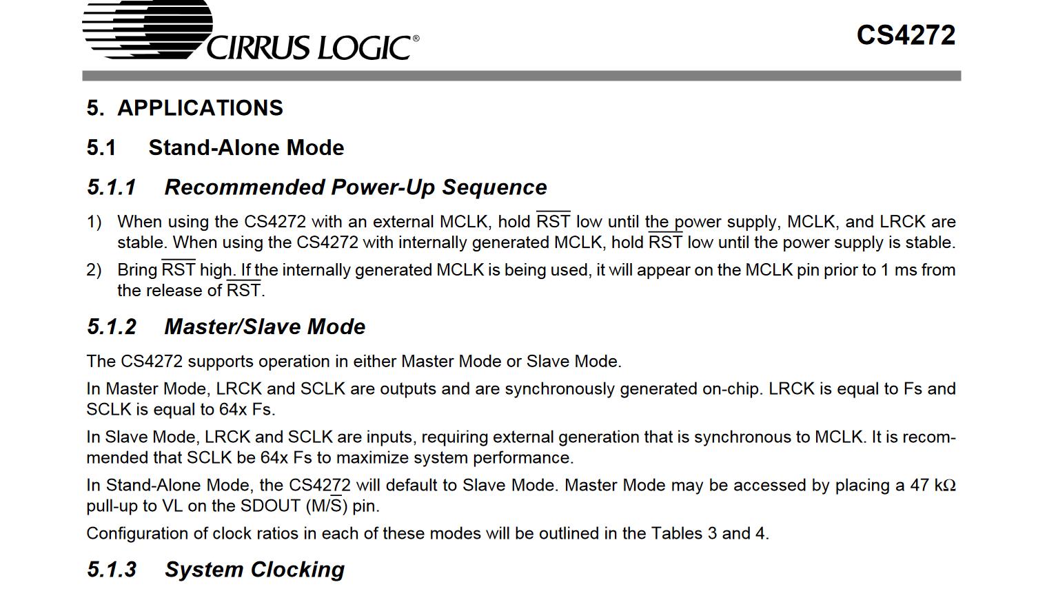

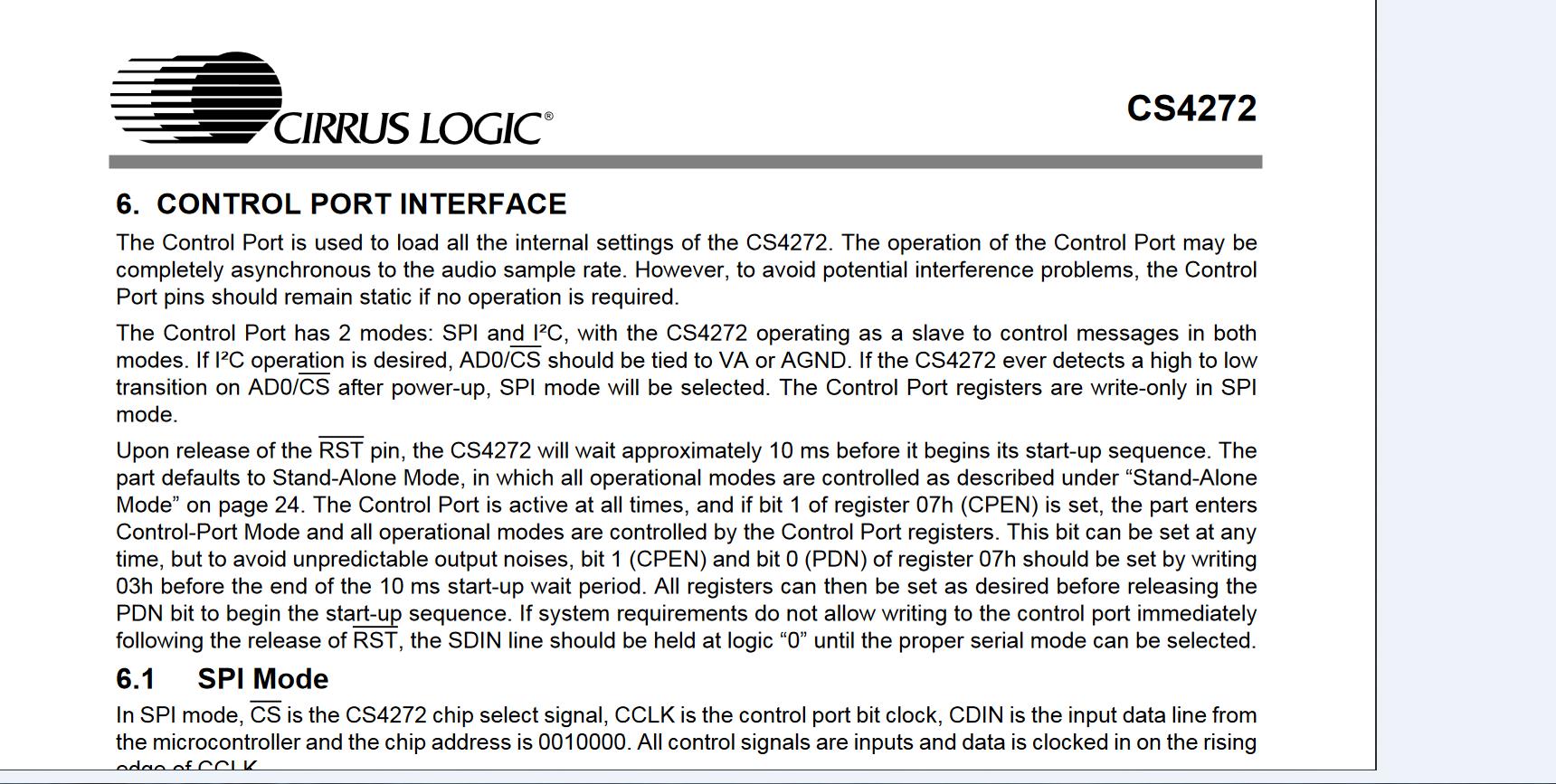

Attached a few extracts from the datasheet possibly related with my problem. In the last one : "The power down bit is set by default and must be cleared before normal operation in Control Port Mode can occur."

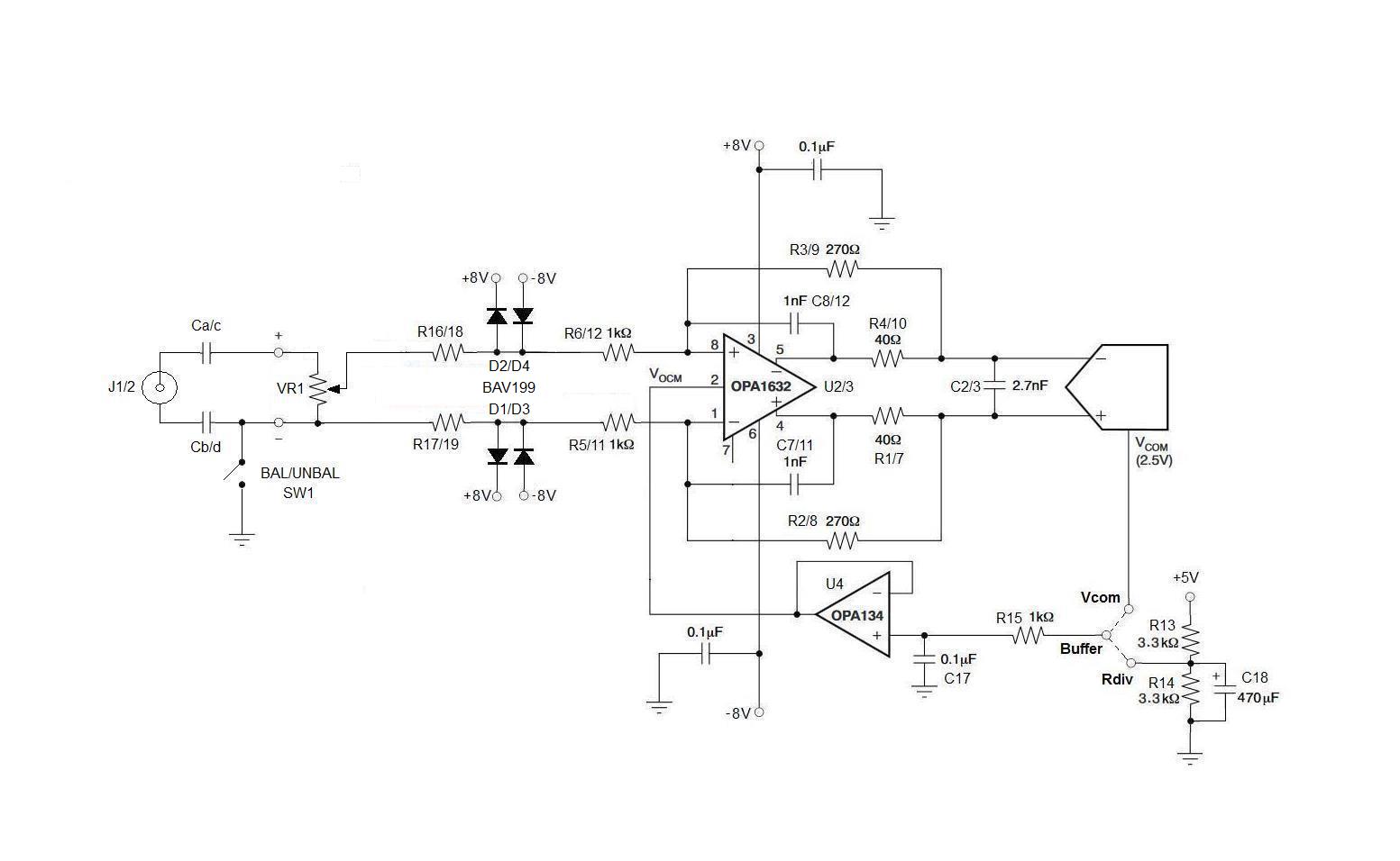

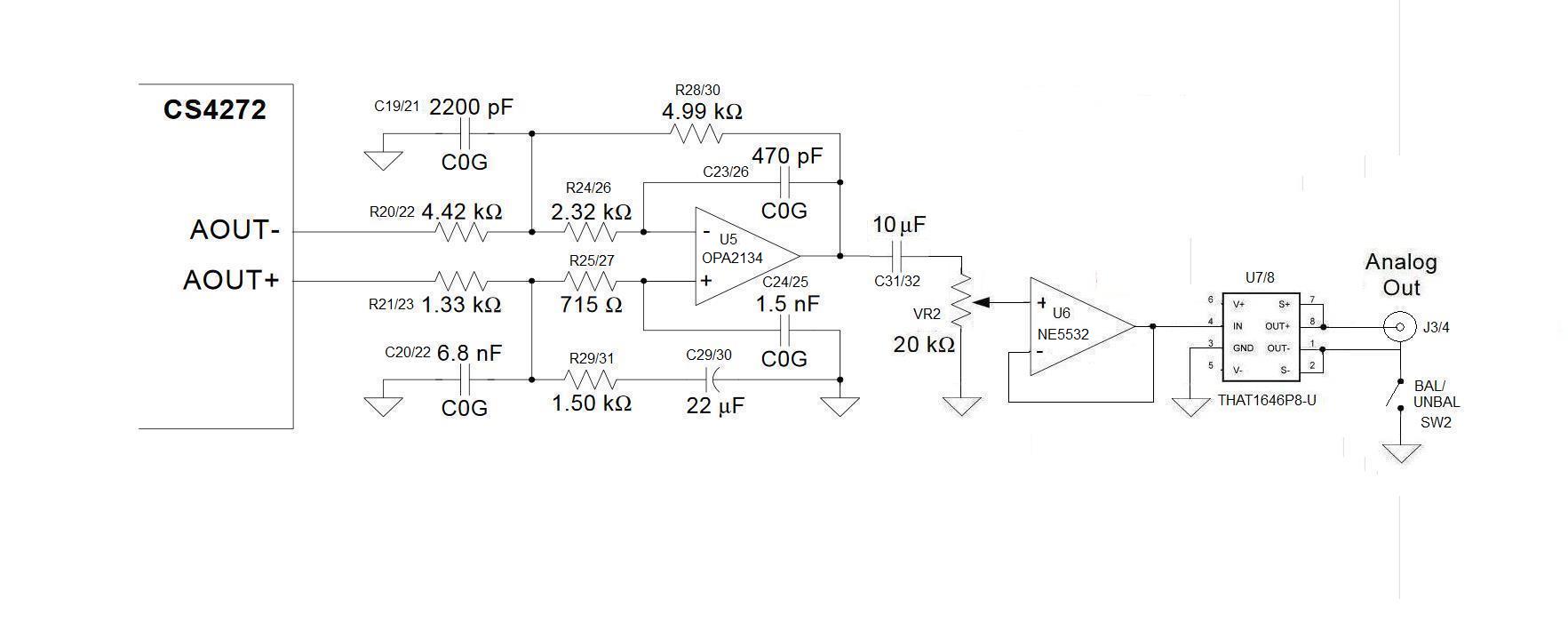

Thanks for reply! The dac board is my design according to the schematic of post #1. Essentially application notes implementation. I can provide a screenshot of the pcb design if needed. I want to make it work in full duplex -adc/dac. Basically, I understand that I2S is the main communication signal. I2C is supposed to do some other things. I surely can't tell what this should be and definitely I'm clueless about read/write code. I'm just using the usb module drivers. It would be nice if I2C could be omitted in my application but then how should I configure the hardware?

Do you have an actual complete schematic, not just a simplified diagram? Where are the voltage regulators and what kind, etc.?
Also, it would probably be helpful to see the PCB layout.

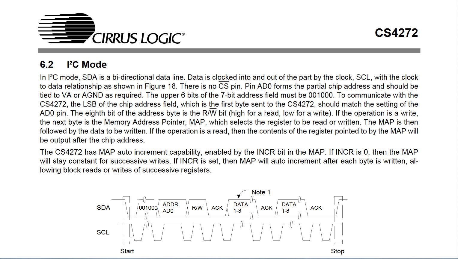

Regarding I2C, its how you connect to the dac chip to control its register settings. That's important. Pretty easy to do with an Arduino or other MCU of your choice.

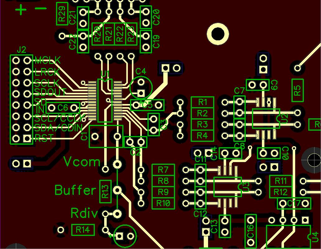

Here is the psb layout. The board also holds input and output analog stages and those work fine. The voltage regulators -LT3042- are on another board also working.

Okay, thank you for posting those. Makes it much more clear.
How about we talk about I2C a bit? I have some Arduino code I can share that can read and write dac registers over I2C. I use it for random test changes to registers and also for preloading all the registers at once after power on. I haven't studied the data sheet for the dac chip you are using yet, but I'm sure I could explain what you would need to do. Its actually not hard and its something all diy dac builders should know how to do these days. Does that interest you?

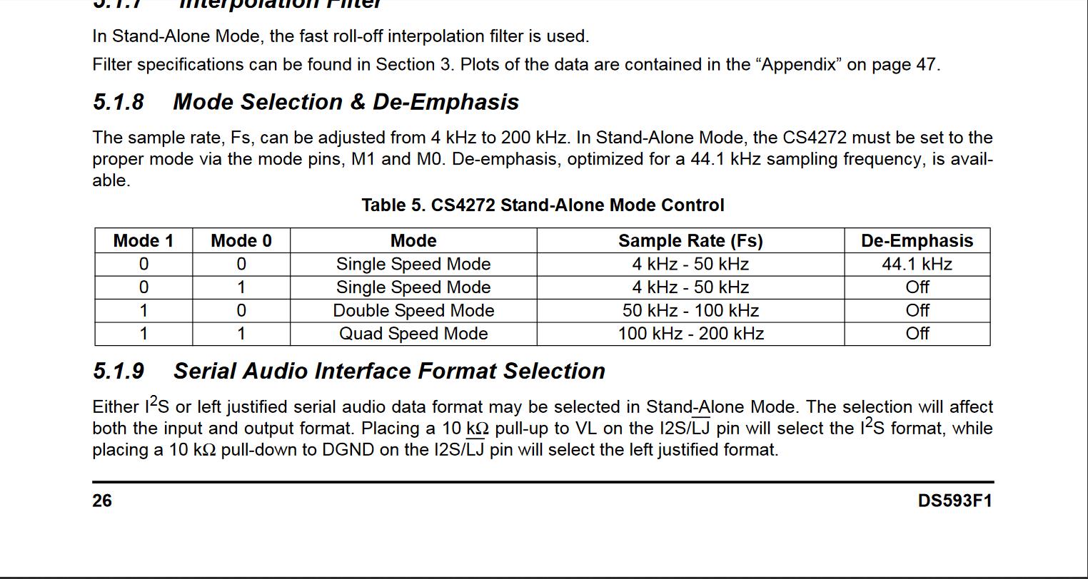

But if we could stay a little on the "stand-alone" please... According to datasheet, pin "ADO/CS" changes to "I2S/LJ" to select Serial Audio Interface with a pull up or pull down resistor -understood- and then SCL becomes M0 and SDA M1. The only info I can find about these is on page #26 - see extract attached. And then there is something about oversampling on page #31. Is it that I can set M0 and M1 for max speed so I could get all sampling rates from 44.1 to 192kHz at the lowest oversampling mode or do I have to adjust manually for the sampling rate each time?

I just took a quick look at the data sheet. Looks like its is the power up sequence that determines stand alone mode verses software control mode.
Basically, if you want stand alone mode then you follow the power up sequence for it. In that case the pins function as shown on pages 7 and 8 of the data sheet. The remainder of the stand alone section of the data sheet describes how to use the pins to control what you can control that way.
For example, to play higher sample rates the there some pins that encode the sample rate for the dac to operate at. Those pins would have to get mapped to the F0-F3 pins of a USB board. In that case you need to know how the F0-F3 pins for your USB board work to know if any interface glue logic would be needed.
On the other hand, to operate in software control mode power up sequencing is critical to entry into software mode.

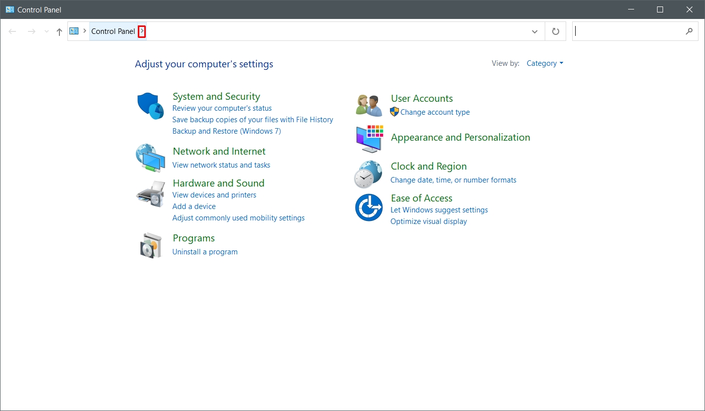

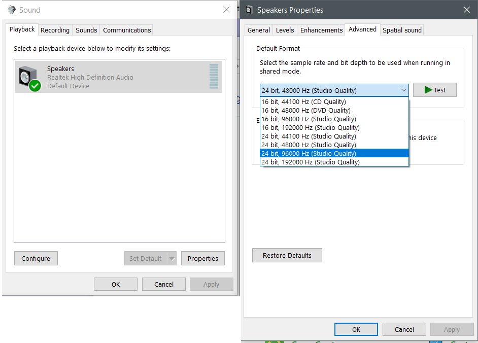

There is something you can check. If you are using Windows as the USB host for your USB board, you should check the sound settings in Windows Control panel. Please see the screenshot pic below. If you select the diyinhk sound device, then click on the properties button, it will open the properties window. Click on the advanced tab and see what the default sample rate is set to. If not set at 16/44, try changing it to that. Then hit Apply, then try sending audio to the USB board again.
If you don't know how to get to the sound settings, take a look at the 2nd screenshot below. Type Control Panel in the search box on the task bar, select Windows control panel, then click on the right arrow button outlined in red in the pic. That should cause other options to appear at which point click on All Control Panel Items.

- Digital Line Level
- CS4272 stuck in power down mode
